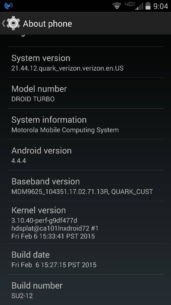

Sorry that you are having issues with your droid turbo's. My wife and I do not have any of these issue's with our turbo's. Wish I could help, but we probably got the same update that you got. Maybe the issue's you're experiencing is something else.
