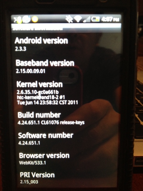

Here is the info from my Software Information on EVO (I think I also attached a picture):
Android 2.3.3
Baseband Ver. 2.15.00.09.01
Kernel Ver 2.6.35.10-gc0a661b/htc kernel@and18-2 #1
Build # 4.24.651.1 CL61076 release-keys
Software # 4.24.651.1
Browser Ver. WebKit/533.1
PRI Ver 2.15_003
PRL Ver. 60680
This is exactly what is on that page, I have no idea if what you ask is there. Is there an app I can use to get this info otherwise?

Anyhoo, it appears you are rooted but just on a stock rom. (which is fine)

Root is the same exact thing as getting admin access on a pc.
Recovery is your number one admin tool.
When we install something using recovery, we use the slang term, flash. Here's a flash image, I flashed it, etc etc - substitute install for flash, that's the whole deal. ;)
Hi, so I just got off phone with Boost tech, they told me that they would have to reset the phone, and since the phone isn't on their network as one of their phones, it will likely wipe everything and not even work. They said that the phone I have shows it's a Sanyo (like others told me) which is faking the system. Does this make sense?
