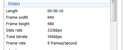

I have the lights off with the Tv paused. This is what 9 frames per second looks like buddy. So When you made that video you had the lights off like me with only some parts of the tv screen to light you up. Shoot i even dirty the lens just to get it that low. Come on guy you were caught. Be honest 9 frames per second?????? You must have a lemon then.
I'm not seeing where you proved a point.
Less than optimal lighting and the camera sensor trying to compensate with metering adjustments is enough to kill frame rates.

Evo videos tickle along 30fps in the best conditions (and lower resolutions) while the iPhone4 video is rock solid 30 at full 720p. Why the framerate differential?

Something's very wrong with that low fps result, if I read that correctly earlier.
PS - OK, posts said that that was for low light. Not sure how low. I'm shooting indoors, daytime, getting a steady 28 fps or better - at VGA.
Just shot the same thing in 720p - got an abysmal 9.77 fps.

Doh. This is a no brainer. I just noticed from your latest test that the iPhone does everything in H.264 (AVC, MPEG4 Part 10) vs. the Evo's MPEG4 Part 2 (ASP, note compatibility to H.263).
Nothing more to decide or test. H.264 is simply a superior codec.
