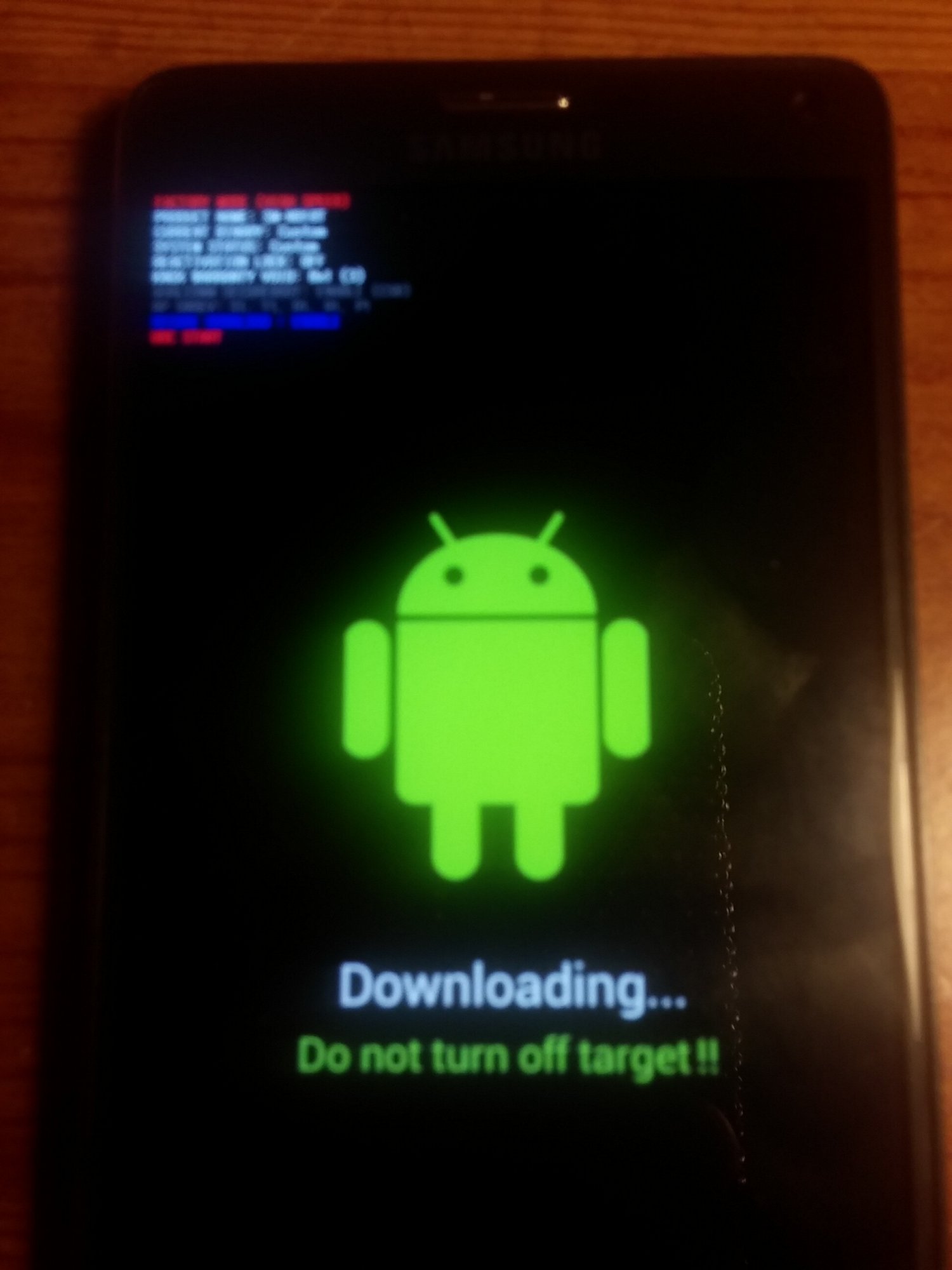

Somebody help me...absolutely nothing works... how do I fix this???
STARTED BY DOING AN INNOCENT FACTORY RESET.. THEN IT STARTED FLASHING "INSTALLING SYSTEM UPDATES"... SO I WAS RECOMMENDED USING A " USB JIG".... IT TAKES IT OUT OF THE LOOP, BUT PUTS IT INTO "FACTORY MODE"

Did you pull the battery prior to using the jig?
Have you checked that your power button hasn't gotten stuck, and that the usb port and connectors still look proper (no bent pins - I need a magnifying glass)?
Were you rooted, as that's required for the usb jig to work?

FACTORY MODE (HIGH SPEED)
PRODUCT NAME: SM-N910T
CURRENT BINARY: CUSTOM
REACTIVATION LOCK: OFF
KNOX WARRANTY VOID: 0×1 (3)
QUALCOMM SECUREBOOT: ENABLE (CSB)
RP SWREV: S1, T1, R1, A1, P1
SECURE DOWNLOAD : ENABLE
UDC START
(ALL OF THIS POPS UP WHILE THE ANDROID ICON IS UP SAYING "DOWNLOADING" DO NOT TURN OFF TARGET)
If you've got this far,you should be able to ODIN back to the stock ROM.
Check the T-Mobile Note4 section @XDA,there's a couple of step-by-step threads to get you up & running.
BTW,you're not gonna be able to reset the KNOX WARRANTY VOID,that's a one-way ticket.e-fuse if you will.
Once you've rooted,there's no resetting the KNOX tripper.................
However,the phone will work in every other aspect,including taking updates via KIES (OTA's are not available to tampered devices).
BTW,you'll have to re-root your device when restoring stock,or taking stock updates.

OK,are you actually d/l the image/ROM/etc.... to your computer,or,in the process of flashing via ODIN?
Or,are you updating w/KIES?

THE CURRENT PROCESS IS WITH ODIN... THE LAST LINE READS....
<ID:0/005>aboot.mbn
BEEN STUCK HERE FOR NOW AN HOUR
Check this video out,see if you're omitting something (of course,make sure you're flashing the proper firmware):
I DID EVERYTHING EXACTLY.. AND NOW I ONLY HAVE AN INCH OF A DOWNLOAD BAR THT HAS NOT NOT MOVED IN A WHILE... DOES IT USUALLY TAKE A WHILE?
No,it doesn't usually take this long.
OK,what exactly did you have installed on your phone prior to all of this?
(ROM/Android version/custom kernels/etc....)
I'm not guaranteeing I can help in getting your phone fixed,but,it would help to know as much as possible.
Others here may have experienced what you're going through & offer a solution.
Since your phone is basically stuck at this point,I'd disconnect,pull the battery & try again,unless you're willing to wait for others to chime in.
I had my update fail once before success.
If you're gonna pull the plug/battery & try again & if you were on stock Samsung O/S,I'd give the KIES a shot,see if it will restore your phone.
KIES &/or SmartSwitch has that capability,you'll have to plug-in & see if it'll work.
Again,please keep us posted on your outcome.......
ALL I DID WAS ROOT MY PHONE... CUSTOM EVERYTHING..... AND ODIN ISN'T EVEN SAYING PASS OR FAIL... IT'S LIKE AS IF IT WAS FROZEN... NOTHING IS HAPPENING
