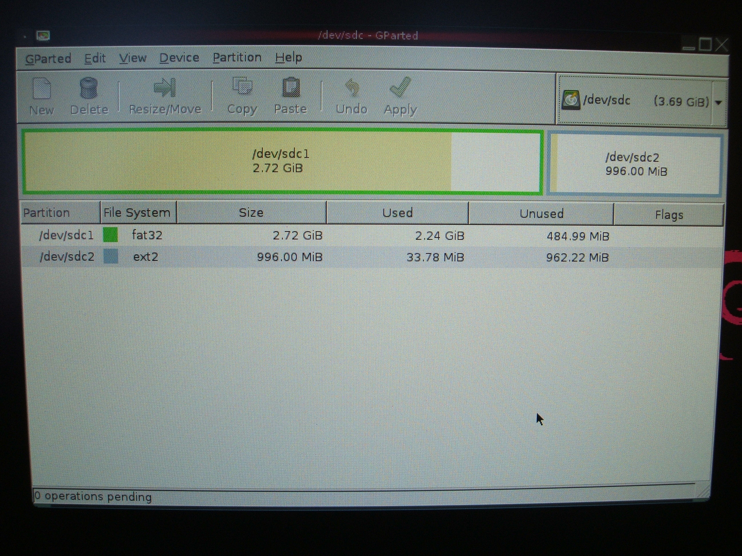

I'm still struggling to get the extended partition working correctly. I have set it up as in the picture I've attached - however when I use a2sd the apps seem to be being put on the fat32 partition instead of the extended. Have I set it up correctly? Thanks
For some reason the app won't let me view the image.
However something worries me about your statement. What do you mean "use a2sd" exactly? You don't "use" anything, its automatic. If your apps are going to fat32, you're putting them there yourself and you haven't understood this thread properly.
Please re read this thread
