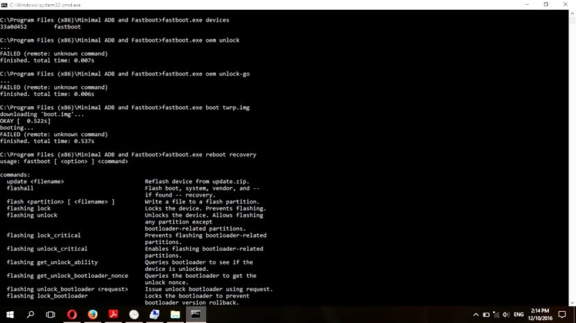

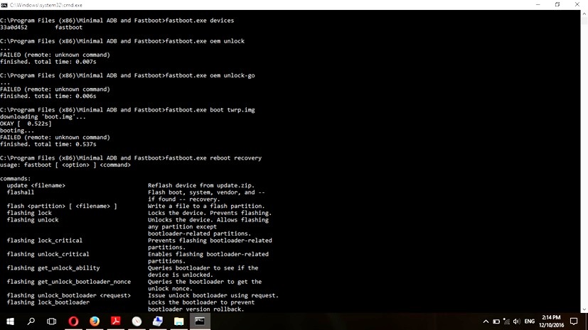

i am able to boot in fastboot, mobile detected as fastboot devices retured serial no . and also fastboot getvar-all returned, but rest command like boot, reboot,unlock all failed remote unknown command
@scary alien what additional information u need please tell i will try to proivide
i have attached schreenshot
Can't see your attachment as it's an MS/Word document...can you re-post as an image (.png, jpg, .gif, etc.), please?
That may not matter if it matches what you said above...many bootloaders are simply "locked" because the device-side that fastboot "talks to" simply will not implement or ignores things like the unlock commands, or disabling the key/button sequence to enter bootloader mode or flat-out disabling the USB driver when in bootloader mode. I.e., several ways to lock you out.

If fastboot otherwise works (i.e., fastboot devices and fastboot getvar all), then any error you get after that indicates a command sequences that's incorrect or not implemented.
There is one last/other thing to consider, on many devices--especially Nexus devices--there is a Settings -> Developer options -> OEM unlocking switch that must be enabled before you're allowed to unlock your bootloader. I'm not sure that's relevant in your case, but it certainly wouldn't hurt to check.

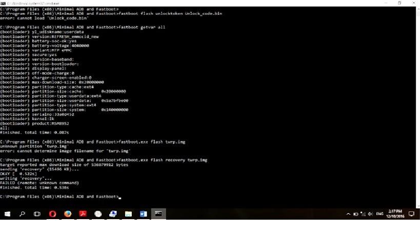

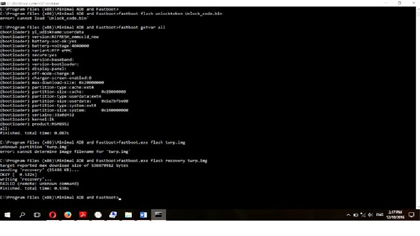

please find the attached file of response of my fastboot command if you need any thing else, then say i will try to get this

please check my file and reply , thx

yes my mobile coolpad note 5 has option oem unlocking option on developer setting , which i already enabled before trying above
It looks like your bootloader is locked (note the "secure:yes" line from the getvar all output) and/or the fact that the commands to unlock / flash / boot all report "FAILED (remote: unknown command)".
Some devices simply do not allow unlocking the bootloader--not sure what else to tell you or to have you try...
Sorry :(.

well ok one more question i have complied twrp for this , but stuck because cant flash it , ygdp tool flash .cpb of it. and i am unable to replace stock recovery with custom on it , because the version supported is directly flashing it without decompressing so can you help on it
ok i did it flashed recovery
hari pashad
look like we on same track on same train with same issue.
i have also one of the phone of cool pad and faced same problem while try to do same command <fastboot boot twrp.img> as seen in pic so at last how did u flashed recovery? and did these command working for u <fastboot boot twrp.img>??
