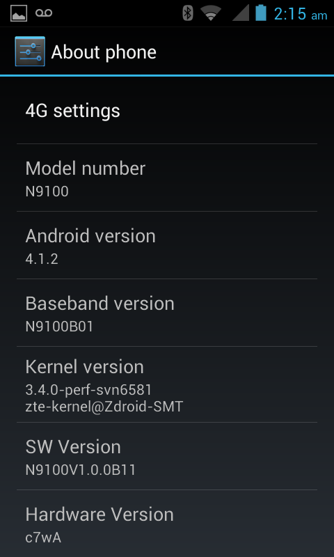

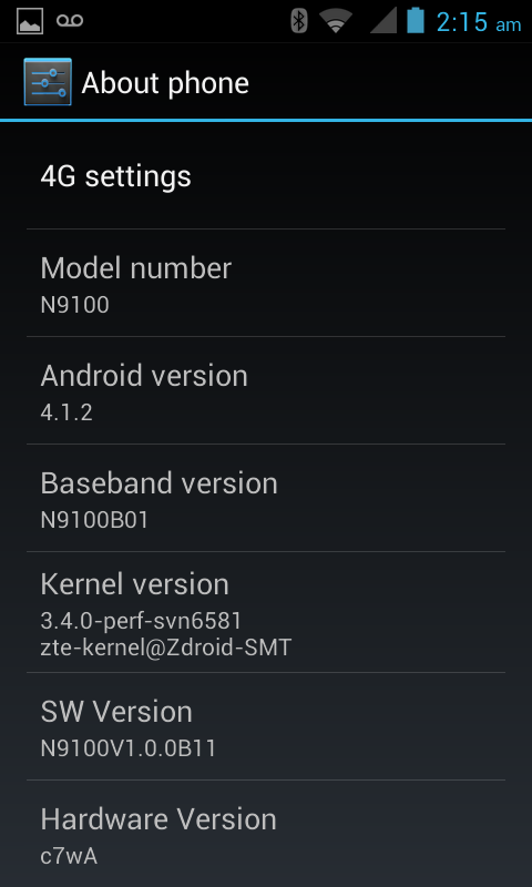

Well it has been a long time coming but we finally have a working Jelly Bean 4.1.2 ROM that can be flashed onto the ICS phones!
It started with Shinru2004 and his nandroid dump of a Sprint 4.1.2 Force 4g. SuperR took that nandroid and made a flashable debloated, rooted, de-odexed zip. Unfortunately neither of these would boot on a device which previously had ice cream sandwich installed.
I was able to get it to boot by modifying that ROM by replacing the updater-script, updater-binary, and zImage with ones from DSF .7. That was with the 3.0.8 kernel and some things did not work (wifi, bluetooth, camera). To be expected when using system image from 3.4 kernel with 3.0.8 kernel, but calling, text and data did work.
Shortly after, Downgraded286 posted that he had a textnow phone with 4.1.2. I asked him to use online nandroid backup to get a nandroid because I knew that this would include the modem.img and thought that might be the underlying issue.
I flashed that modem.img and the result was I couldn't get any ROM to boot except my modded JB rom with the old kernel and then there was no network connectivity at all and some other issues.
So I downloaded the ZTE Boost ROM that is up on ZTE's website and took a deep look at the updater-script and the image files that were included. There were many more than what you would normally see inside a custom rom, so I again asked Downgraded286 if he would be willing to use dd to copy all of the partitions that corresponded to the image files in that ZTE ROM, and here SuperR stepped up again with a script which would do just that.
Downgraded286 ran that script and uploaded the results and just now, tonight, I renamed those image files to match the files from the ZTE ROM, copied them into the SuperR debloat/deodex, made the corrseponding additions to the updater-script, zipaligned, signed, and built with rom kitchen...and BAM! It works!
I had just restored my phone to ICS with the ZTE rom so I had to reinstall CWM (which meant rooting, which cannot be done with 1 click root anymore on that rom, but towelroot worked, the newer zte boost rom also has swype included, but not the JB rom. Really different from the first boost rom I had). Anyway I got cwm installed, wipe factory reset, wiped dalvik, installed the zip and it booted! Everything works! Camera! Bluetooth! WIFI! Data! Everything!
Finally ZTE Force 4g users who had ICS can upgrade to JB! It's only 2 years late, but here it is!

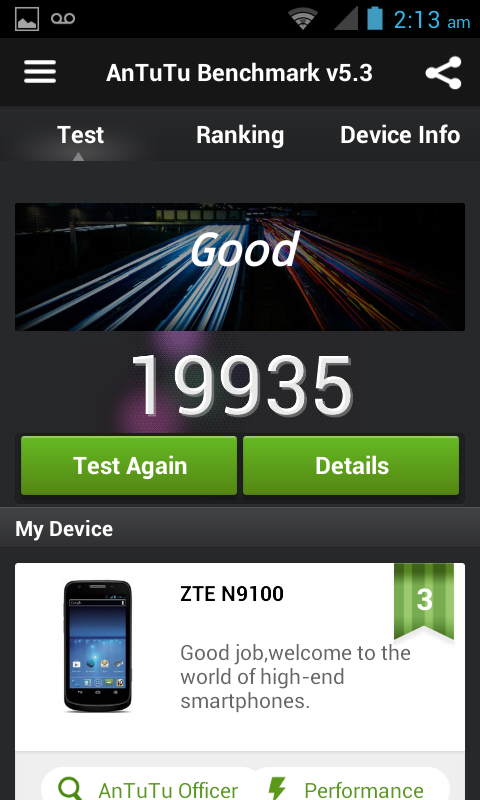

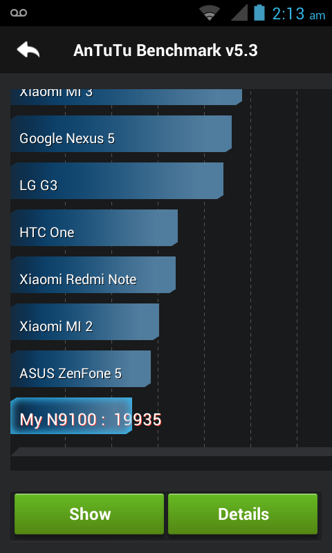

I thought it felt much more responsive! I ran antutu and got a score just under 20,000!!!! This way out performs ICS, even matrix kernel! First screenshots attached! This score is about 5000 points higher than I ever averaged with ICS, even using DSF and matrix kernel with overclock. This is a substantial performance improvement!

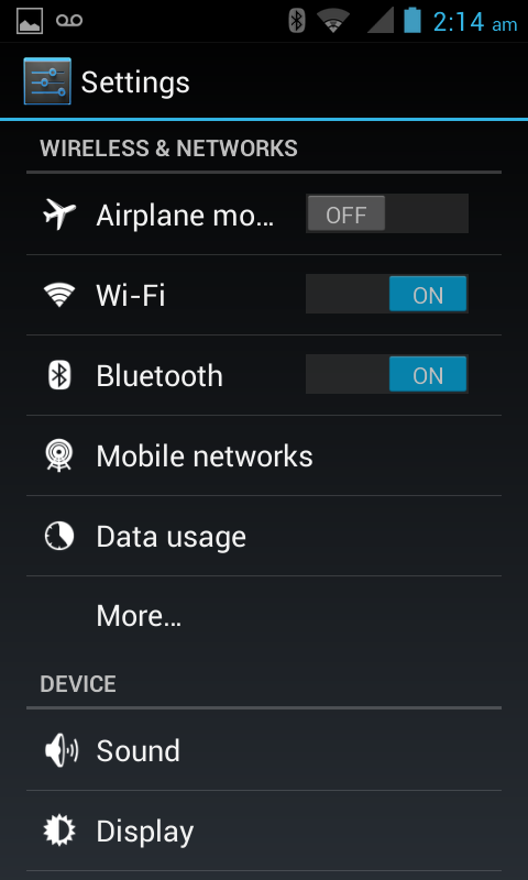

I found that in the sound settings ring tones can't be changed. When trying to change ring tones, alert tones or other "tones" the setting used to do that force closes. Another setting that force closes is "Connection Optomiser". I don't use that one but I though it would be good to know.
Everythingelse works like a charm. Including an improvement of ui and Google Hangouts", with ICS I couldn't load messages directly when I hit the notification. Now I can.
I can live with not changing "tones" for a while.

Really? That's awesome. You must be an optimizing fiend bc I was never able to get above 16.5k with stock or matrix kernel and oc.

Well that's actually why I brought it up. It wasn't just to toot my own horn (though I will if I think I deserve it) it was because this is ouof the box dsf! No kernel no tweaks no nothing. I find it really curious. Once I applied this new rom I'm running nearly 21000 out of the box with antutu.
Here's the funny part though, can trace it back to when it started, but I still cannot come up with an explanation. Just damn lucky I guess.
That's great! I don't even think JimSmith80 ever posted an antutu score that got to or above 17K. You must really be one with the Force Knoober! Maybe you should go into Jedi training! Don't forget to bring your phone with you, though.
Seriously though maybe there might be some sort of minor hardware difference with your device which causes it to perform higher. Maybe a different brand of ram inside or something?
Speaking of Antutu, if everyone else clicks on the N9100 on the first page under where the score is, it brings up phone info. Mine is reporting the wrong processor. I'm pretty sure it did with ICS ROMs as well.
The proc is reported as an MSM8260A instead of an MSM8960, which while they are nearly identical spec'd, one is snapdragon s3 the other (8960) is snapdragon s4. If you check benchmarks the MSM8960 benchmarks slightly higher.
When I cat /proc/cpuinfo it clearly states under the heading HARDWARE, ZTE HAYES MSM8960. As does any specs I have seen online.
Anyone else notice this? Could ZTE have used some msm8260A's faked as an msm8960 and maybe you got a real 8960 knoober?
Check your phone info in Antutu.

Just finished with the usual task of getting this one set up with my preferred apps and settings again. As suspected, "dirty flash" was the culprit. Everything that matters is workng fine. I re-tested all settings again (as usual) and all though I don't use it, "Connection Optomizer" still force closes. If that's the only draw back/bug, I think we could live/deal with it. I certainly can.

Just finished with the usual task of getting this one set up with my preferred apps and settings again. As suspected "dirty flash" was the culprit. Everything that matters is workng fine. I re-tested all settings again. (as usual) and though I don't use it, "Connection Optomizer" still force closes. If that's the only draw back/bug, I think we could live/deal with it. I certainly can.
I'll check it on cpu-z when im around a wireless connection. I cant seem to find what you talking about in antutu. I checked "device info" and it didnt say specifically what proc was in it, just the soc ( i think its the soc, all that ARM7 business right?) But just from memory, I know ive had cpu-z on this thing before and Im nearly certain it reported an msm8960 (but nearly certain is not certain right?) Atleast this qualifies for some sort of explanation. Hoever it is worth saying that for a long time I had the same results as you (13-16k antutu) and then one day I decided to check after reinstalling a clean backup and got that ridiculous score. I checked again just to be sure. The I flashed a different to a different rom (I was using dsf so it must have been your first attempt at jb that I flashed to) and checked again. Still the same. Next came the text now business from downgraded, and I flashed through those fully expecting to lose whatever magic glitch had allowed such fortune. When I restored from either a backup, or even clean dsf , the scores are still hitting the ceiling! Once again I fully expected to lose my magic phone when I flashed to this new jb, but it is still there. I just ran antutu again while I typed this and got 20,821.

I checked in cpu-z and it says ZTE HAYES MSM8960. Architecture Krait.
I can't seem to see where it says the specific processor model in Antutu either. Maybe it was just when I clicked on where it says N9100 before running a test with it? Now it just says the processor is arm v7 and about the VFPv4 NEON extensions. But I really did see it report that MSM8620A proc.

I broke 20K! It's still cool when before I always got 13-16K.
You can definitely tell the system is snappier. The memory usage does seem to be a bit higher with JB.
Who's one with the Force now :) at least your score is the explainable and replicatable. I live in fear of losing my magic phone! :) thanks for all the hard work, I for one really enjoy the upgrade. We certainly waited long enough for it!
Boy do i feel silly. a closer look in the details tab of antutu under "cpu model" shows and 8260A. cpuz must use a data ase for their information because it shows an 8960 hayes! who do i trust!? in this case im beleiving antutu. but i would love to know a way to be sure. you said there was a cat command that would show the proc model?
I know you're right cuz of the amount of dev you've done here, but antutu will be mad if I try to correct them on that basis :) any ideas where the discrepancy comes from?
