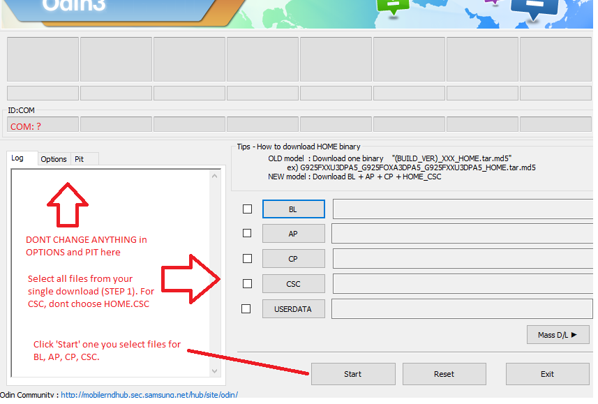

Apparently the firmware "G950FXXU6DSK9" doesn't work. So I got myself Odin (Odin3_v3.13.1) to flash a working firmware but cannot, for the life of me, figure out the right firmware - mostly because I don't know the right PDA and CSC.
In any case, here is the Odin log:

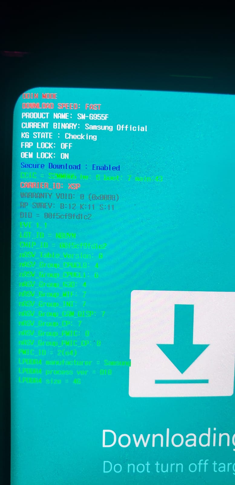

- region of my phone, as seen in the download mode (XSG - United Arab Emirates).

- I can enter the download mode

Here is what I have tried, unsuccessfully:
- used the most current version of Kies; however my device is not supported.
- used the most current version of Frija (v1.4.2); however I got "error 102. unable to find firmware"
- downloaded and successfully flashed 3 different firmware versions, obtained from sammobile.com. these 3 versions are:
G950FXXS6DSL2_G950FOXM6DSK9_BTU
G950FXXU6DSK9_G950FOXM6DSK9_BRI
G950FXXU6DSK9_G950FOXM6DSK9_SMA
I have flashed AP, BL, CP, and CSC. I did not flash HOME_CSC. Then I tried also with HOME_CSC, but no difference.
however after successful flashing, the outcome in recovery mode was unchanged. I still couldn't use any of the recovery mode functions, and I still got the exact same error messages.
I also tried flashing G950FXXS5DSI1_G950FOXM5DSHC_XSG, which at least had the correct country code (XSG), but this one I couldn't flash using Odin, so I went back to a previous one (G950FXXU6DSK9)

STEPS
TAKE OUT your memory card, all of your phone data will go away. ( Looks like your data has gone already.)
STEP 1
File#1
https://updato.com/download-samsung...e/sm-g950fd/96C40C6FE6F611EAB4A2FA163EE8F90B/
File#2
ODIN v3.13.1
https://odindownloader.com/download/odin3-v3-13-1
STEP 2
PUT your device in DOWNLOADING mode (VOLUME UP + POWER + BIXBY)
STEP 3
Once you click on 'Start', entire process will take 5.5- 8 minutes. You will see 'PASS' message.
IF your screen got in BOOT (message) after completing STEP 1 - 3, do STEP 4.
STEP 4
In the ODIN, select AP file ONLY (no BL, CP, CSC) and click on Start. Process will take (5-6 minutes) and now you will be out from BOOT LOOP.
This solution will work 100%, if you have any issue, let me know here.

STEPS... TAKE OUT your memory card...
By golly, this worked! I was getting stuck on the boot screen after flashing to the latest stock ROM for my Note8 International (N950F). As promised in M P's post, simply reflashing just the AP file did the trick.
Thank you so much!
Hi, am having the same issue with a s8+ SM-G955FD Carrier XSP tried the re-flash of the ap as previosly mentioned but still, goes to the samsung logo but reboots. Any ideas?
"re-flash of the app"????? what app are we talking about? are you sure you used the correct firmware? where did you get the firmware from? how did the phone get to this state? just randomly? or did you do something like trying to root the device?
As mention in an answer above to reflash the AP file on Odin, again once you flashed the four files (BL,AP,CP,CSC)
Roms I tried, Where download from Sammobile and one from Freya.
Phone started randomly on its own, never tried to root or flash, it turned off one day and started bootlooping.
Thx in Advanced.
One more thing, Download mode Says my device is SM-G955F no D but on the back, box and battery says FD any ideas?
