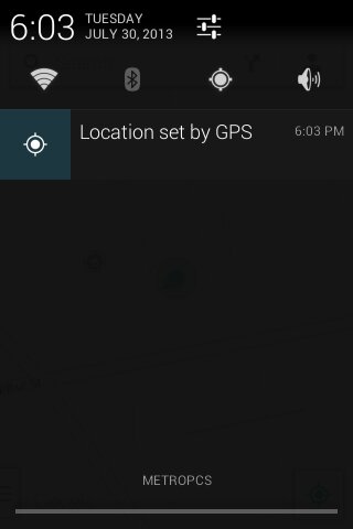

I can't effin believe this... you have made BobZ my everyday ROM.. see screenshot I have never had a lock on BobZ since well.. forever .. I take back every single speculative word I spoke. A+ job
Edit: the lock only took 5 seconds, and I had 8 satellites .. pretty smooth..

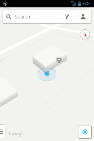

Sorry for the double post.. This is a second test.. Mobile data and Wifi OFF. Locked in 3 seconds. I'm standing behind my house, facing the exact direction of the compass, smoking a cigarette.. Amazing. Anyone who is on here a lot knows no GPS was the only reason I uninstalled BobZ .. I'm sold.

Dude, had a sneeze attack on the highway coming home from work and took an exit in a very unfamiliar area til I recovered lol.. So, after I was all set, I decided to deliberately get myself lost.. After driving for ten minutes, and being COMPLETELY LOST I put the fixed GPS to the test.
Opened maps, locked in 3 seconds. Put in my home address, then entered navigation..
I'm at home right now... It worked flawlessly ;)

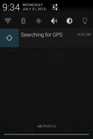

Well I unfortunately I still can't get it to lock. My gps refuses to find a satellite.
Edit: would it make a difference if I changed the permissions around a bit to rwx-rwx-r--
Edit #2: can done who has it working on bobz 5/21 build please send me both of their gps files so I can check if the ones I have are corrupted
Do you get a notification that it's trying to locate?
I'm telling you telling you telling you, if you still can't get a lock, unbrick to C and install CLEAN. Confirmed to work for one other person who couldn't get the fix to work before.. Tellin ya, unbrick to C and follow this order: Unbrick to C, root, install 2nd init recovery, flash CM10, then gapps, then C modem, then gps fix.
