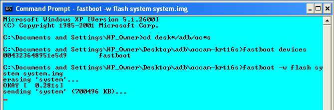

On your suggestion, I interrupted the flash operation on Debian 7.2 after 5 hrs. and tried the XP experience again, where fastboot now seems to work w/o crashing the OS.
It's been > 20 min. so far, image attached. At least the device bootloader screen still states in green "Downloading ...", but there's very little disk activity. I'll just let it run overnight in case this 2.2 GHz processor is too slow for modern operations like this one, with only 448 MB ram which seems a bit shy.
[edit 22:03 PST] One hour later, no change in the attached image, although device still states in green "Downloading ..." [/edit]
[edit 09:12 next day] 12 hours later and still green "Downloading ...", same as attached image. [/edit]

Are you using a usb 1.0 or 3.0 port? fastboot doens't play nice with them and you should try a 2.0 port.

16 sec for 2.2 MB means it should take about 4991 secs. for the 700.5 MB system.img ... that's about 1 hr. 23 mins. Those people that said two or three minutes "tops" must have some really, really fast transfer rates over usb.
It sounds like there must be something going on with your USB interface. It absolutely should not take over an hour to flash system.img. It's been a bit since I did it on mine, but I'm pretty sure it was well under 5 minutes.
Indeed you are correct ... I unplugged the Buetooth dongle and plugged the phone's usb into that port:

Thanks for your feedback. Apparently the usb ports on both machines were USB 1.1 and were causing the problem. The 2.0 ports were hidden in the back.
