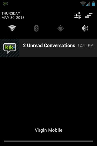

Almost done just have some framework things to add/fix.
JB style date, clock, settings short cut and yes the footer glows when touched. :D
