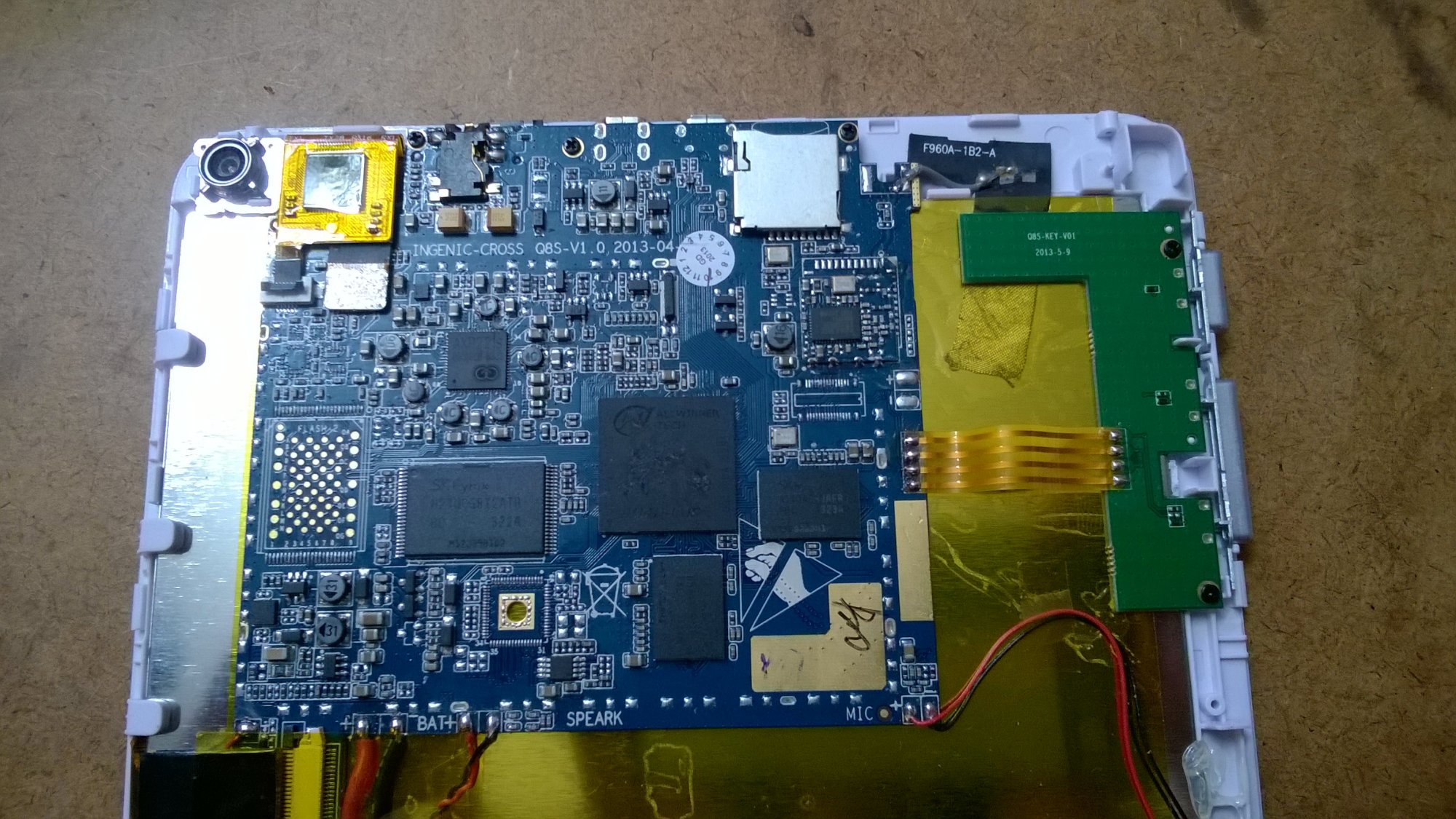

i flashed kasty-onda_v972_v2-442-v44-rooted and i don't know whether the process is done or not because nothing is loading on the screen after i flashed that rom and i don't know what device is it because there's nothing on the board and on the back of it and the software i got when i received the tablet was not stock rom

i didn't get the box as i was gifted with that tablet and i even opened it seen the board there's nothing on it though if u want a want to see it i can send u a picture of it and i most probably think it is a study tablet but was installed a custom rom on it and was given to me so there must be a way to get to hard reset it

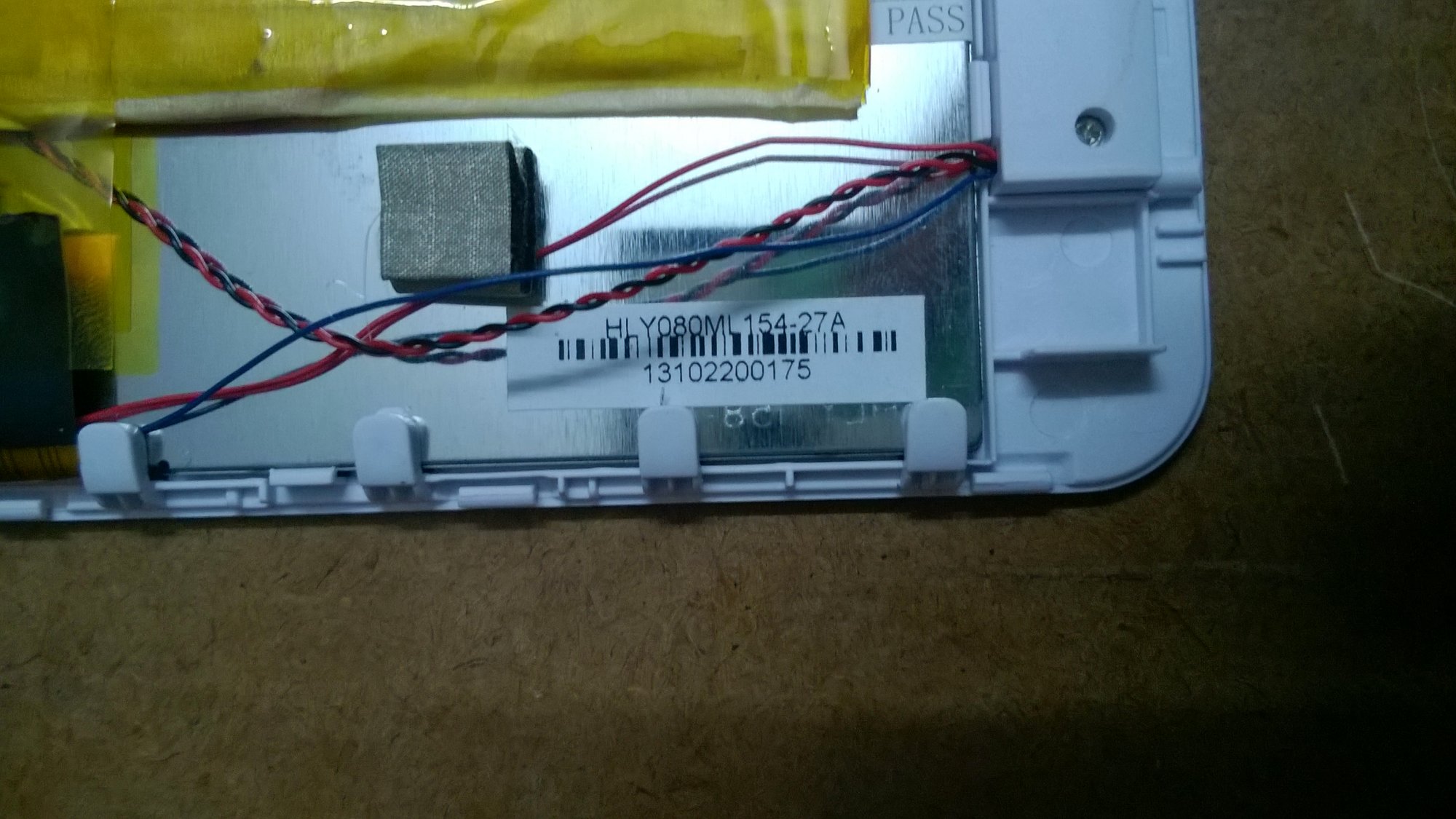

That third shot suggests that this is a tablet that was supplied by this programme. That may help someone track it down, though I've not yet found any details of what model (or models) they supply. Did you have a reason to believe it is an Onda V972 tablet (which is what that ROM was designed for)?

The only reference I could find to that motherboard is this Russian forum post. The device they refer to there seems to be for the Russian market (all references I could find were in Russian), so probably not the same tablet. I would imagine that budget tablet makers will use off-the-shelf components, so wouldn't think that the motherboard itself would suffice to definitively identify it. The poster in that forum was incidentally having problems finding firmware for his/her tablet that would work, and the person who replied to them just suggested using adb to backup (not your problem, and won't work in your current state), so I doubt there's any help there.
You never answered the question of whether the person who gave it to you knows what device this is.

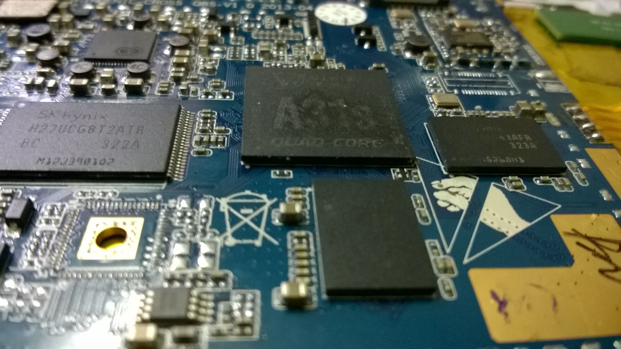

CPU: Allwinner A31S, Quad Core ARMv7 Processor (VFPv4, NEON)
GPU: PowerVR SGX 544MP
MotherBoard: INGENIC-CROSS Q8S-v1.0 2013-04-22
Version of Android: 4.2.2
Build Number: fiber_q8s-eng 4.2.2 JDQ39 20130723 test-keys
