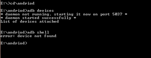

Hello sir, i have downloaded everythng as u said (SDK tools for Android, Java runtime, and HTC Sync)
and my phone is in charge only mode also USB debugging is ENABLED
when i am typing adb devices its showing 'list of devices attached' not the serial number
n when i am typing adb shell its showing error
please help:(
please help:(
That screen shot tells me that the drivers are not recognizing the phone. Remove the HTC drivers, reboot your PC and try again. If the generic drivers included with the SDK recognize the phone, you will see your serial number after "list of devices" when you type "adb devices".

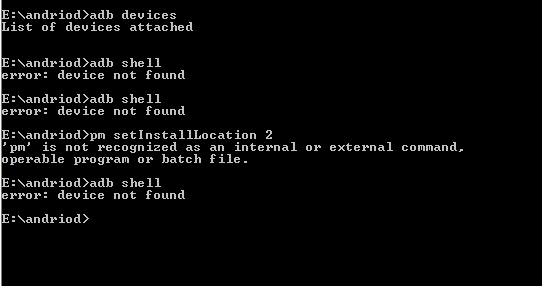

sir,as u said i uninstall the HTC drivers.. but still the problem is same...what to do now??
Something is preventing the drivers from seeing your phone. Could you let me know what version of windows you have so that I can recommend the correct steps.
