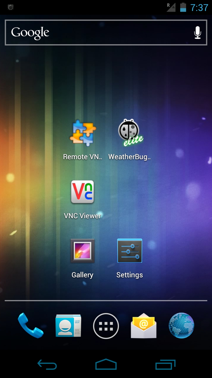

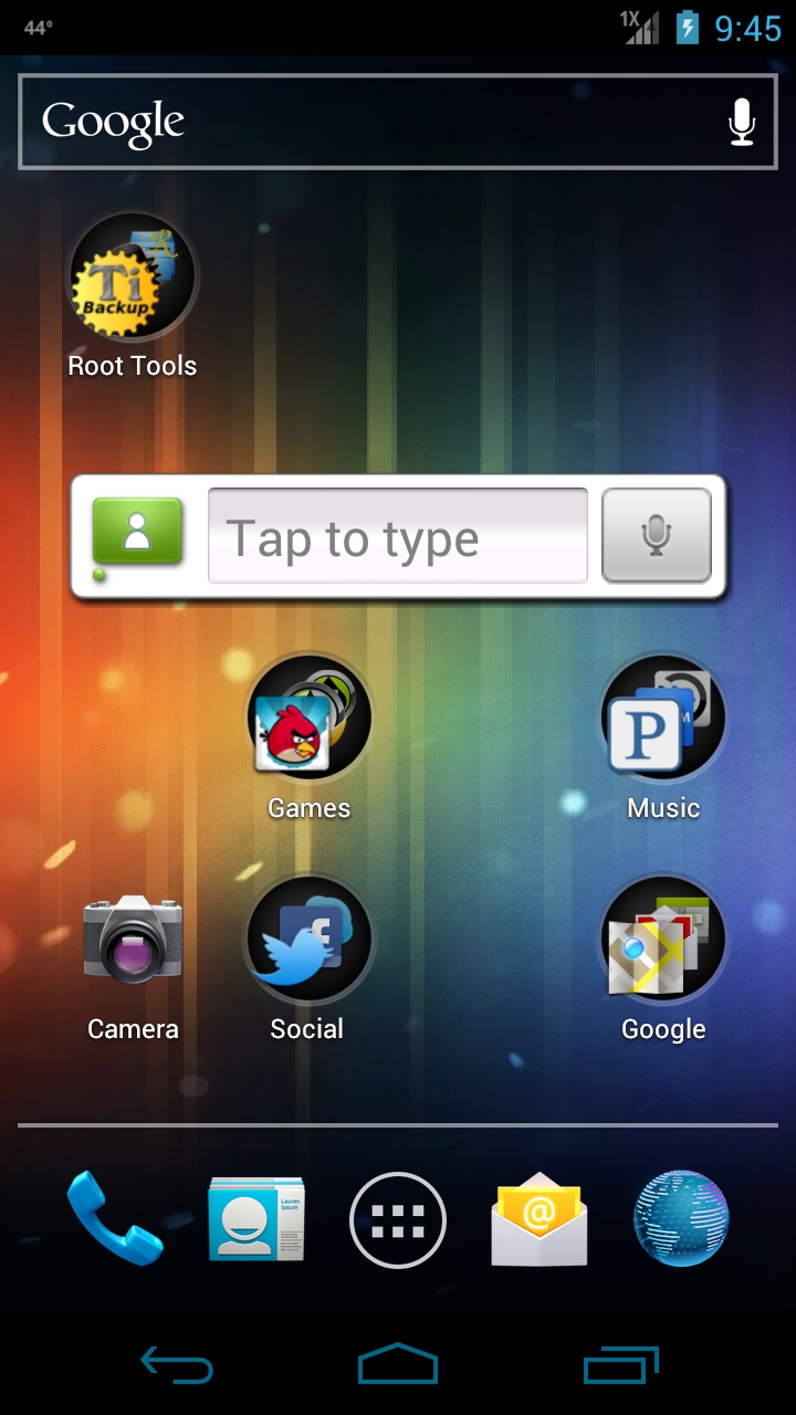

Well, I was back in the area for three days without any service.
One time I got a little R by my signal meter for about 30 seconds, but I tried the data and the talk and it neither worked.
I also got a 1x symbol one time for a couple of minutes and the data was very slow as it should be. It looks like it had good signal.
This is the first time I have got either of the symbols.
