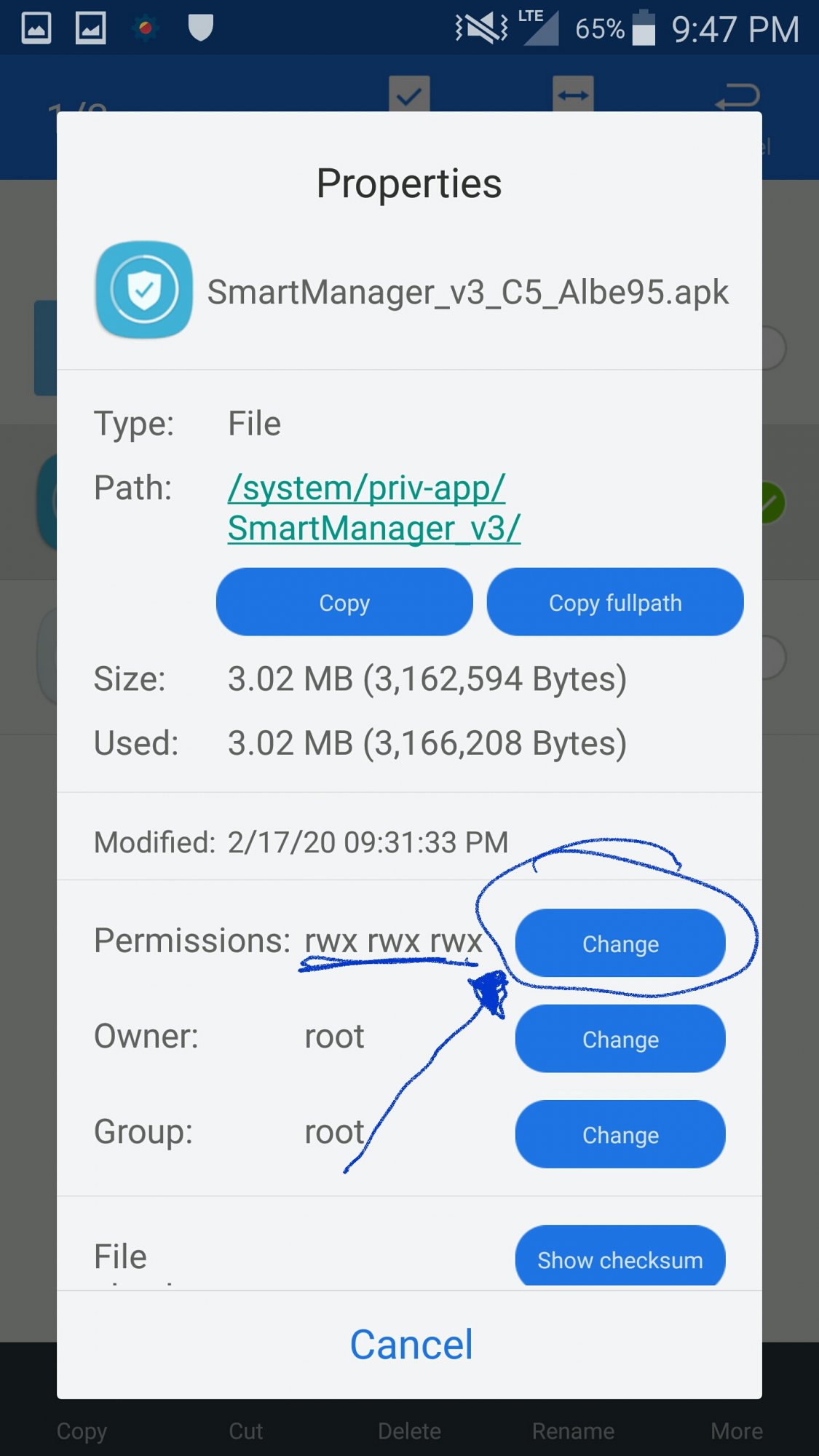

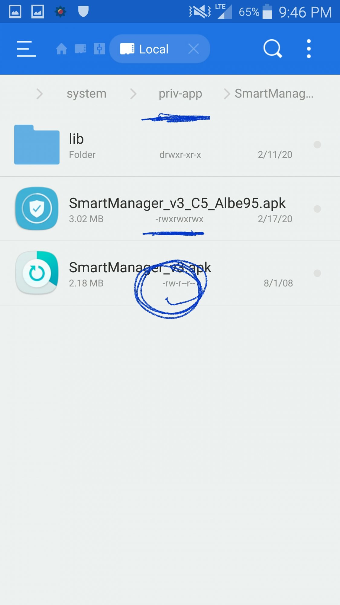

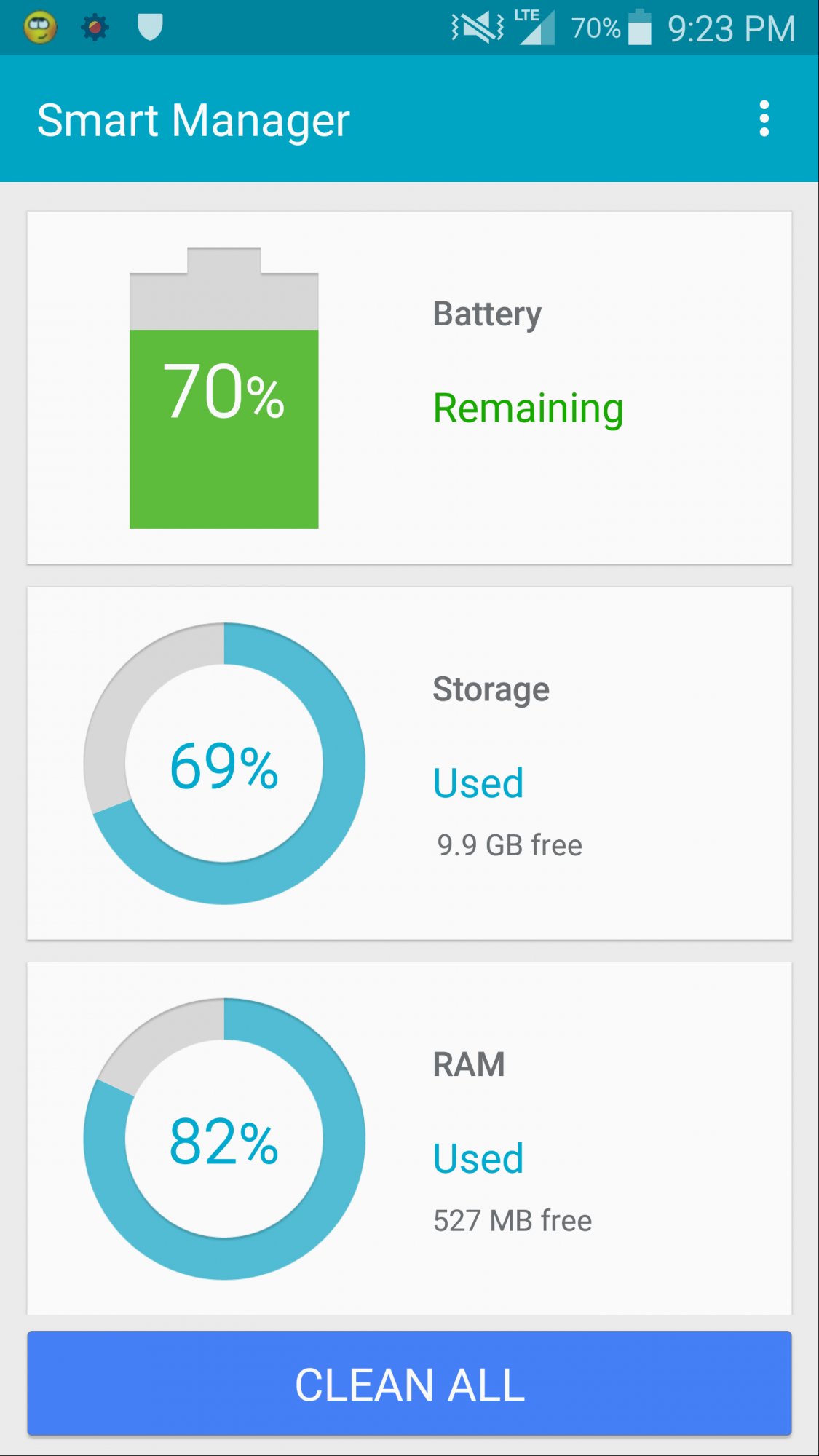

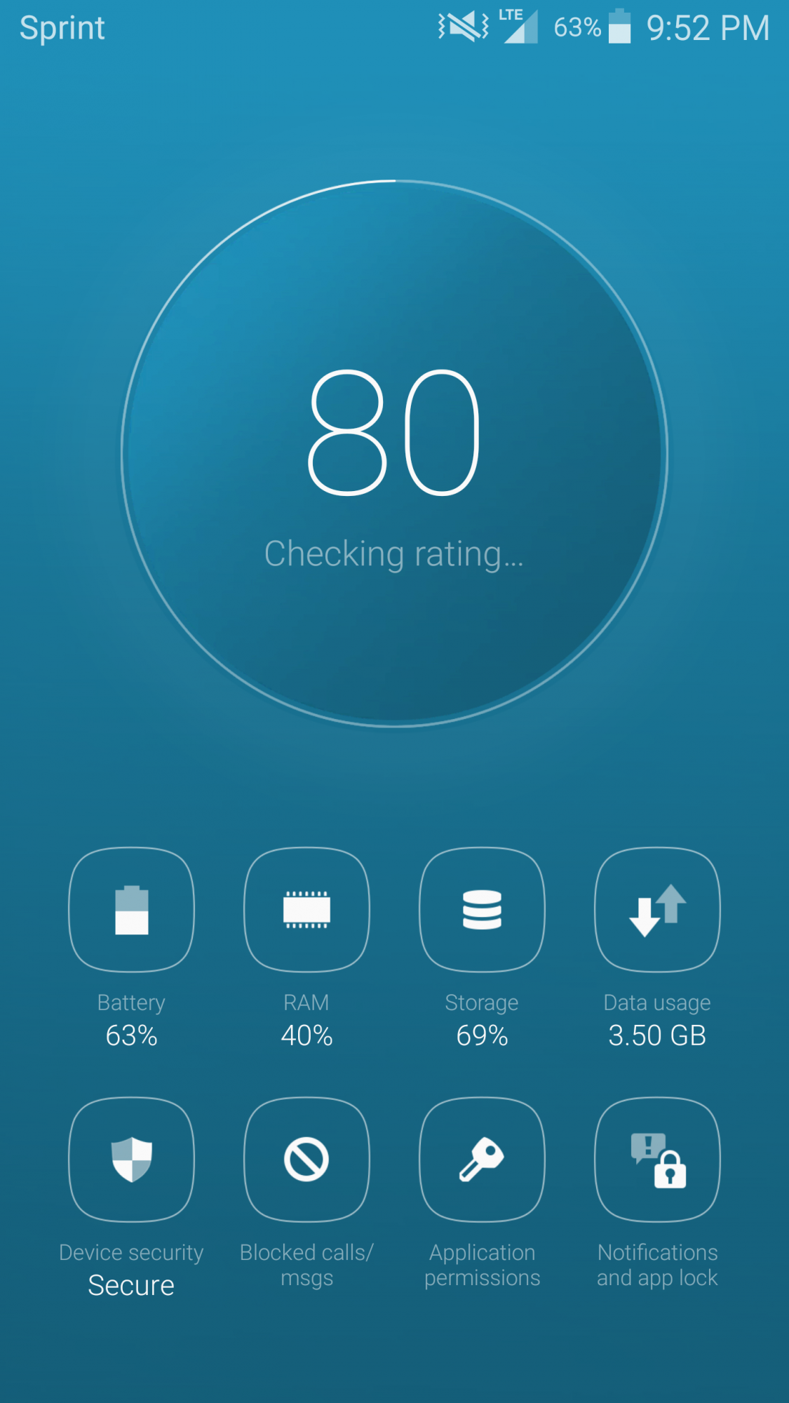

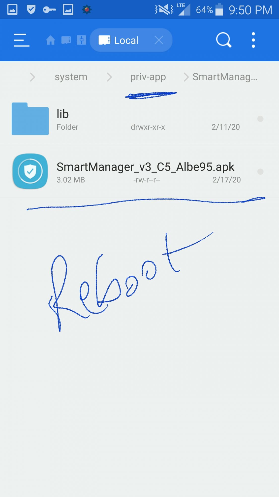

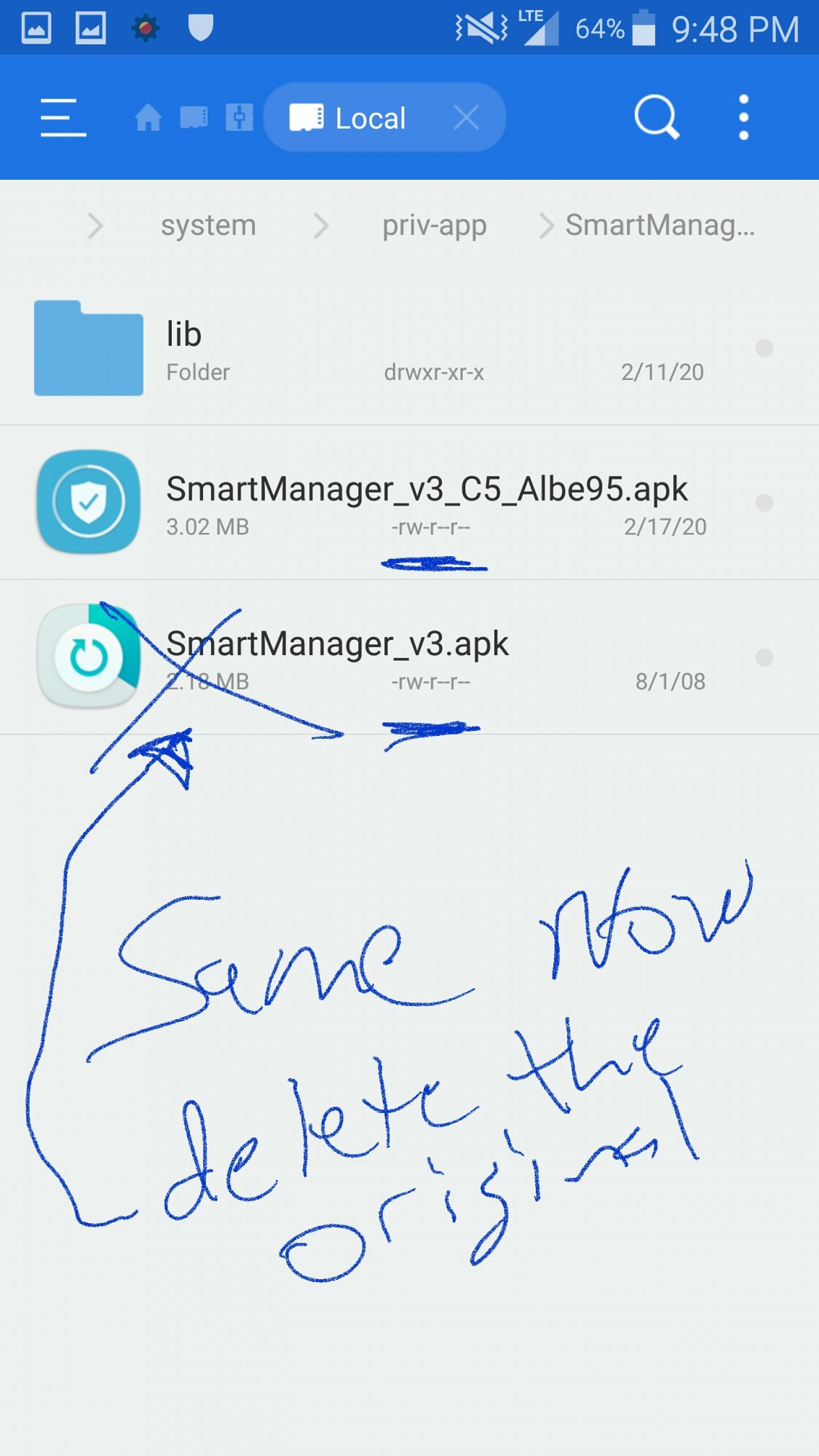

Once pasted notice the permission of the original and your ported Mod are not the same. Change the ported Mod Smart Manager to match the original.
The lib folder need not be changed as it was not ported.
Question..do I need that smart manager?, I don't have it any more..it's fine from my phone..what do I need it for?, what's the relevance with hot spot?
Never mind..I get..just for testing purposes..

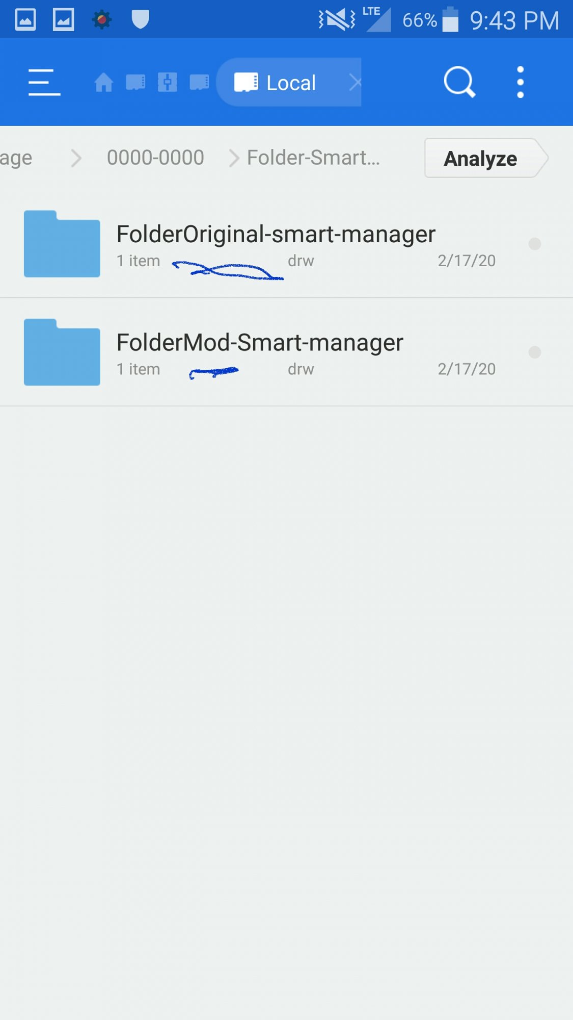

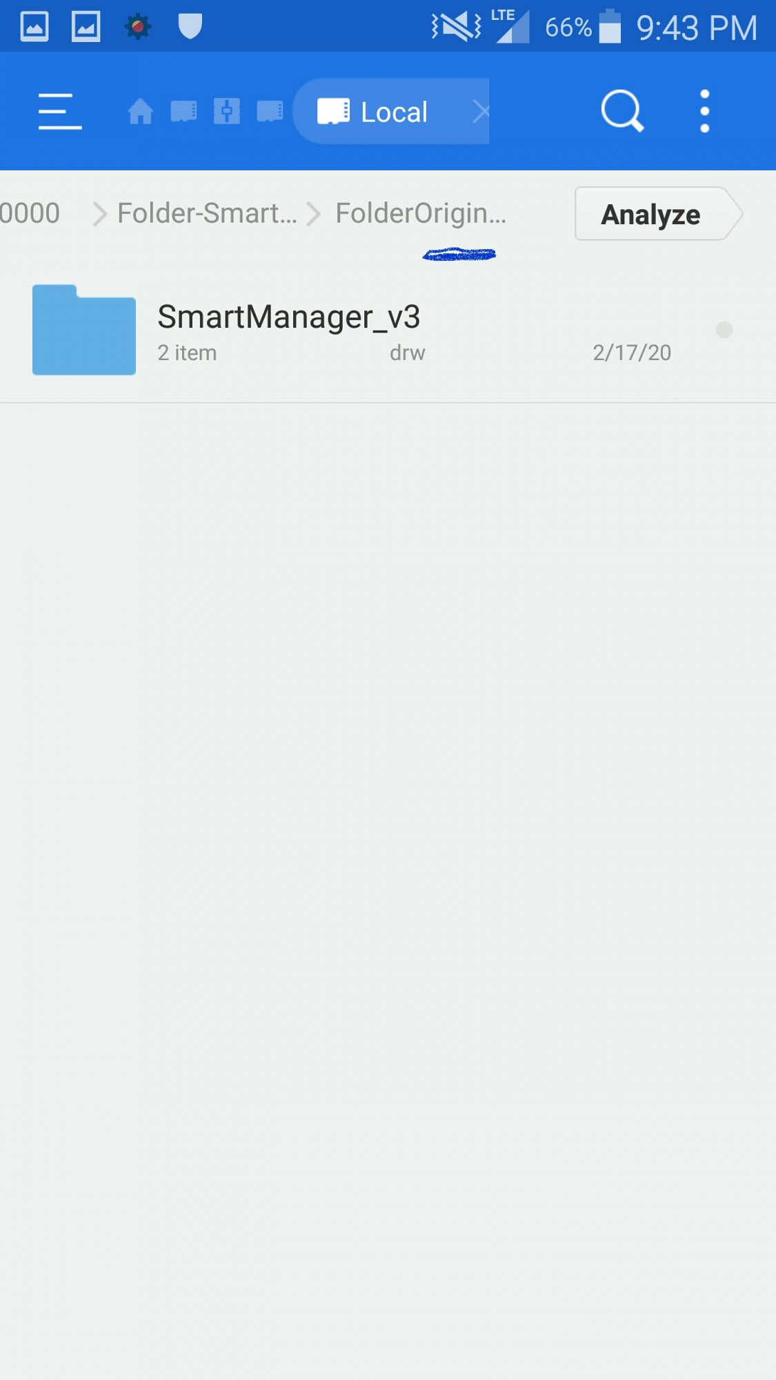

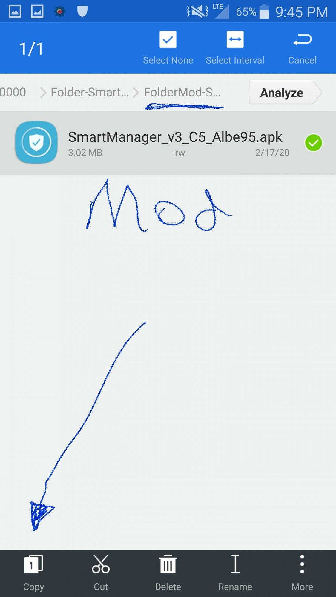

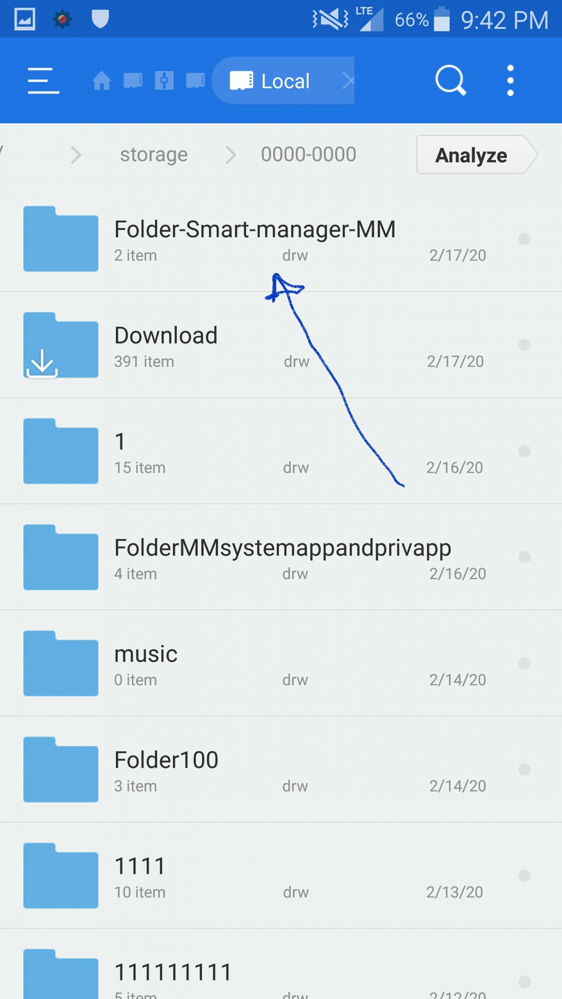

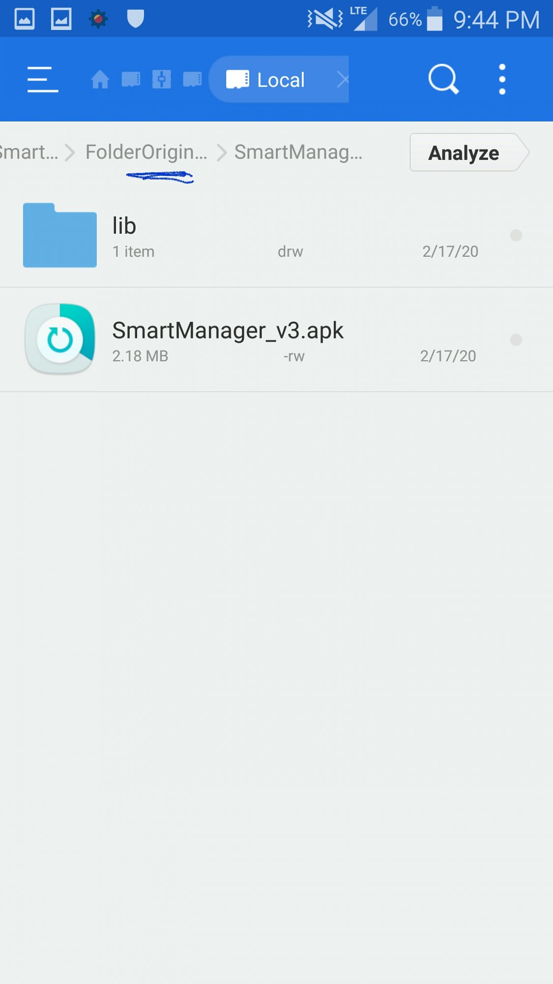

If you notice the screen shoot above I specifically named a main folder on external sd and it 2 sub foulders (original and Mod). Before you begin copy original folder from your system and place it in orginal sub folder. And do the same for you port to mod folder. Rename your mod from framework.jar to framework1.jar. That way you can copy and past it. If you do not change the name your moded framework.jar you won't be able to past it to system because it will not allow 2 folders, files, jars, apps..... etc with the same name

Only do one at a time. For instance if you choose services.jar, just do that one and reboot.
If you do both and one is compatible and the other is not you won't know which one is or which one isn't. If you wind up in bootloop you may believe both are incompatible. This way you can determine exactly what is and what is not. :)

No, It is only needed to past. Then maych the permissions of the original. Copy original jar to external sd. Go back to system and delete original framework.jar. Then change the mod system framework1.jar to framework.jar.

The only difference is that I delete the original before I paste the mod one..for name purposes..had worked for me so far..
I'll try what you do by having both at the same time while I change the rights of the mod one..
