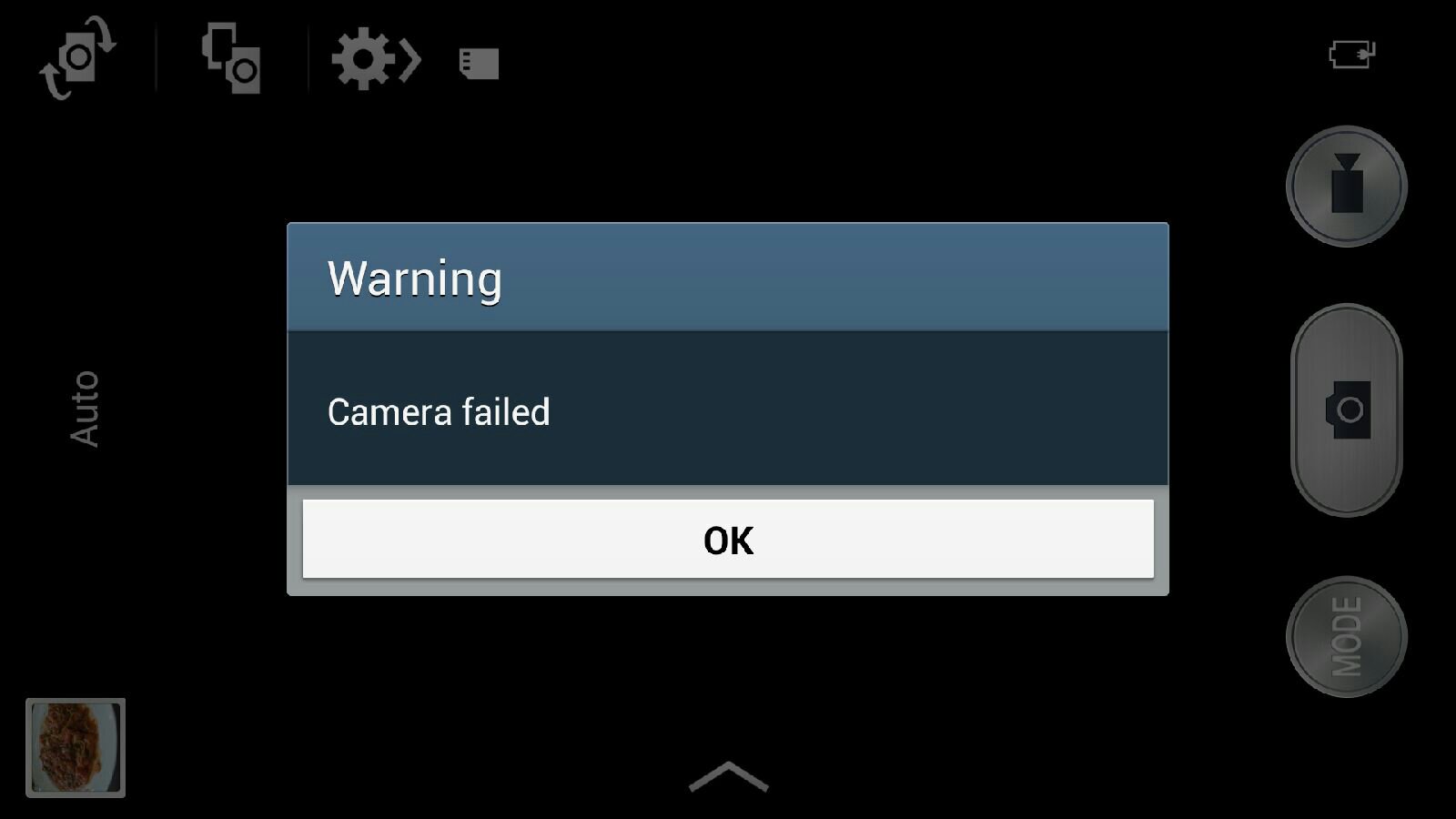

So I went to use my camera today and a black screen popped up and then seconds after a warning box appeared and said camera failed! I did a soft boot and factory reset and nothing will fix it! I'm over my 15 day trial period so I can't take it back. Anyone else experience this or have possible fixes?!?!

Try connecting to kies, see if there is any firmware upgrade. But from what I read on xda while ago, most who suffered that, had to send their device to claim warranty.
I suspect it's a hardware problem, which would still put it under warranty. You could try taking it to a store for exchange, maybe you'll find a soft-hearted person there.
What happens if you install a different camera app from the market, same problem?
Do you have an SD card in your S4? I had that problem on my S2 Skyrocket and when I removed the SD card the camera worked fine.
Are you rooted? and/or did you disable any of the Samsung apps?
(example: If I disable s-voice, and try to enable the setting for voice control of camera, that causes the camera app to Force close)
I ahd the same issue 13 days into owning the S4, bog standard phone with no routing, it was a little intermittent (as faults always are when yor trying to show the phone shop) but the forward facing camera never seemed to have a problem working, I ended up asking for a replacement handset there and then as is was still within 14 days. new handset and not a problem since.
The shop did try to say it was down to a app causing the problem till they went through all aps installed and couldn't find anything. The only camera app other than standard i had tried was snap chat but only had it on the phone for a day and removed all the associated files.
Yes there is an sd card.. But if that doesn't fix it what else could I do since I have had the phone more than thirty days
