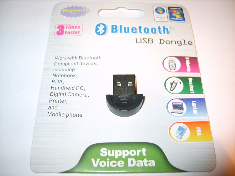

I have plugged in a bluetooth dongle to my ATV2000 (updated to 20120730) and the light has come on but I can't find out how to enable it.
I'm trying to find a wii remote in MD.emu but it says 'bluetooth not accessible'.
Hi Daisy606, latest update20120730 has not bluetooth support, so you can't find any option to make it working.
You should install previous firmwares as: update20120420 (ICS) or update20120606 (GB)
which, both of them, support bluetooth connection.
I have tested, successfully, a bluetooth dongle "made in china" (not branded) and, installing
Bluetooth File Transfer.apk from Play Store, I was able to connect my phone to ATV1000.
This is my BT dongle: bluetooth usb dongle.png
Be careful that, not all BT dongles work but only those ones which have also specific drivers for linux/android.

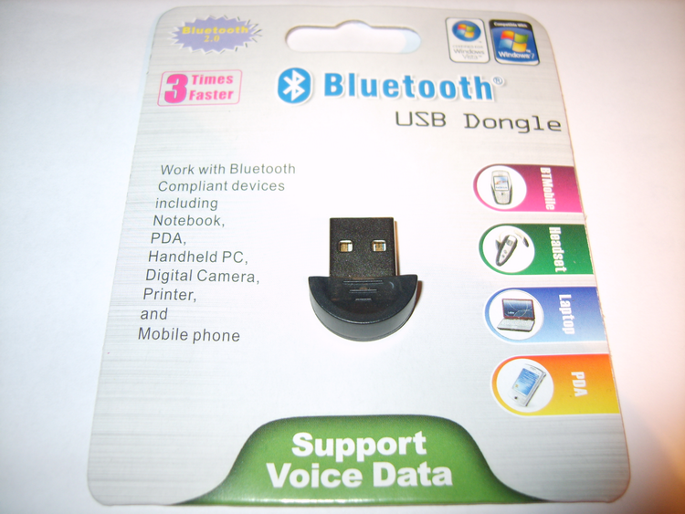

This is my BT dongle:View attachment 37701
