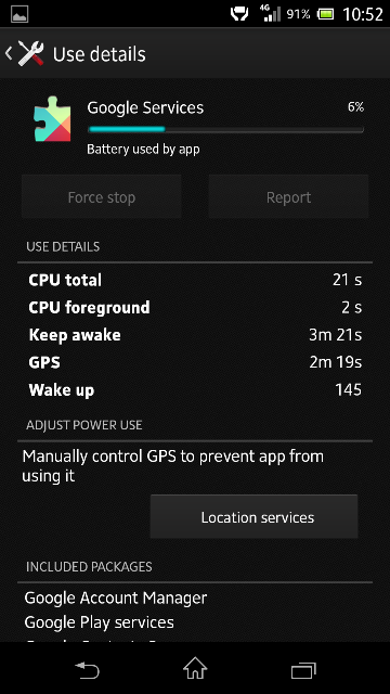

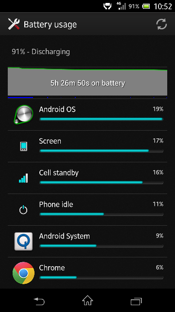

This is quite an interesting one - yesterday at the end of the day my battery was at 18%. When I looked at the battery useage, I saw that "Google Services" had used 73% (screen was something like 12%).
Sadly, I didn't think to take a screenshot of it because I thought a reboot would probably fix it.
It didn't.
Today, it's doing a similar thing (see photos).
I've noticed some other threads about Google Services doing this, but I haven't updated any apps or downloaded anything since this has started happening so I'm finding it hard to find what the problem is. Anyone else had this?

Guys, might have fixed this.
First I tried uninstalling (or disabling) Google Play Services - big mistake. Just throws up loads of errors until you install it again.
Then I fiddled with the options in Google Settings. Went to Android Device Manager and unchecked both options,
So far so good, but I'll keep monitoring for the rest of the day and report back later...
11am update - still there a little, but nowhere near as bad as it was.

Okay, 5pm update and we're looking really good after disabling those options.
Please can someone tell me what I'm missing here - surely the experts at XDA have/had thought of this already....

Well I was going to post a screenshot of the end of day battery status but there's no point because Google Play Services is not even on there now. End of day, usual usage throughout the day and I'm on 48%. That's pretty much back to normal for me.

Just by comparison, my Google Services percentage battery usage is at 4% at the moment, CPU total: 25s, Keep awake: 4m 12s, GPS is 2, 0s, and "Wake Up" (whatever that is) is 350.
I unplugged at 5:30am this morning (early start for me!) and it's now 18:43 and I have 76% battery left. Hardly used phone really (screen time has been 40m 24s (22%)).
Hope that's useful.

Mine is 4.0.34 (924341-38) as well. I do still get wakelocks don't get me wrong, but it's nowhere near as bad as it was. In the 3 hrs 11 minutes it's been off charge, there's only been 85 in 43 seconds (1s for CPU total). Screen on time 11m 55s.

Anyone noticing any improvement on this? I now have everything on apart from Location reporting and Location history in Google Location Settings, and although there are still a few wakelocks creeping in I've noticed a big improvement over the last few weeks.
5h 59m on battery
Screen on time: 33m 58s
Google Services:
CPU Total: 41s
CPU Foreground: 1s
Keep awake: 6m 29s
GPS: 1m 16s
Wake up: 184.
