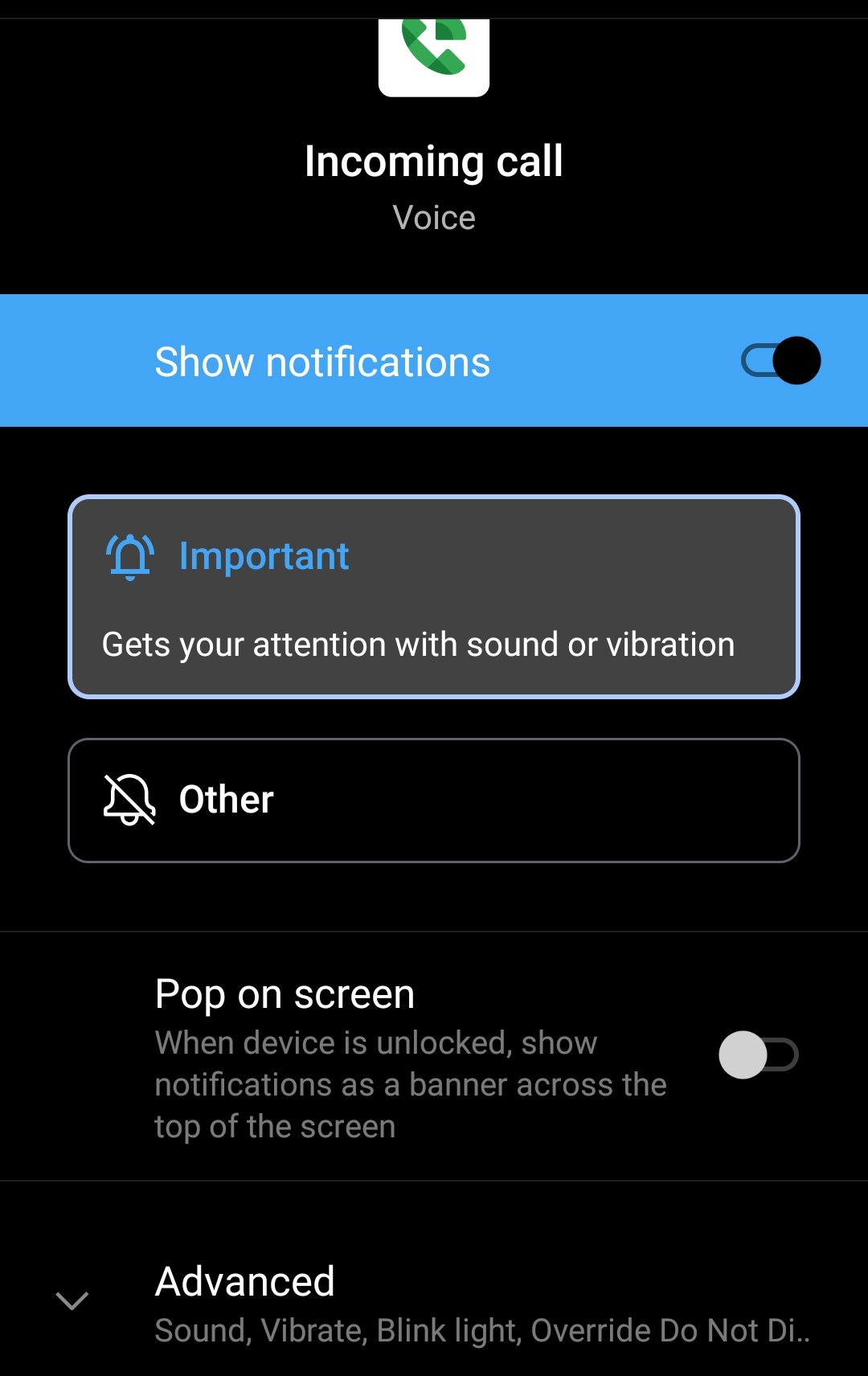

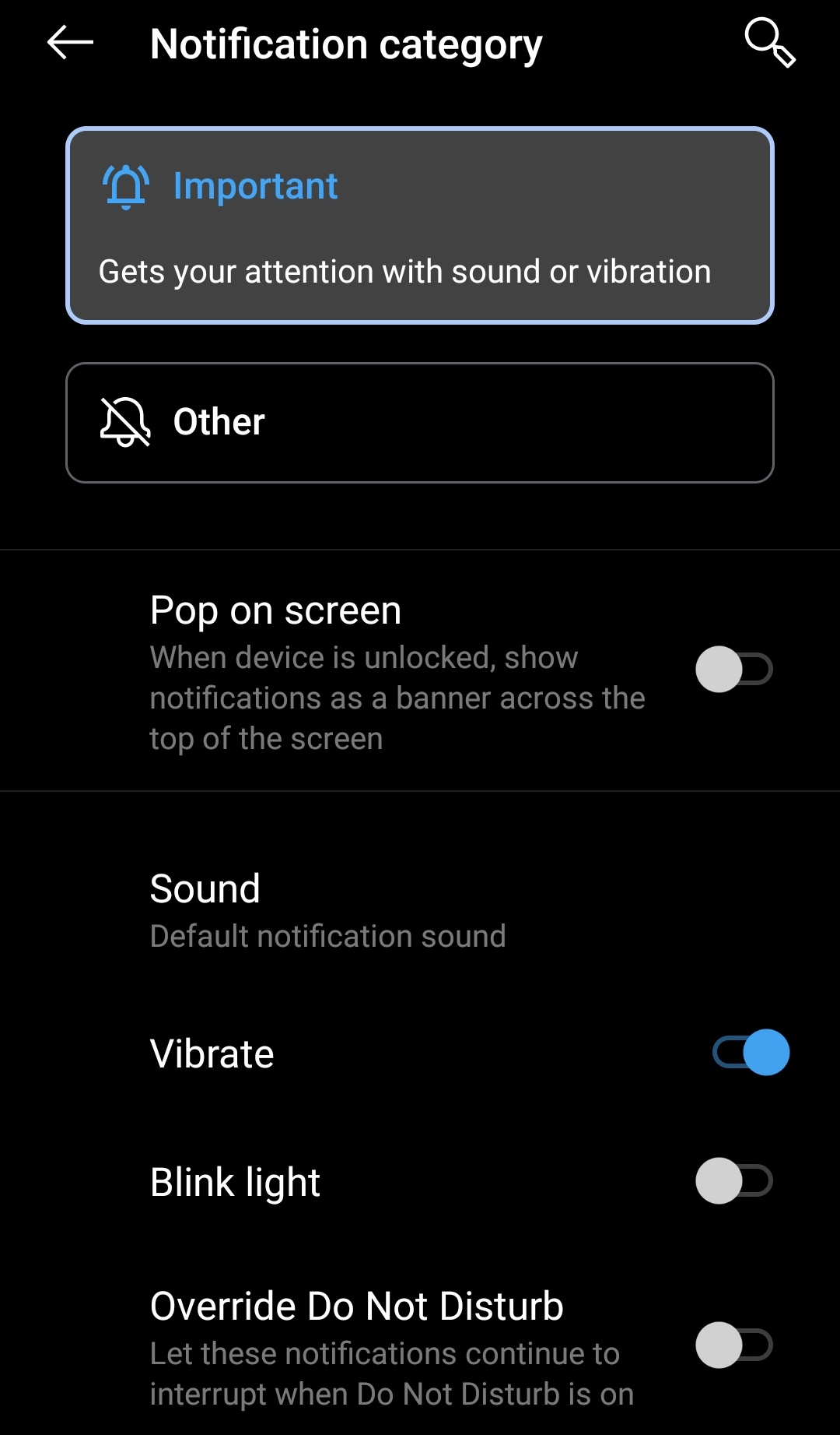

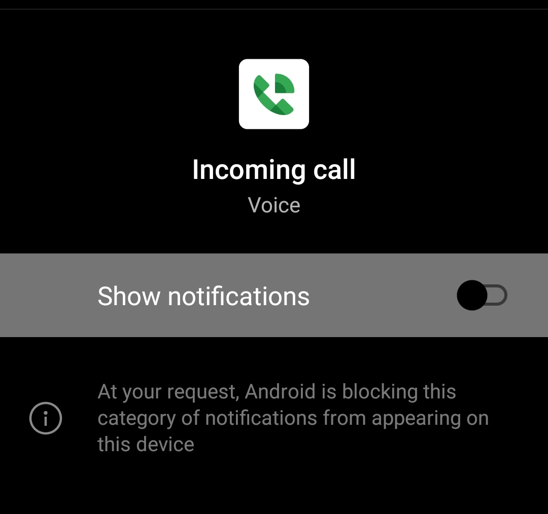

In settings, where it says incoming calls notifications, is that enabled ? and if it is, and if you don't see notification settings, scroll further down, see if you have an advance tab, if you do, hit that and check if it gives you notification options.
If you still don't have these options, only other thing I would do is, clear cache, force close and then clear data, and start from fresh and see if that helps or works.

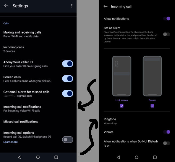

Google support says I can customize ringtones by going to Google Voice's "Settings > Calls > Incoming call notifications > Sound"; but there's no such option as "Incoming call notifications" under "Settings > Calls". There is "Message notifications" under "Settings > Messages" though.
It is odd you don't see that Incoming call notifications menu in your Google Voice app Settings menu.
I'm looking at the Google Voice app on my phone when I tap on Incoming call notifications in the resulting page it includes a Ringtone option. Tapping on that results on a list of available sounds to pick from as the default GV ringtone.
Perhaps you just need to double-check the Settings menu in your GV app for Incoming call notifications, and be sure to select a ringtone.
