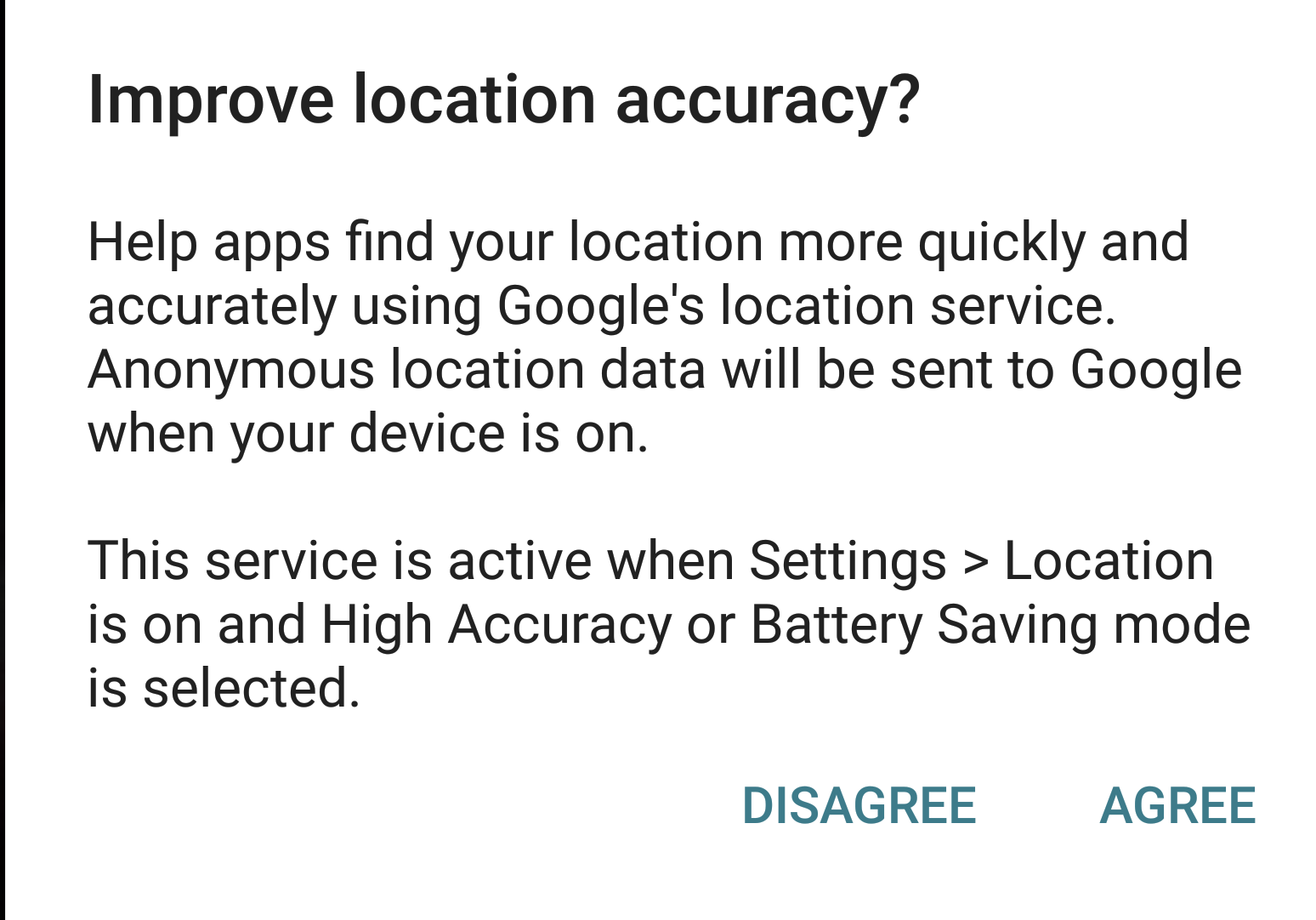

9) Each time the GPS turns on automatically, I also receive a dialog box which states:
"Improve location accuracy?
Help apps find your location more quickly and accurately using Google's location service. Anonymous location data we'll be sent to Google when your device is turned on.
This service is active when Settings > Location is on and High Accuracy or Battery Saving Mode is selected."
I am given 2 buttons: Disagree or Agree. Selecting either does not turn it off. Selecting disagree will cause the message to come up again after a few minutes. Usually, after selecting Disagree, I also immediately turn off the location in the pull down panel. However, GPS is turning on quite frequently (every 5 to 10 minutes while in use), and at some point after I put it on the charger and go to sleep.
