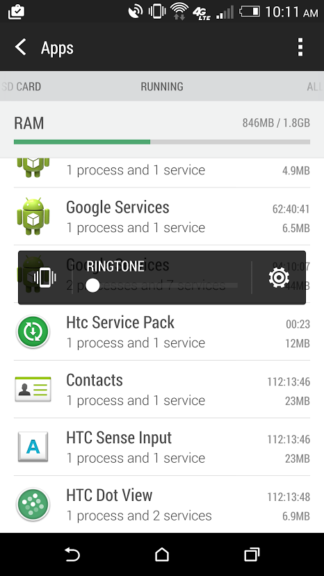

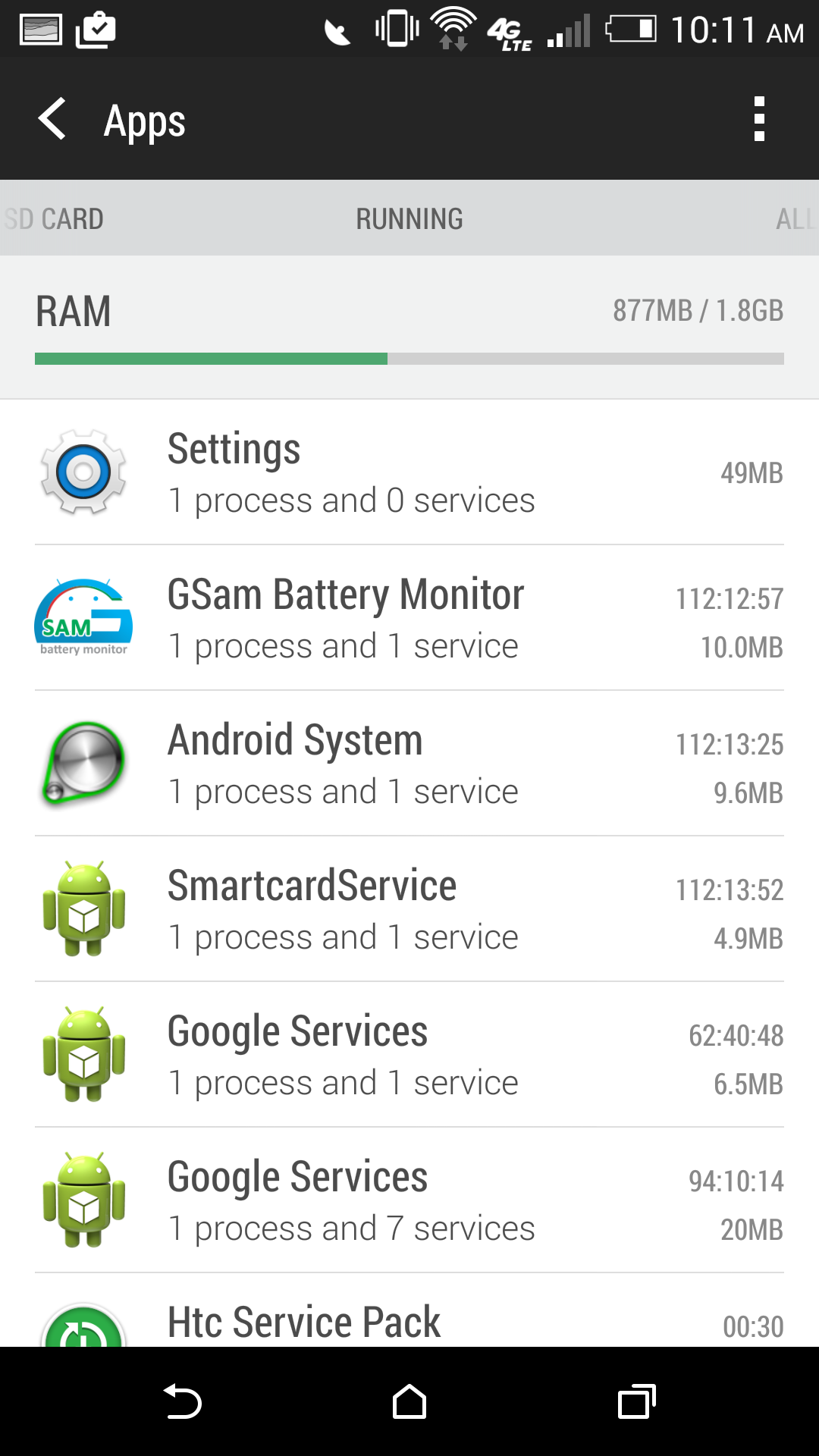

I noticed about a month ago that my GPS indicator would be on for no reason at various times throughout the day on my AT&T HTC One M8. It doesn't just flash on, it will stay on, for a long time, and if it doesn't get a signal will just go indefinitely. No apps that would obviously use location services are necessarily running at these times (Waze, browser, yelp, etc.) I have tried closing all my running apps and it doesn't kill the icon. My phone is unrooted.
How can I determine why this is happening? I've run out of ideas at this point, and the problem is persistent. Attached are screenshots of running apps after closing everything that might have been accessing the GPS.

Actually there are many more apps that can use location than you'll find there. You may be surprised how many have location privileges.
But yes, Google Location History is an obvious one to start with. Turn that off and see whether it helps.
Possibly Google Location Reporting or something maybe? Take a look in Settings>Location. See what apps are allowed to use GPS.

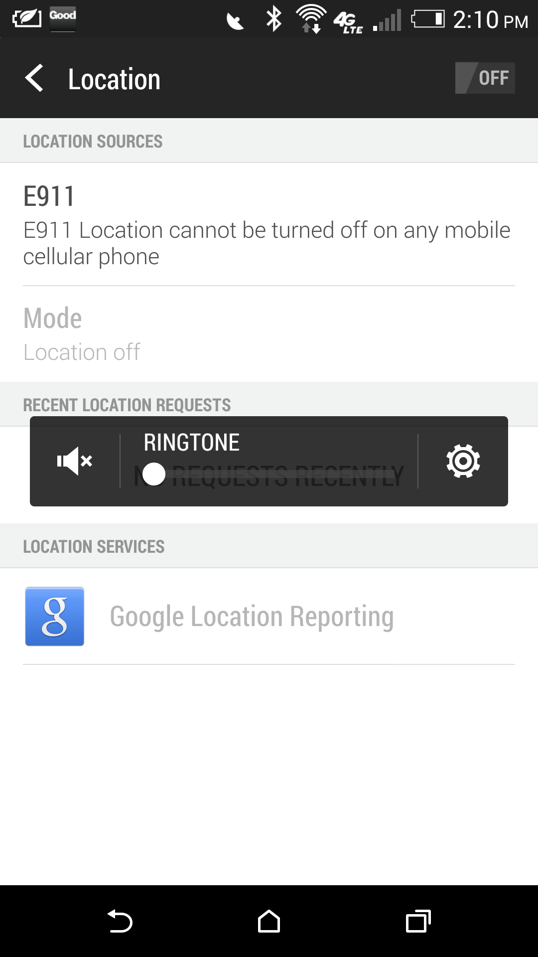

So no luck on the location reporting. In fact, I got so frustrated I disabled location altogether. But that didn't help either. What the heck?
A few hours later I noticed the icon came back on, with location still off

Could the E-911 service be the culprit? Being in Europe I'm not familiar with it... does it request periodic location updates?
You are most likely spot on. I work with E911 in an extended capacity and it uses GPS for all cell phone calls to 911. This is a requirement as many homes no longer have landlines.

AT&T released a new update and my issue has been fixed. This issue still bothers me though because one way or another my phone was connecting to GPS with location turned off, as seen in the above screenshots. This is where I delve into paranoia, but what if the fix was just to hide the behavior?
