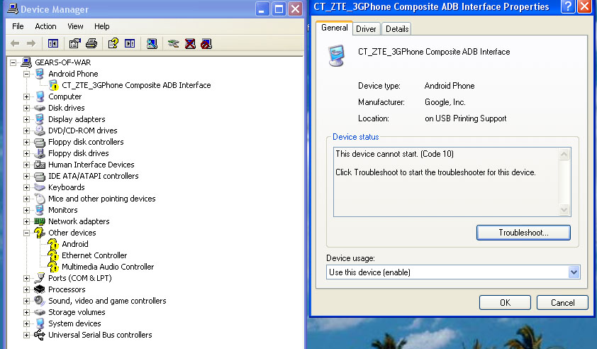

Thanks Junkie, brichster, I got the driver off the phone.
I held Windows hand, walked through finding and loading the driver, but maybe the wrong choice?
Not the right driver? Not working anyway.
What am I missing here?

OK, got it to work.
Had to connect as media device.
Thanks for the help guy's.
