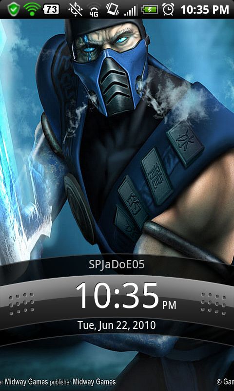

What to change the Sprint banner to something else?
Well here is how.

Select your port, hit connect, hit read... goto the NAM tab...hit Read ...change the Banner from "Sprint" to whatever..hit "Write".... then you can reboot the phone and its done.

Goto the NAM tab, hit read, change the banner, hit write. Reboot your phone
Enjoy!
