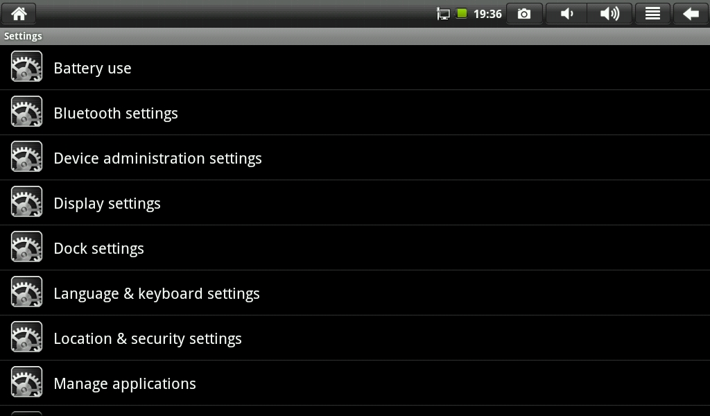

I tried rooting my superpad2 ft3 but could not locate development through the steps given above.Please any help will be appreciated.Here is the screen shot of my pad.Thanks all.

That procedure works for me...but I have Tims4e firmware installed...so I don't need to turn USB debugging on as the firmware roots the device anyway....the development tab missing is probably down to your firmware......

Thanks for your reply, I was woundering if i try installing tims 4e that way....dont know if Its gonna crop out bigger issues. Mine is 20110316.i'm kinda of new to android os though.thanks
You can read all about the custom firmware here Hybrid ROM (rooted) and make your own mind up but apart from cutting edge niggles I doubt you will find anyone saying its worse that the default firmware!!:D
