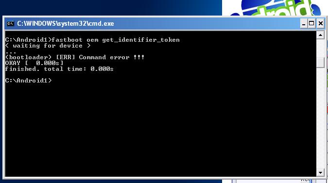

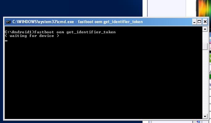

I am stuck on this part of the HTCDev. It doesn't work with my phone.
I also have no idea what a rom or ruu is. Something about updating the phone? So I skipped that and went down the the bottom of that page where you download bootloader (Hboot or something). And I just put that in my sd card. Could I be stuck because of my "ruu" and "rom"? I get to the bootloader page successfully though.
Also, if I press the power button on "Bootloader", this is what I get
Main question: Every time I try to unlock the bootloader, why do I get stuck at this point? I know some code is supposed to show up instead.
I think you’ve answered your own question:
I also have no idea what a rom or ruu is. Something about updating the phone? So I skipped that...

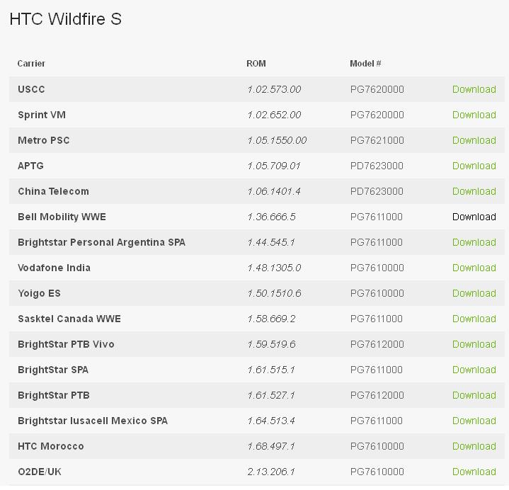

You must update your bootloader by downloading and running the appropriate RUU from htcdev.com. Make sure that you have completely and correctly finished step 3B before trying 3C. Step 3B is the key to the whole process.

To be honest, I'm really not sure what you are talking about.
1. Download the appropriate RUU from the list. It looks like you have already downloaded Bell Mobility WWE. Save it on your computer somewhere.
2. Connect your phone to the computer via the USB cable and enable USB debugging (Settings > Applications > Development > USB debugging).
3. Run the RUU from Windows and follow the instructions in the wizard.

I think there is an HBOOT update listed at htcdev.com for PG76120 (Brightstar?). If so, you could try to download it and run it or flash it using this procedure from the guide:
1) Run the RUU again and look for the temp folder it created, usually something like
C:\Users\[YourLoginNameHere]\AppData\Local\Temp\{82B23FCD-D5D0-45CA-A3A2-5350D3926551}
2) Find rom_02.zip in a subfolder of that folder and rename it PG76IMG.zip
3) Copy PG76IMG.zip onto the root directory of your MicroSDHC card
4) Shutdown the phone, pull and reinsert the battery and reinstall the MicroSDHC card
5) Boot into bootloader (hold volume down and press power)
6) Wait for it to load PG76IMG.zip and press volume up ("yes") to install
7) Shut the phone down and delete PG76IMG.zip from the MicroSDHC card
8) Boot into bootloader again and you should see ***_LOCKED_(OOW)_*** with a bootloader version of H-BOOT-1.08.0099 below. Move onto 3C below
