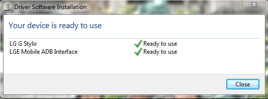

do you have usb debugging checked in developer options? what happens when you have the phone booted up normally and you plug it into the pc, does it recognize it?
im not sure what you mean about MTP check i dont remember seeing anything about that
yes the drivers i am using is from above link and I am using the united install.

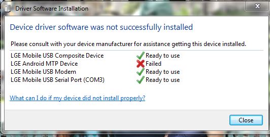

my problem is every-time i plug the phone to my laptop, windows 7 wants to re-install the drivers.
if i plug the phone after i have booted the phone regularly i get the pc reconizes the phone and i am able to read the phones data.[/url][/IMG]![]()
if i plug the phone in DL mode, the re-install fails
