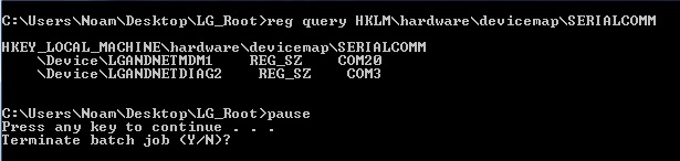

Step 5 now run ports.bat from withing the extracted folder, to find your correct port (use the one with: LGVZANDNETDIAG1)

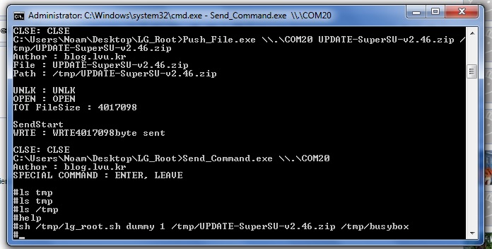

Step 7 run Push_File.exe \\.\COM11 busybox /tmp/busybox
^^^^^(place correct number after "COM" with no space)^^^^^^
it will then give you a message for example:
C:\Users\juan\Desktop\LG_Root>Push_File.exe \\.\COM11 busybox /tmp/busybox
Author : blog.lvu.kr
File : busybox
Path : /tmp/busybox
UNLK : FAIL
OPEN : OPEN
TOT FileSize : 1048328
SendStart
WRTE : WRTE1048328byte sent
CLSE: CLSE
Step 8 run Push_File.exe \\.\COM11 lg_root.sh /tmp/lg_root.sh (same deal as before)
Step 9 run Push_File.exe \\.\COM11 UPDATE-SuperSU-v2.46.zip /tmp/UPDATE-SuperSU-v2.46.zip
Step 10 run Send_Command.exe \\.\COM11
Step 11 type the following ls tmp which will result in:
#ls tmp
FAIL
#ls tmp
busybox
lg_root.sh
now Step 11 run sh /tmp/lg_root.sh dummy 1 /tmp/UPDATE-SuperSU-v2.46.zip /tmp/busybox

How do I find the COM #? Where do I find it?
This worked for me, thank you so much!
My phone (LG H443 got soft bricked from trying the (www.smartphoneclinics.com/one-click-script-to-root-lg-escape2-h443/) one click root thing.
I was freaking about and frantically searching for solutions as soft reset didn't work nor factory reset. Luckily I stumbled across this and it actually worked!
I actually just made an account to say this, and it might seem insignificant, but thank you for the effort you put into making this guide and fixing my solution. I hope you live a prosperous and wonderful life
I have same phone and tried to root it using same one click root too. I'm so glad it works with this phone. But how do I find the correct COM number for step 7? COM11 didnt work for me then i looked and it said to put in right one. Im guessing it's different for everyone, can you tell me where to find it please? Reply when you can plz and thx!
....the ports bat
....the ports bat
I had to download it again cuz i reset my computer a few days ago. When i open the extracted folder it says Ports not ports.bat. I open it and it says Error: The system was unable to find the specified registry key or value. I opened properties and it said ports.bat in name so i dont think thats why it says that. And I dont see LGVZANDNETDIAG1 ports that you said to use when finding my correct port. Now I can't put my phone in download mode, it just says Firmware Update 0% and doesnt even go up to 1%. If you have any idea why plz say. But If you can't then ill wait till hanakoisaqt. Since he has the same phone as me and it worked for him.
I made this account specifically to thank you. I used an old root method on an LG Escape 2 and soft bricked the thing, and I was going nuts thinking I would have to replace it. This fixed it, no sweat. For anyone in my position (stuck on LG logo screen) having trouble, here are some tips:
- Restart your PC after installing the LG drivers.
- Connect your phone to your PC and make sure the phone is in download mode. None of this will work otherwise.
- Follow the guide, step for step. You can highlight the commands in this guide, copy them, right click in the command window you're working in, and paste them there rather than retyping them all. Just make sure you change the COM# to your COM# (yours probably won't be COM11. Mine was COM4).
