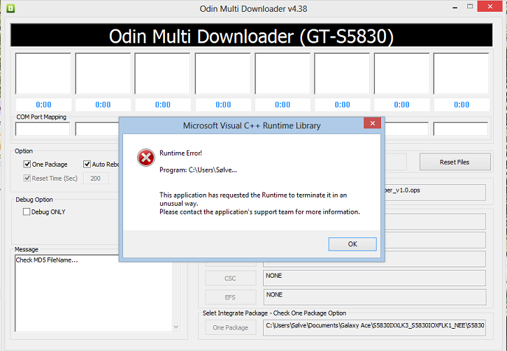

I need some help with this. Managed to soft brick my wifes old Ace, probably from following the wrong guide somehow. Anyway, I've read this guide, downloaded the files and all. But when I try to load the tar.md5 file in Odin, it crashes (see pic)
Any ideas? I'm running Windows 8 if that matters.

Its been a long time since i did this but i think you have to rename that firmware file to .tar, and remove .md5 from behind, i may be wrong though.
Also try with a xp or win 7 system, the drivers might not work with win 8.
According to the guide, the tar.md5 should be fine. I'm thinking the W8 is the more likely problem. Will have to try on another computer.
