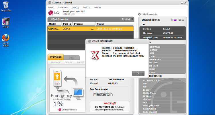

So I'm getting this error

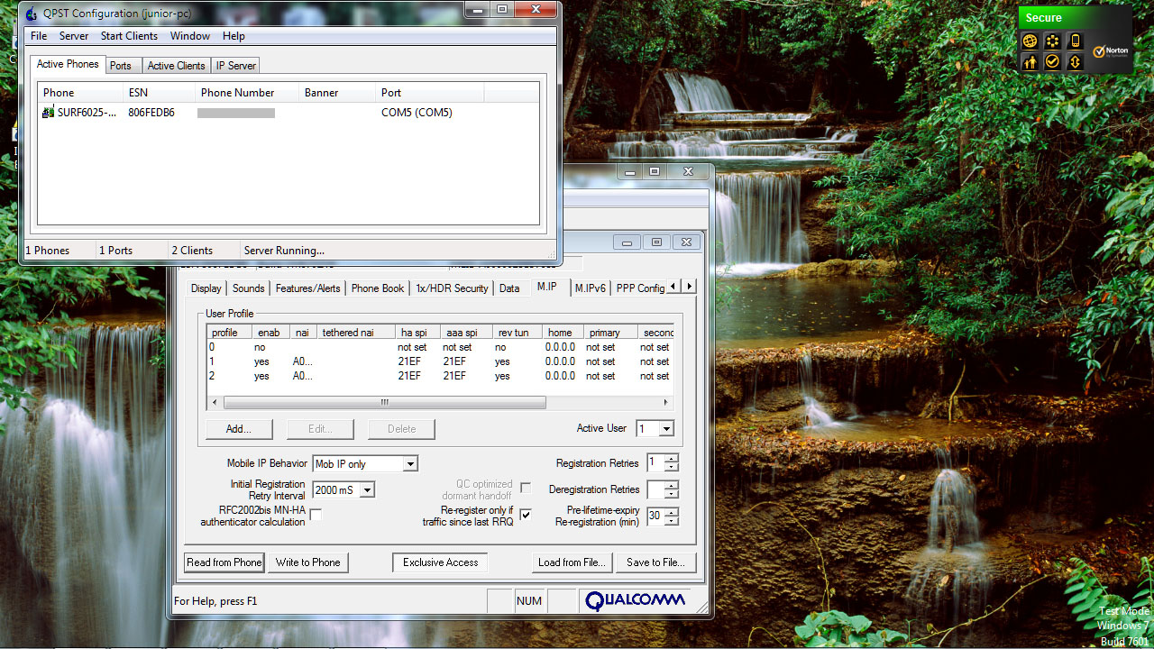

well... i think he probably posted the link i left in the prl update thread. it was just a link to the mdn/min/meid guide. can you open qpst have it read and post a screenshot of whats under the m.ip tab
Here is the screenshot
