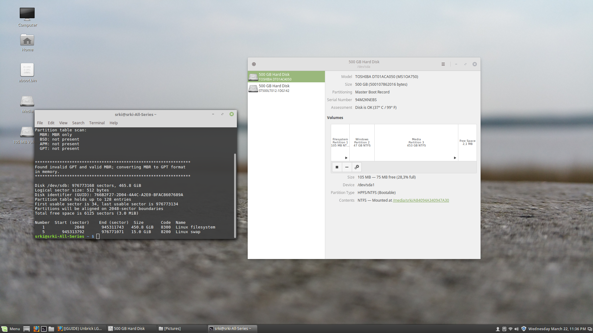

It doesn't show because the Mint is the newest version, so you have to find and install linux version with older kernel which will recognise the usb attached to them. For example: in Ubuntu 14+ versions my l70 wasn't recognised while it was in the purple screen mode, or just blinking screen!, but after installing Ubuntu 13 it recognised it without mistake, hence the image I attached few posts up.
So in order to see the parttitions you have to install older version of linux which has the old usb drivers and routinesin the keernel.
I installed Ubuntu 13 but it still didn't find the phone. I went to a local repair shop and the guy told me it's memory of something died. Just gonna let it go at this point.
