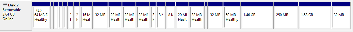

This is what i did in the working L70 and i got Loader.img but it is 168 MB and the partition on the phone is only 63.9 MB.
So I could'nt dare to do the flashing with 32diskimager. This is how phone disk partitions looks like in Windows.
