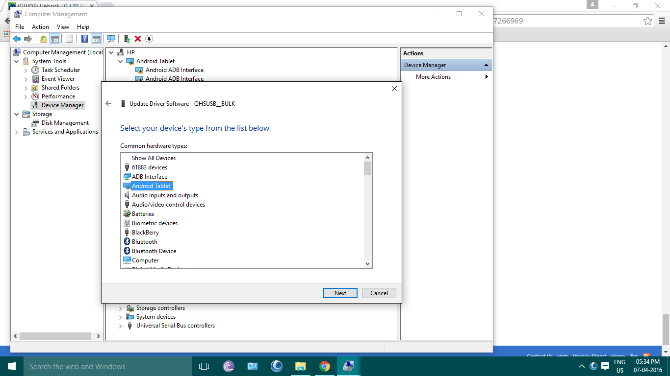

So I have correctly uninstalled all drivers and installed only google ADB drivers
I have uploaded a screenshot
My device is getting detected as QHSUSB_BULK
now plzz guide me what to aftr this
my phn is not getting detected as ADB interface or fastboot driver so I am not able to boot in to fastboot mode
when ever I am pressing volume up and Plugging the USB it goe to Purple screen and device is detected as QHSUSB_BULK
I just hope u got my not so lazy style of language...
Plzz help ya...

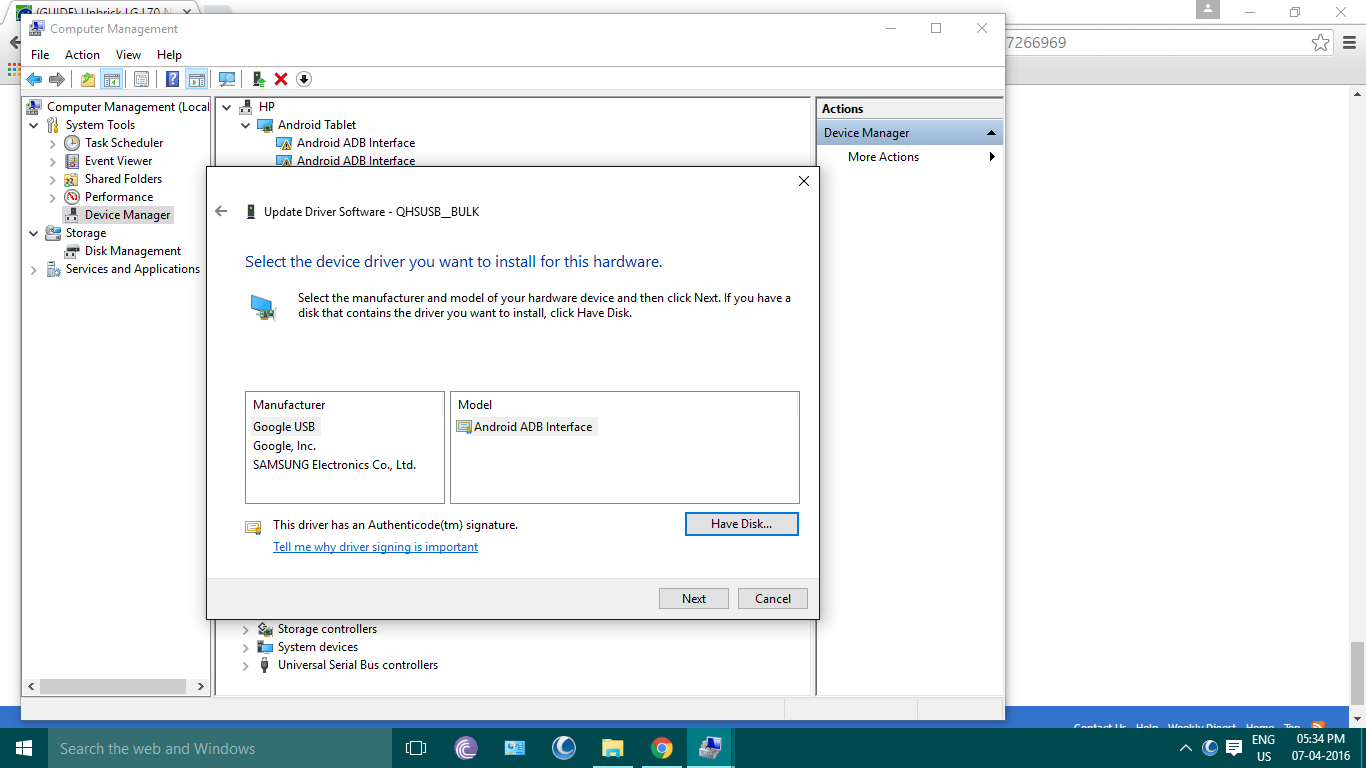

I am able to update my driver in Device manager
so I have option like ADB Interface , Android Tablet
If I chose ADB Interface or Android Tablet I am getting many option so plz have a look at the screen shots n lemme know...

n if I choose Android Tablet these are the options I am getting
plz help me which Driver should I install and proceed

Try to reinstall Google ADB drivers. Seems like your phone is in fastboot mode, in fact. You may need to manually select driver's path in Windows. This guide may be helpful: http://www.teamandroid.com/2012/07/30/how-to-set-up-adb-fastboot-with-android-sdk/3/
Here are the drivers: androidforums.com/attachments/adb-setup-1-4-2-zip.97905/
