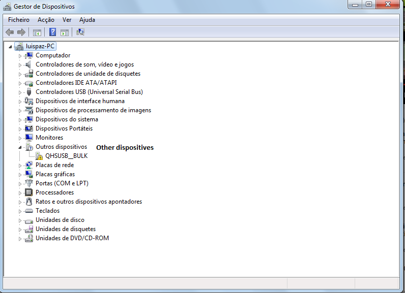

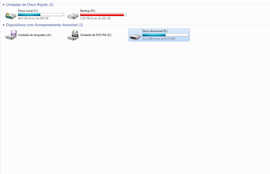

I have the same problem yet my phone has the demigod crash handler dbi err fatal and it has the same syntoms (no download mode,no recovery). If i plug it in (windows 7) it shows as a partition and if i search for an update for the drivers of qhsusb_bulk it searches for a while and then says it failed to find it. What should i do? Go into linux and try the way of this guide? Cause if i can get into download mode i probably can flash it. Halp :(
View attachment 100976 View attachment 100977 View attachment 100978

I have same problem, can't find qhsusb_bulk driver, can't see device

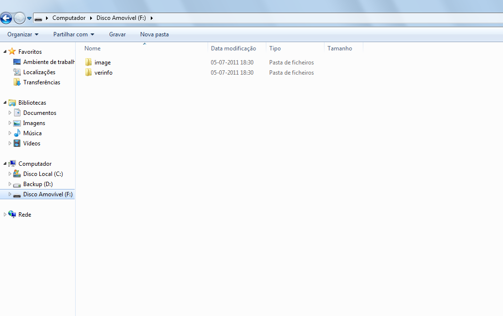

and same problem with "image" and "verinfo"

Like the other guys in this forum i formatted my internal sd card but windows still detectd my phone 'qualcomm hs-usb qloader 9008' mode.
For you with windows can't detect your lg i suggest install qualqomm driver.
http://forum.xda-developers.com/showthread.php?t=1669498[/QUOTE]
Some times you need 2 or 3 times plug in and plug out you lg usb untill windows recognize to our device.
