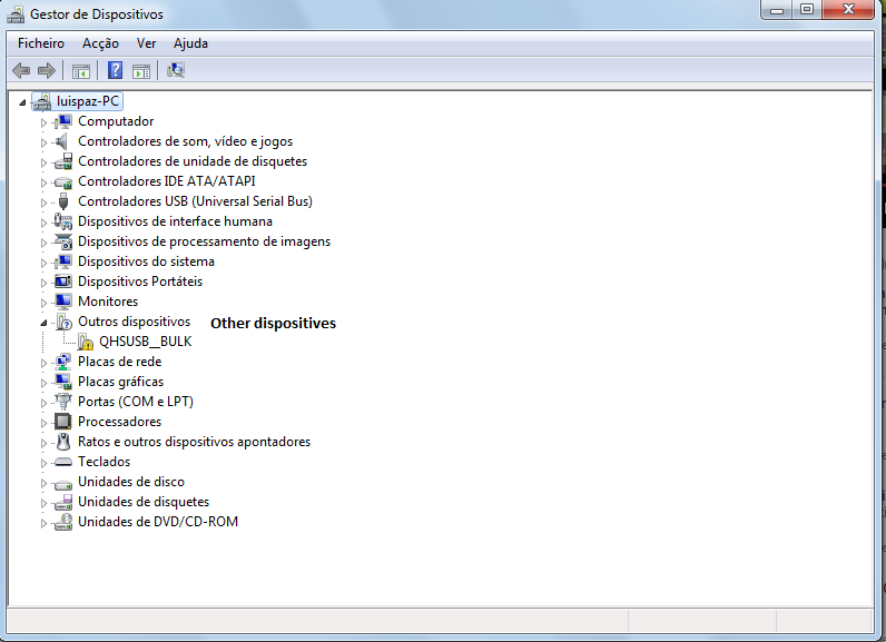

- When connected to a computer is defined as a device QHSUSB_BULK when installing the driver enters the name of the loader Qualcomm ...... 9008

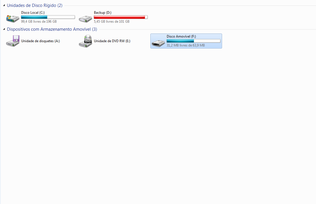

3) Download and unpack the archive Files Hard Unbrick SM-N9005 32 GB.rar
4) Take an empty USB flash drive company SanDisk Micro SD or AData and paste in CardReader, connected to a computer or laptop
5) Run the program DiskImageRev2.exe, the unzipped in paragraph 3
Now the drive letter under which decided Micro SD, as well as an image file click "Write". We are waiting for the end of the boot ... After about a minute to get a bootable USB flash drive recovery

7) Set up, if necessary, LG USB driver and connect the phone through the original USB cable to the computer in Download. After a few seconds, turn on the phone's screen

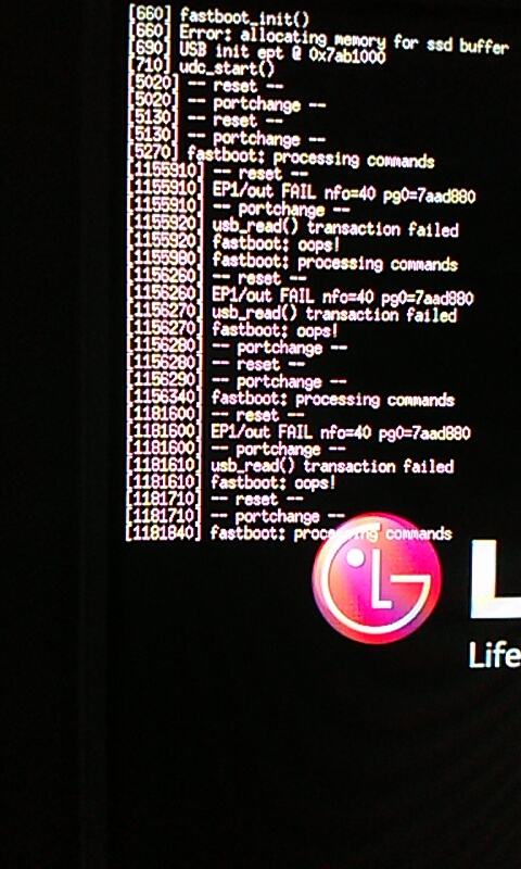

I followed step by step and purple screen gone! But now the device is stuck in an endless fastboot, I've tried many things, even restarted my research and so didn't work ...
Updated symptoms:
  • If I try one hard reset it hangs in the hard reset screen
  • It gets stuck in the Fastboot screen:
[720] fastboot_init ()
[720] Error: ssd partition not found
[750] USB init ept @ 0x7ad0000
[770] udc_start ()
[940] - reset -
[940] - portchange -
[1840] fastboot: processing commands​
Updated symptoms:
[770] udc_start ()
[940] - reset -
Updated symptoms:
[770] udc_start ()
[940] - reset -
