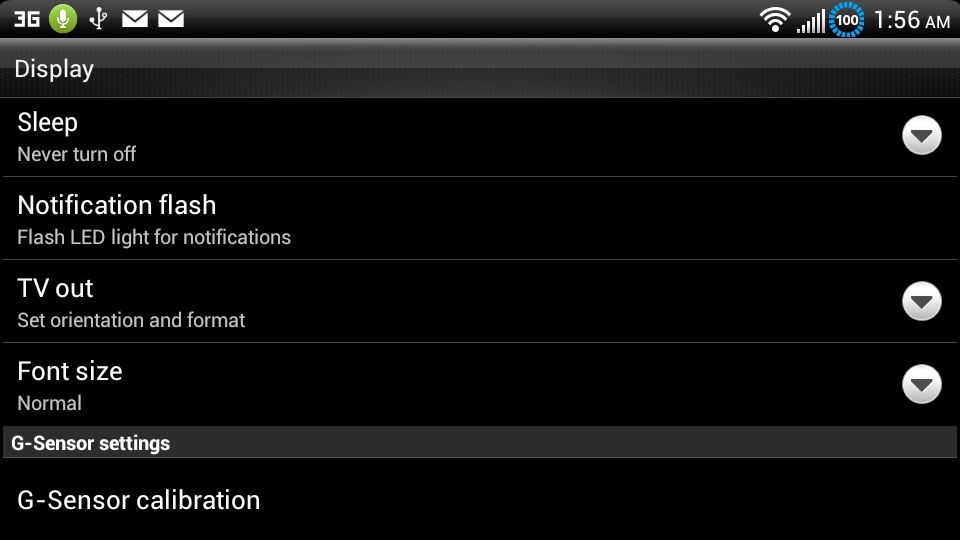

On Meanrom ICS 2.6 there are settings for TV out under the display options as shown in the attached screenshot.
My guess is that those options don't appear when the stock ROM or Harmonia are installed but maybe someone with one of those ROM's could check that.

Mobster HD doesn't have that option in Display settings.
Check again, I see "TV out" with those options under "Display" in the system settings in Mobster HD Lite.
Well, I downloaded both Mobster HD and HD Lite to satisfy my curiosity. ;)
Mobster HD Lite has the TVOut.apk and Mobster HD doesn't, which is consistent with what you guys reported.
I think it's safe to conclude at this point that MHL/HDMI will work with just the drivers that are included with the stock ROM, but TVOut.apk adds settings to manage it.
