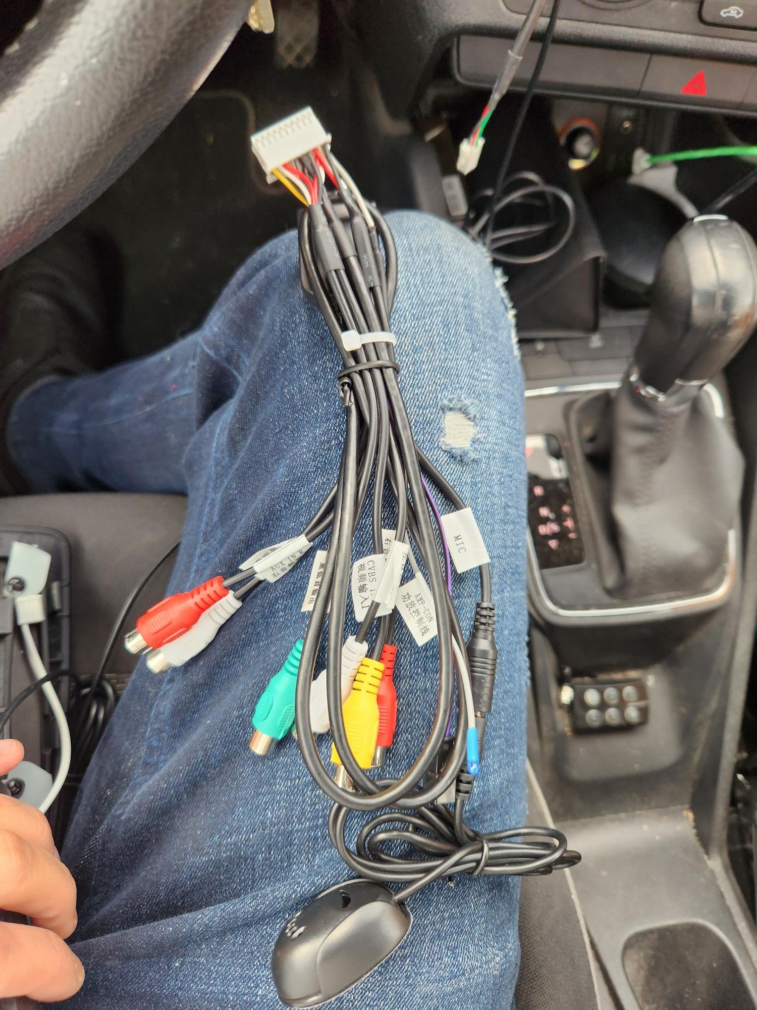

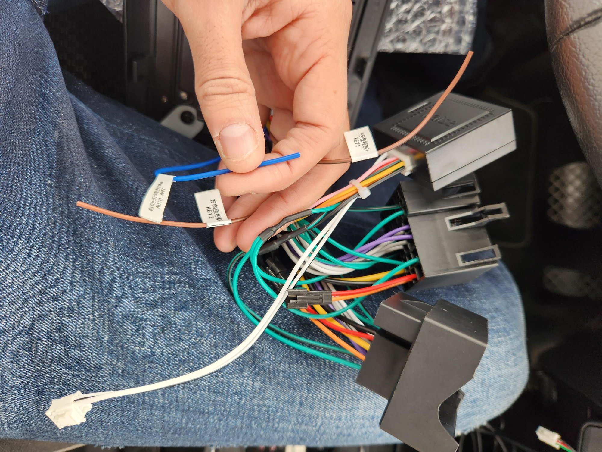

Hello friends,
Today I received the multimedia system that I ordered from AliExpress and of course the frame did not arrive compatible with the car (as I was promised),
But I improvised and managed to overcome it,
The problem is that I connect all the cables properly and the system just does not turn on,
Maybe I'm missing something and I don't know? I even tried replacing the fuse, but nothing.
In the video you can see everything, although in the video I only connect the power cable, but before that I tried with everything... the system should turn on even when nothing is connected except the power cable, right?
I would appreciate your help because I am at a loss and the seller is not really helpful..

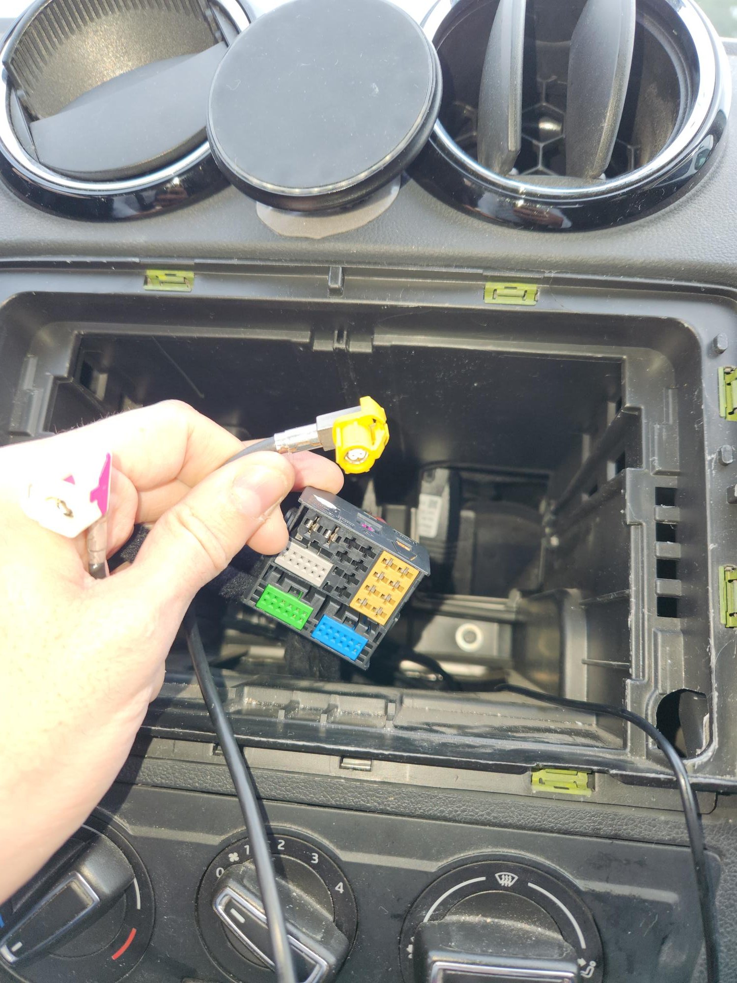

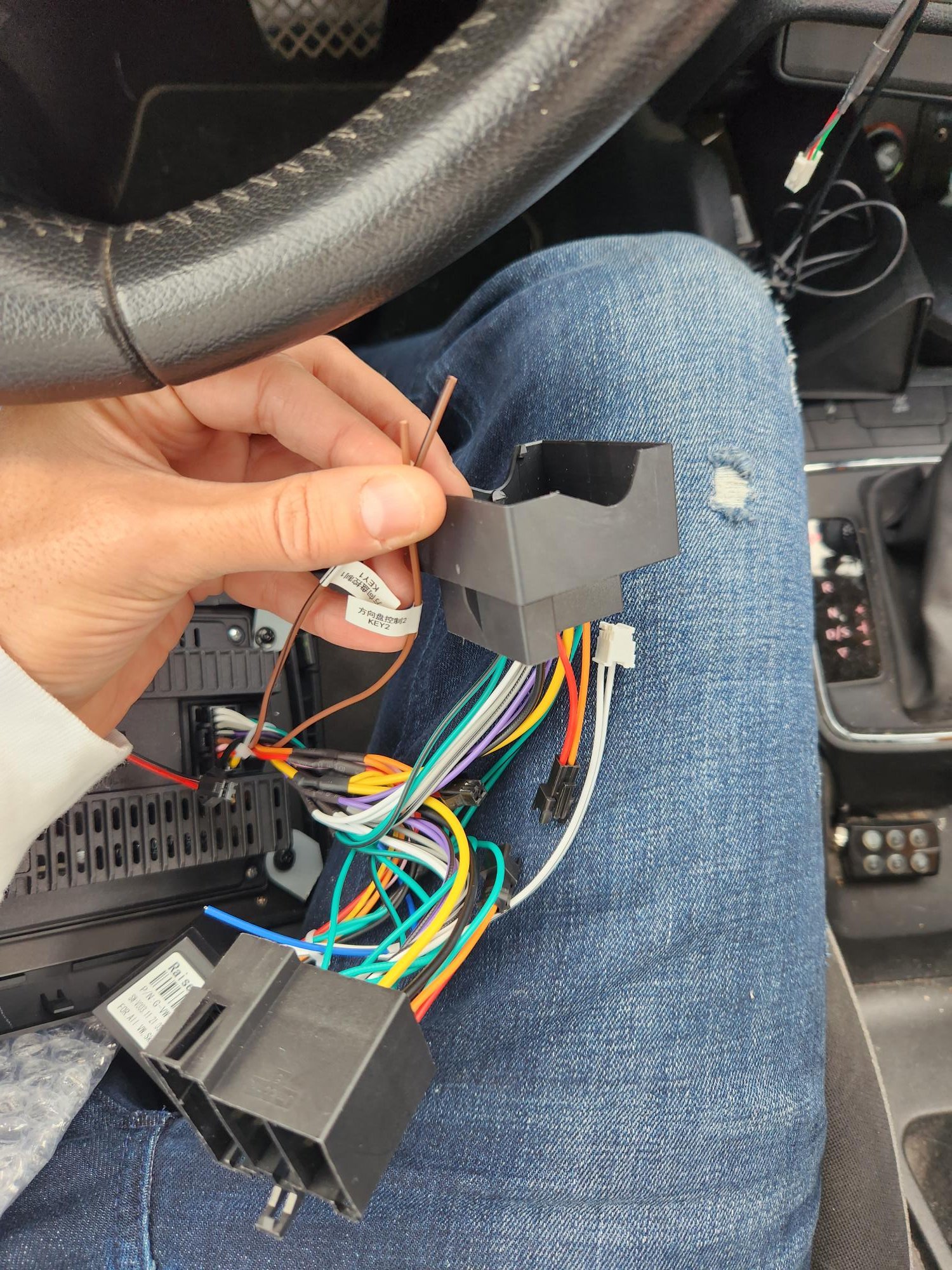

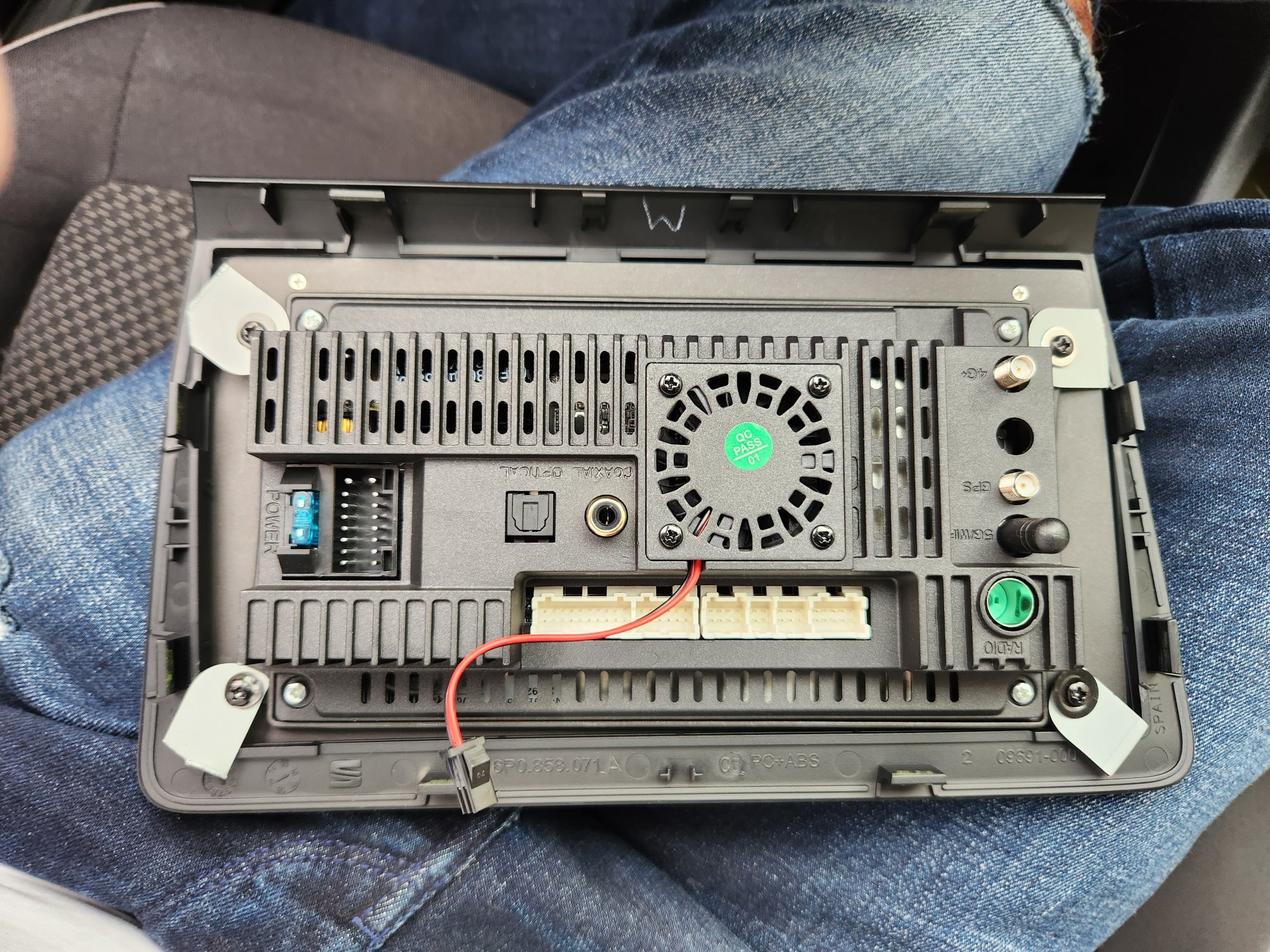

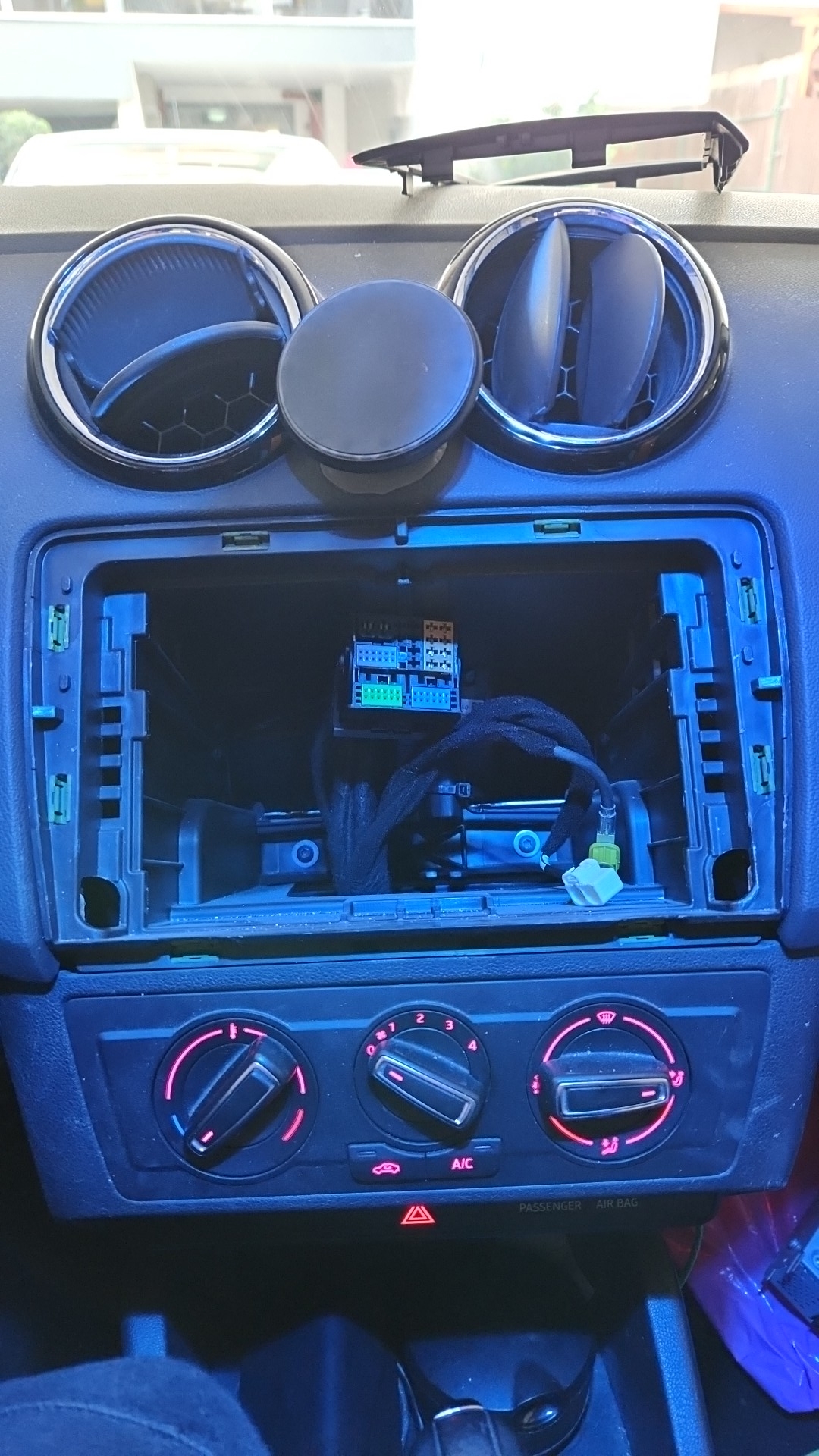

Check you've got the GROUND(might be black), CONSTANT/BACKUP(might be yellow or blue), and POWER(might be red) wires all connected correctly. FYI CONSTANT/BACKUP goes straight to the 12V and is always on, and POWER goes to the accessory position on the ignition, and is only on when the key is turned.
However if you don't have the correct wiring harness for the head-unit, I strongly suggest NOT bodging it in case it blows up, starts a fire, etc. As @ocnbrze posted have a professional auto electrician install it, or return it.

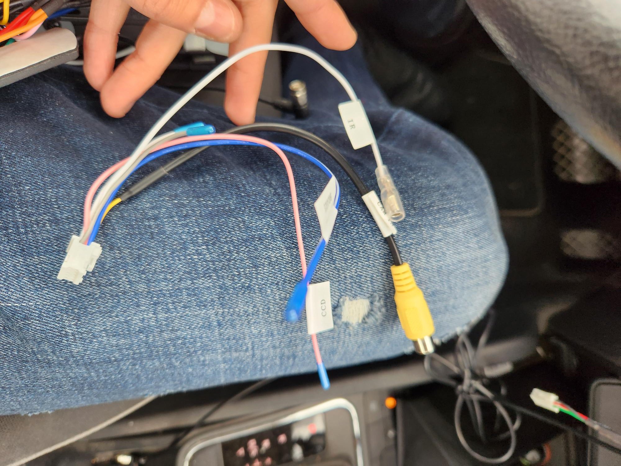

I have uploaded the pictures of the cables, I would appreciate a more specific direction regarding which other cable is responsible for giving power to the system
