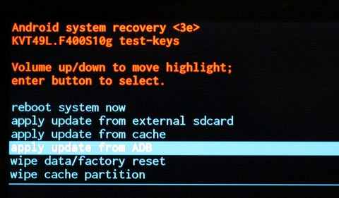

Help! Daughter's rooted lg ls885 only boots into Android System Recovery
cwiggam
Please help. I am a complete newbie to rooting. We used LG One Click Root to root my daugher's lg ls885 from sprint. We only did that to change one setting so we could use the hotspot for free. Anyway, yesterday, she did the android update for stagefright. Now her phone goes to Android System Recovery everytime she turns on her phone. I can get it to download mode. However, my computer won't recognize it as a phone. I have no idea what to do. Can someone give me step by step directions on how to fix this? I don't understand flashing or anything else so any help would be completely appreciated.
Thanks In Advance!

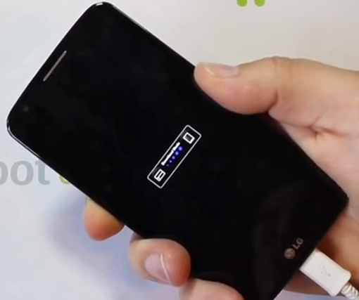

If it doesn't look like this than you're in the wrong mode.
Turn the phone completely off. Press and hold the volume up on your LG G3.
While still holding the volume up, plug in a microUSB cable into your phone.
Make sure the USB side is already plugged into the computer.
Then it should show the second picture then the first one. After that is done the drivers should start installing again & or the com port will appear.

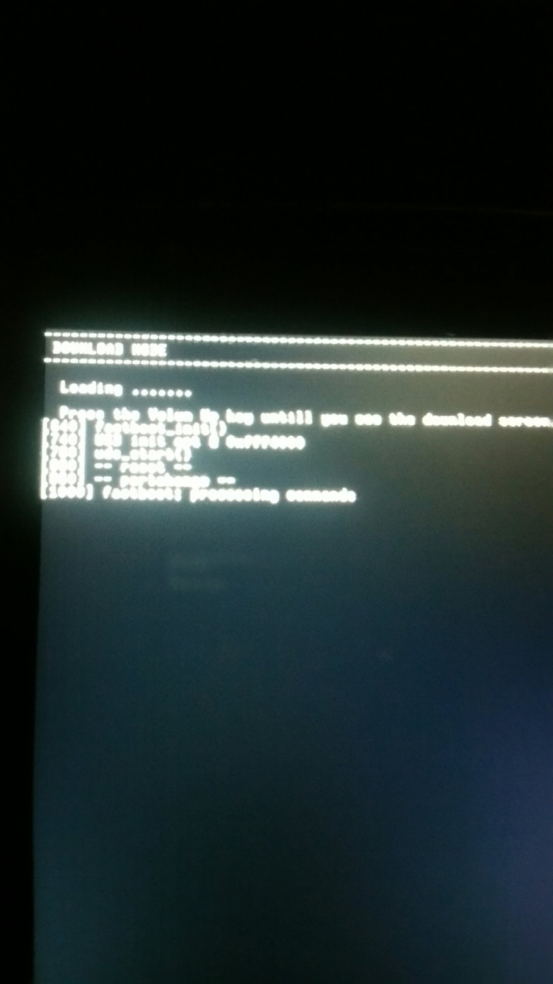

Sorry, last one. Here is what her phone looks like when we try to put it in download mode (only gets stops at Fastboot: processing commands)

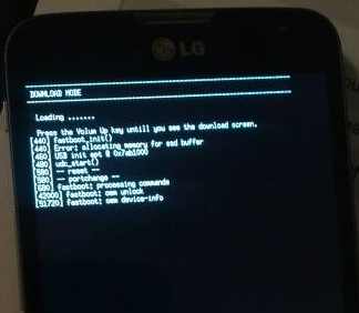

Ok. The problem we're having is getting the phone into download mode plus the computer still won't recognize it. Is there a way to sideload it? Here is the screenshot of the "download" mode that we can get the phone into. We are so stuck at this point. So there need to be able to get it to download mode or somehow sideload a rom
Sounds like you have corrupted partitions.
You would need to fastboot flash the partitions. Does it show
Qualcomm HS-USB QDLoader 9008 in device manager?
I can give you a basic run down on how to flash them or maybe Iowabowtech will be online and he can help as well.
