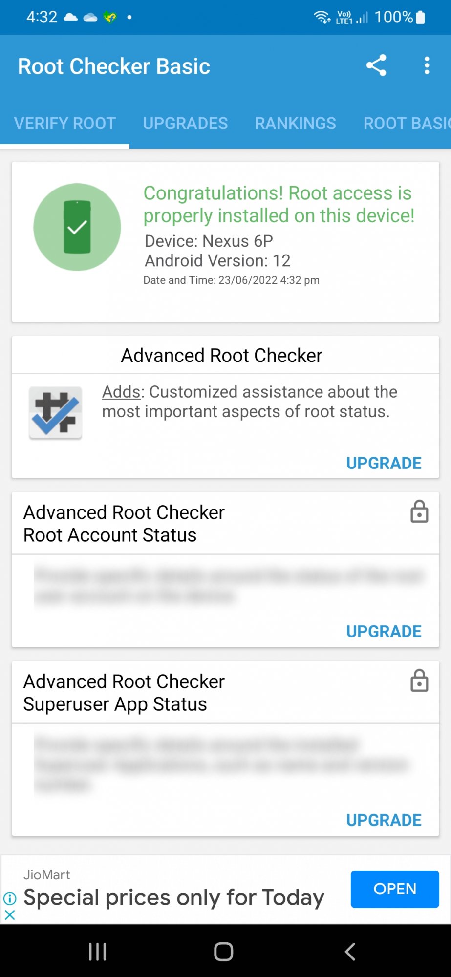

I am damn sure I'm rooted. I have checked through root checker. I am using magisk. I think my problem is related to RW permission. Do you know anything about it?

The app says it cannot gain R/W permissions, which implies that it requested them but could not get them. I assume you have granted root permissions to that app, in which case it suggests that the request could not be granted. I'd check its settings just in case there's something there to mount system R/W (I vaguely remember there being something in Titanium, but it's been years since I used that so can't be certain), but if it is that the app is asking and the system can't or won't grant it there may not be much more you can do from within android itself.
As I noted above, it might be worth trying ADB in recovery mode, since you definitely can write to /system in that mode. Heck, you could try using ADB when running Android - but if you do, reboot the phone afterwards to see whether it worked (if you can't modify the system it might still appear to uninstall but would "return" after a reboot).
Otherwise, for that particular app why not just disable it? It's not as if you'll gain any real space by uninstalling it (the system partition won't shrink, and that's where most of the app will be), and once disabled it can't run, update or anything else. I can see the point of uninstalling apps which the system won't let you disable (with due care that nothing depends on them), but there's very little gain from uninstalling if you can disable (apart from some personal satisfaction). And of course you should follow the first rule of root club: take a nandroid before making any change to the system software, including uninstalling system apps.
