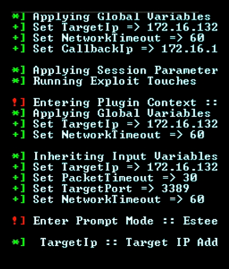

(please let me know if the 2 attachments are replicas of each other)

The reports were supposed to show me how close he was to cracking the code of the hack. He was So Close but he needed One More Tool to get to the bottom of it all and that was going to cost more money... Money that I'm not desperate enough to spend.
And, as far as my ex having any motivation to hurt me, he dumped me after 16 yrs and I'm left with all the questions. If anyone would be spying on the other it would be me. A I'm very confused...

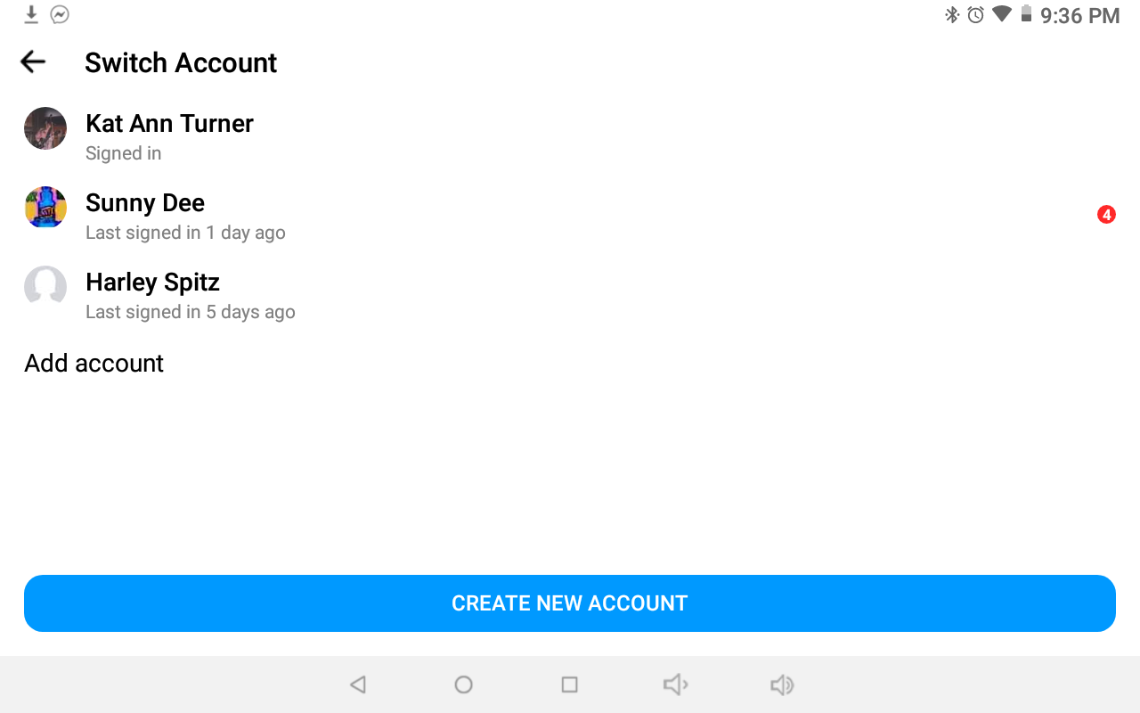

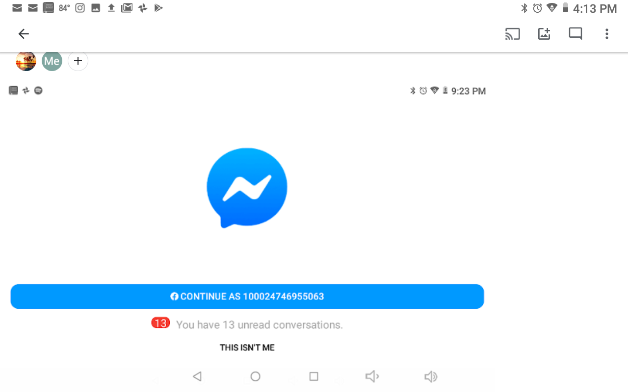

I DO wish I had found this forum Before I had hired the hacker. I'm aware that I'm not the sharpest knife in the drawer, so speak freely. No need to sugar coat.
The way I found this forum was by copying a line from the suspicious file and pasting it into my browser. The search first took me to Stack Overflow, GitHub, and some hacker sites. It wasn't until the 4th or 5th time I did that, that I wound up here.

Status update:
I have carefully followed the expert advice of everyone in this forum and it has brought me to a new realization. I ran the 2 files I discovered in my Google Docs through the website to which svim directed me and within seconds they were both determined to be without spyware or malware. (So why were they planted there??)
I have been barking up the wrong tree! My phone is not, in fact, the target as MB or svim (forgive me, I can't see the conversation from this screen) said earlier in the forum. After following everyone's advice I realized that it was my Google account that may have been compromised. So, I went on YouTube an researched what to do. After going into the 'Sign In and Security' section I was able to see what devices had been signed in to my Google account over the past week. Two of those devices I didn't recognize. So I found the IP #s of those 2 devices, one of which was a Google 'switch' and plugged them into a program that geographically pinpoints devices based on their IPs. (It might be called 'Checkpoint' but I'd have to backtrack to be sure. I found many after searching for 'IP Geography') That's when I recognized that someone I know is right now traveling the same area as the switcher. PA, DC, and Tampa. So that took my ex out of the equation.
Upon gaining that knowledge, I went in to change my Google PW once Again when I noticed the option to access other accounts tied to my personal account. It was then that I discovered a 'Brand' account attached. I have never heard of such a thing, but I could not access the account. However, the security question specifically named one of the 2 people who are making that particular road trip as we speak.
The security question is 'where did you meet _______________'(one of their names), but the name is spelled incorrectly so I can't know for sure which one got into my account.
All that being said, I still have so many questions. Especially motivation!
