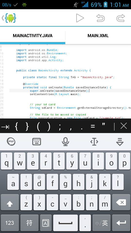

tried let me snd all the codr

Ok in your MainActivity.java change the following from...
Java:
setContentView(R.layout.activity_main);
Change it to this...
Java:
setContentView(R.layout.main);

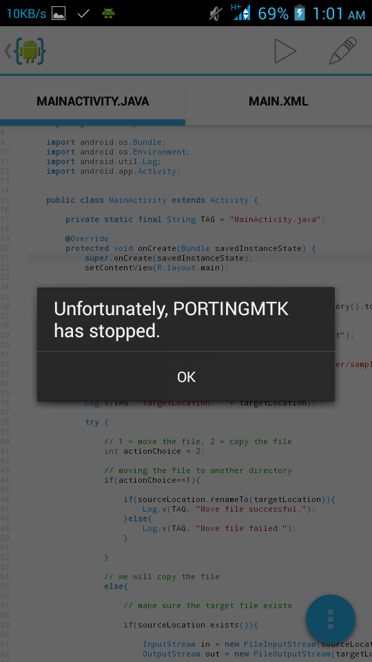

WHAT JUST HAPPENED
OwO
app crashes :-(
That's because the main.xml needs a proper layout for your MainActivity. If you switch it back to activity_main then your MainActivity will not have a layout.
Just to be sure. Is there a layout file called activity_main.xml?

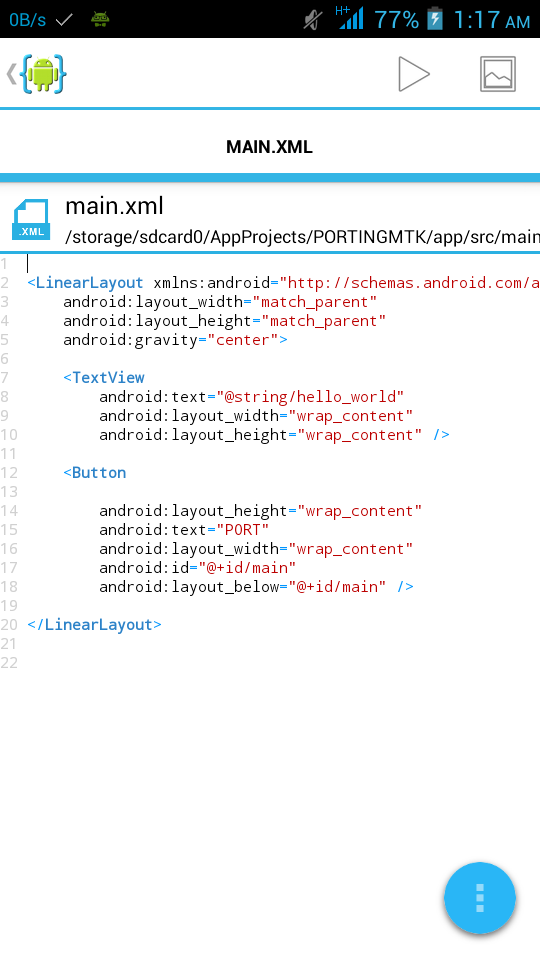

and see the pic too of how i change it too

Do you have a way of posting code instead of screenshots? Because it's gonna very hard for anyone to help you this way and gonna take very long.
Code:
<LinearLayout xmlns:android="http://schemas.android.com/apk/res/android"
    android:layout_height="match_parent"
    android:gravity="center">
    <TextView
        android:text="@string/hello_world"
        android:layout_width="wrap_content"
        android:layout_height="wrap_content" />
    <Button
        android:text="PORT"
        android:id="@+id/main"
        android:layout_below="@+id/main" />
</LinearLayout>
THE ABOVE IS MAIN.XML

and if uhave any code to copy file from one directory to another to zip and unizp files and also to copy folders i am ok
errors in pictures

Change your imports to this...
Java:
package com.speedevs.mtkporting;
import android.os.Environment;
import android.support.v7.app.AppCompatActivity;
import android.os.Bundle;
import android.view.View;
import java.io.File;
import java.io.FileInputStream;
import java.io.FileOutputStream;
import java.io.IOException;
import java.io.InputStream;
import java.io.OutputStream;
