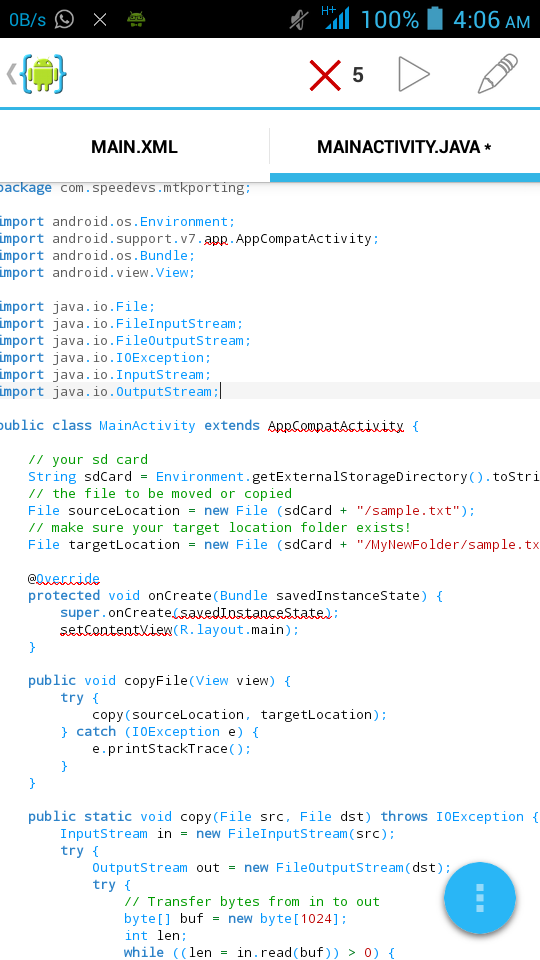

HELP IN CODING
Change your imports to this...
Java:
package com.speedevs.mtkporting;
import android.os.Environment;
import android.support.v7.app.AppCompatActivity;
import android.os.Bundle;
import android.view.View;
import java.io.File;
import java.io.FileInputStream;
import java.io.FileOutputStream;
import java.io.IOException;
import java.io.InputStream;
import java.io.OutputStream;

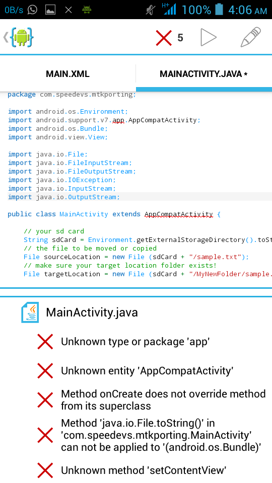

NOW me confused
Also your apps build.gradle file should have this dependency...
Code:
implementation 'com.android.support:appcompat-v7:28.0.0'
