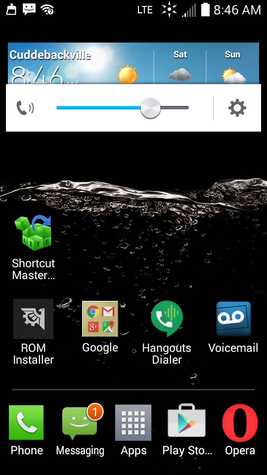

Screenshot_2015-03-20-08-46-28.png On stock rom try ##3282#
Scroll down to apn settings and click to open
You should see three dots in upper corner, click that and choose to restore default.
Reboot
Then ##UPDATE#
