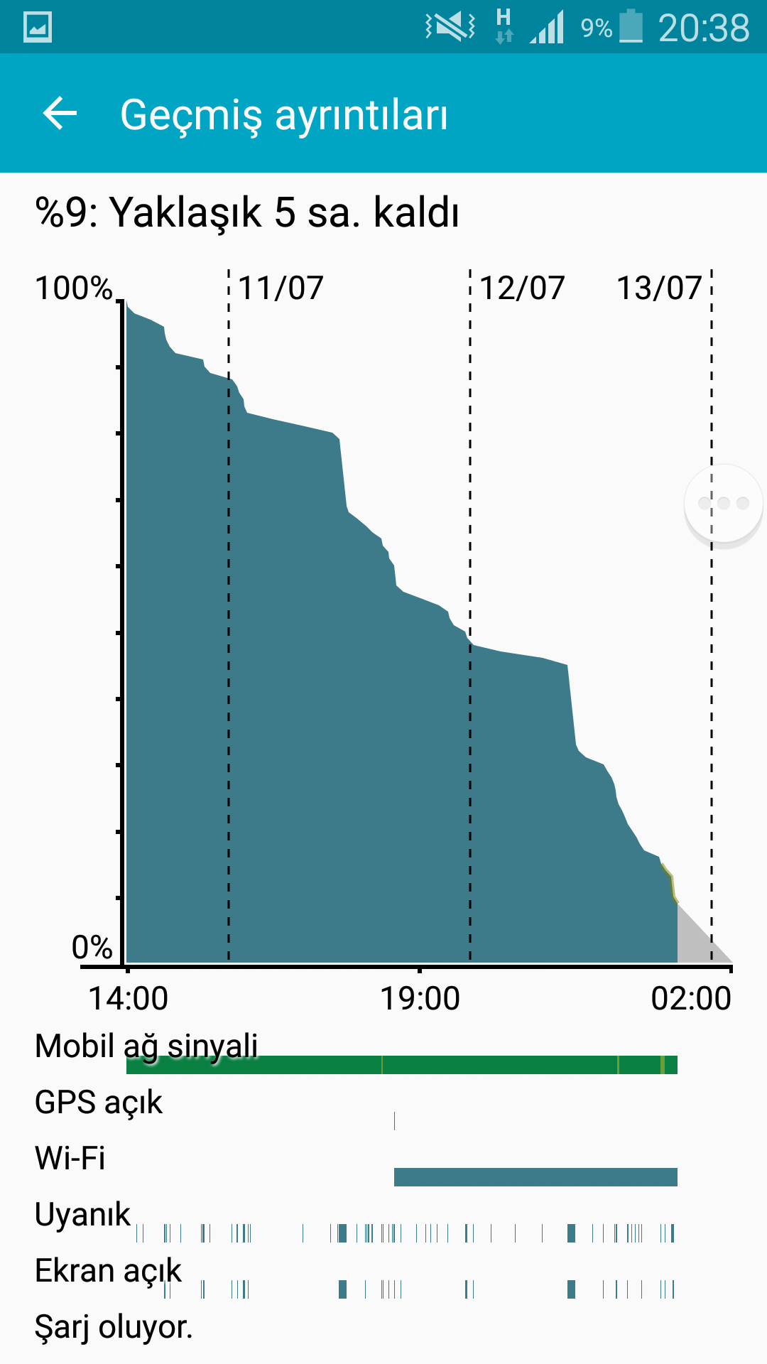

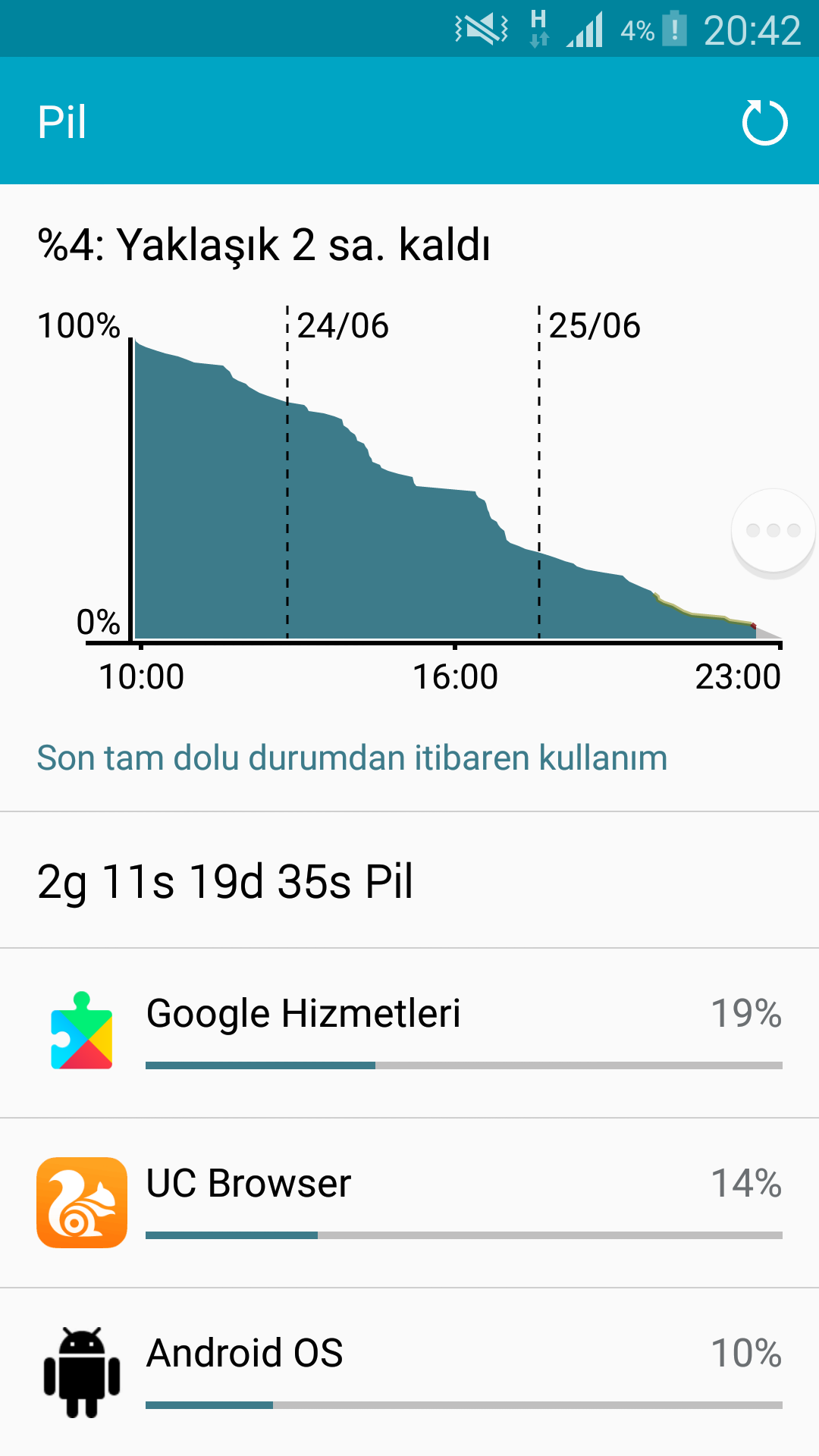

Hello. I'm having a trouble about battery draining caused by Google Services. It has been like this for over a month. I don't think it is normal. Do you have any ideas what is the problem to cause this? Thank you.

Did you update your system a month or so ago? Normall when this happens, it's something conflicting from an old version still hanging around in the system cache or something is stuck on. Try shutting the phone off, booting into recovery and clearing the system cache.

Yes, it was a small update, like a security patch I think. But I already cleared the system cache right after the update. Do you think doing it again may help?
If the problem showed up after the update, and you've already cleared the cache once, it probably won't fix it, but it couldn't hurt.
Try looking at your Google account and see if any of the sync options are stuck. I had high usage and battery drain and it was because for whatever reason my contacts weren't syncing and the phone just kept trying. Everything else was syncing fine, just the contacts. I just just shut off contact sync and the problem went away.
Didn't help. Thanks though.
If all else fails, try a factor reset. Of course, back up all your important data first.
Didn't help either, still thank you.

Nope, the sync options fine. I tried both disabling all together in case they drain but didn't help. Thank you too.

The top screenshot is more successful than the one below. You did something right. Always turn off Bluetooth, WiFi & Location if not needed.

Actually it got worse because the top screenshot is an earlier one. The phone is behaving crazy after an software update, it is overheating and the battery life is mediocre. It's became probably the worst phone I've ever owned.

It works unreliable in my case. For instance I put IMDb app to whitelist but it is still unable to connect to internet as if it is not in whitelist. I think it has to do with Google apps because I did not allow to add any Google apps to whitelist. I probably should mention that I put Doze in aggressive mode (always active).
By the way, sometimes Google services drain battery up to %20 and at the same time, Whatsapp drains over %15. Two of them almost drain %35 to %40 of my battery! I barely use Whatsapp when this happens. Why is this happening?
