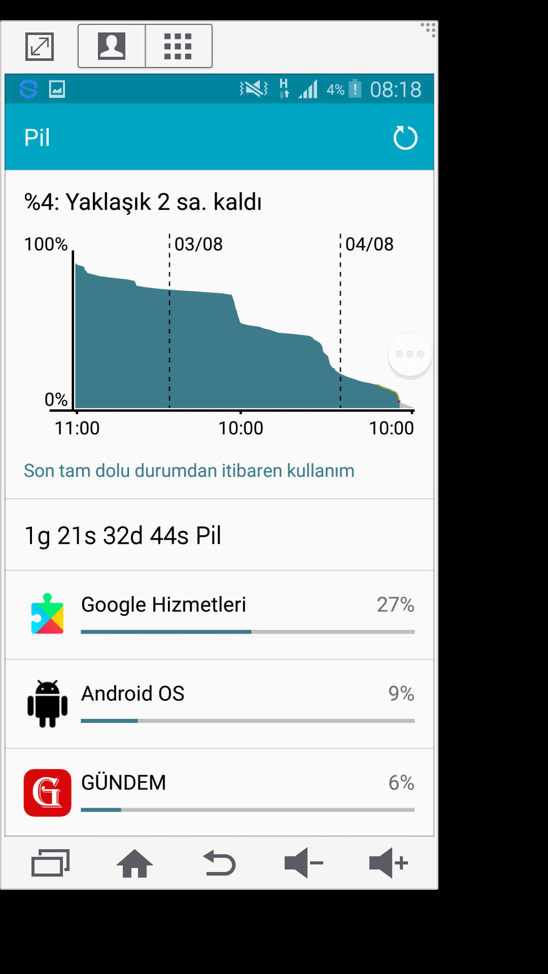

By the way this is the new record of battery drain by Google services:
After having deactivated Google Services, uninstalled WhatsApp and stopped to receive news apps' push notifications, there are no battery drain caused by Google Services and Whatsapp obviously. But now, "Cell Standy" (I don't what it is) supposedly drains the battery. At %70 battery left of the phone, it drains %17 for now. "Device Idle" at %1. Is this wrong or normal??

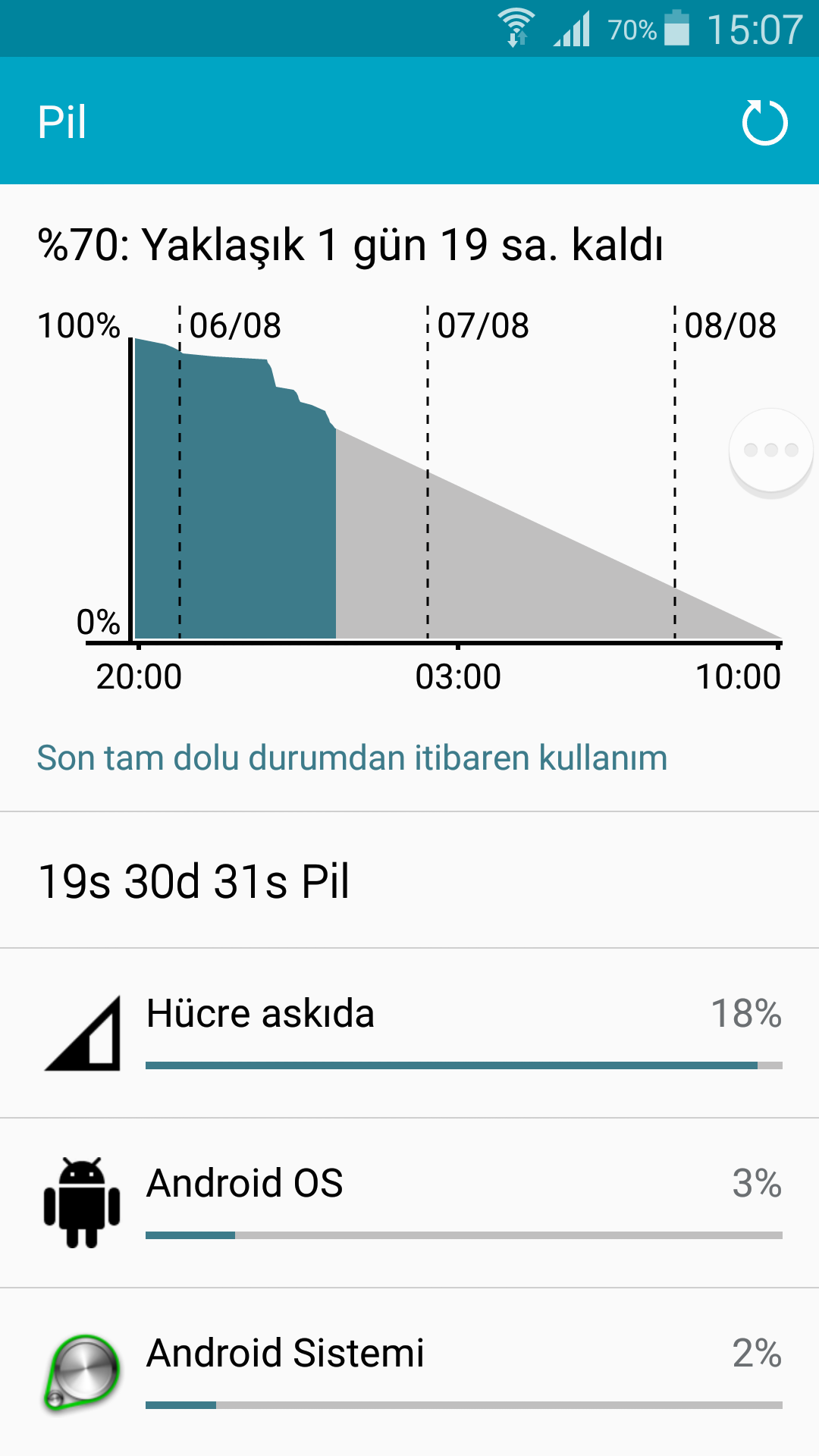

It seems turning on airplane mode did the trick because I haven't see cell standby in the battery statictics for over six hours. Of course this is with no Google Play Services, no Play Store, no Whatsapp. I'll deal with them later after fixing this one first.
Is there a fix though? I've been googling it for hours but couldn't find anything useful. I would like to turn on cellular radio all the time as I want to able to receive calls all the time and not lose excessive battery power as before (before I mean this phone used to last almost four days)

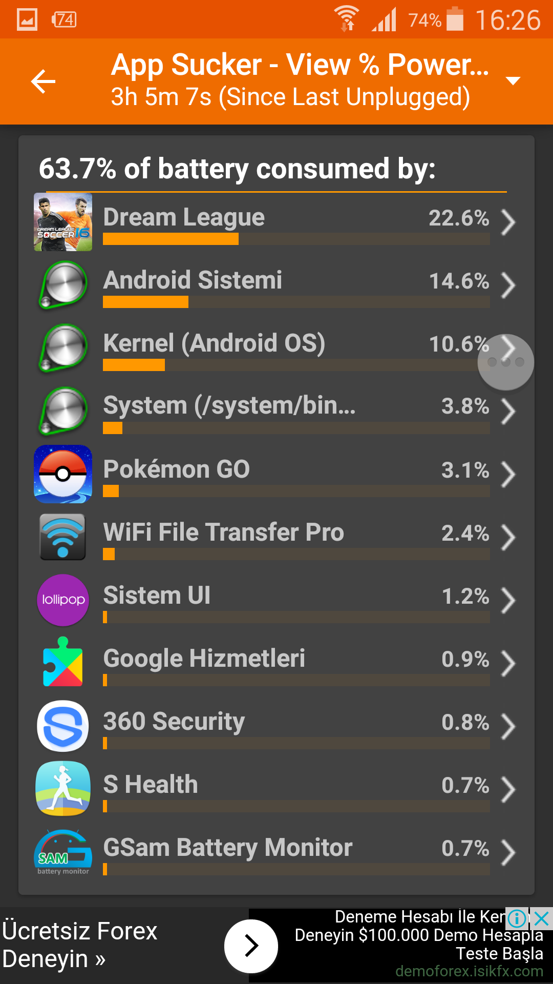

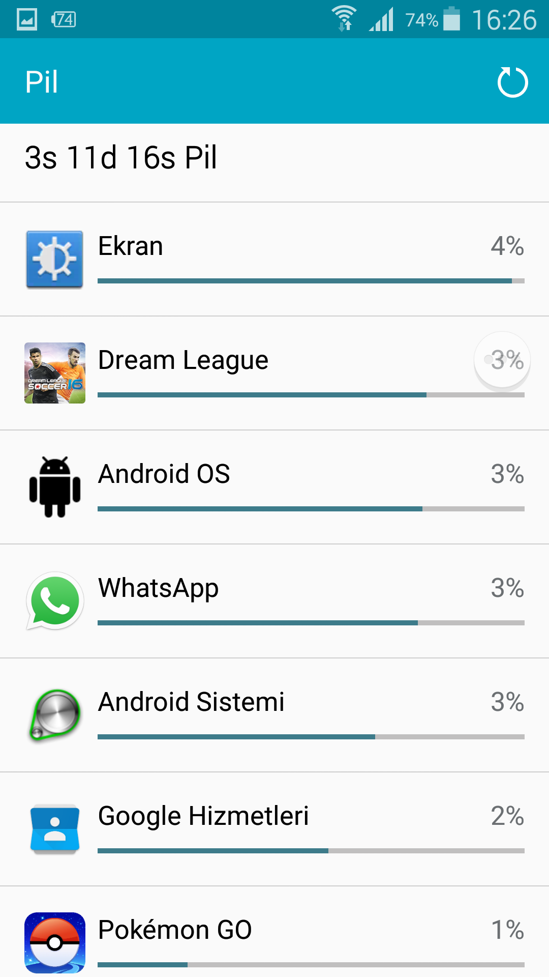

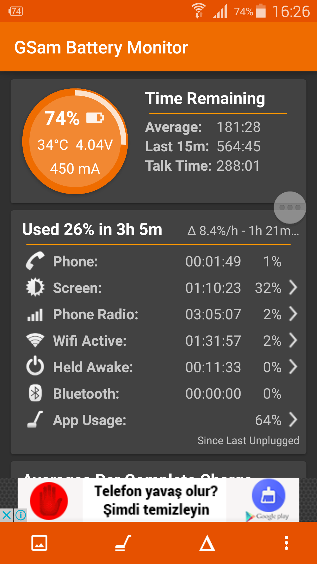

I don't know it is a bug or something else but it is clear that the built-in battery statistic reports wrong.
See the difference between GSam Battery Monitor and the built-in battery statistic:
Screenshot_2016-08-13-16-26-27.png Screenshot_2016-08-13-16-26-38.png Screenshot_2016-08-13-16-26-55.png
View attachment 108384 View attachment 108385 View attachment 108386
