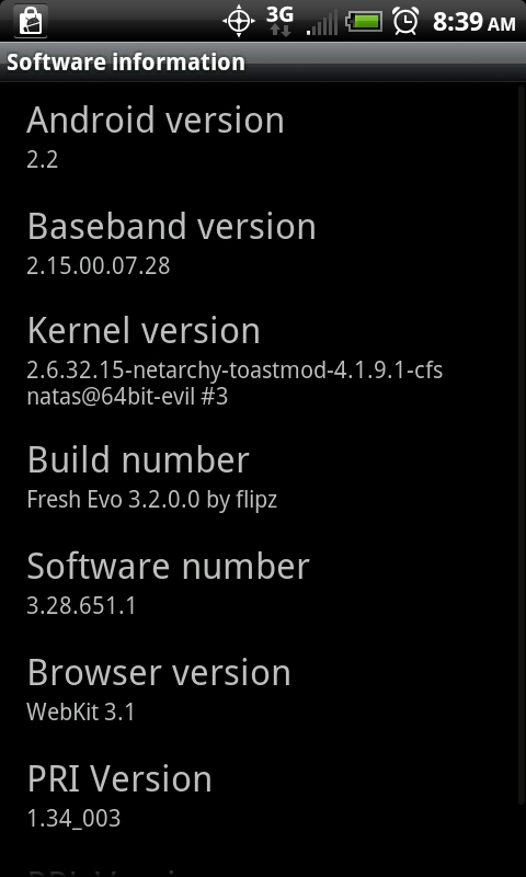

Hey guys, I am getting some serious battery drain with Fresh 3.2 and netarchy-toastmod 4.1.9.1 cfs ( i have also used the stable 4.1.8) and I am getting serious drain.
Here is a screen shot from today. Unplugged phone around 7:30 and by the time I took the screen cap at 8:30 i was down 25%!! I used the phone to RDP to my house for maybe 3 mins (using pocket cloud app).
I also played 1 youtube clip ( katy perry on sesame street XD~~ 1.:30 mins long) Thats all I have done so far.
Do you guys think I should try a different combination? I pretty much have everything turned off on the phone. No GPS, sync i think every 4 hours. Using launcher pro, and beautiful widgets.
Thanks, BetaC

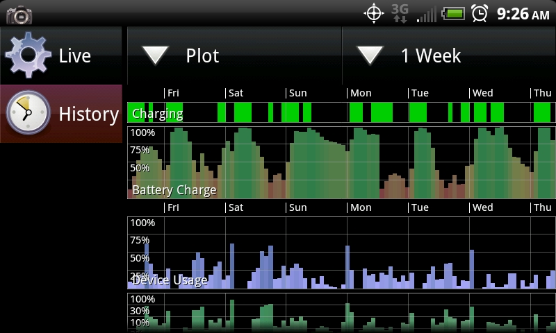

25hrs!!! WTF. I am lucky if I get 7. I dont get this... could it be hardware related?
I have setcpu and have all the same profiles. I posted a picture of my system panel week long view. Its ridiculous. I have 2 batteries both are just as bad.

First thing i would do is fully charge your battery and when you go to bed unplug it, turn on airplane mode and see how the battery acts. Also what us your up time v awake time. what are you account sync settings, does facebook do background updates? are you auto logged into gchat? have you calibrated your battery?
also if you use 4.1.9 w/ havs you need to disable all profiles
