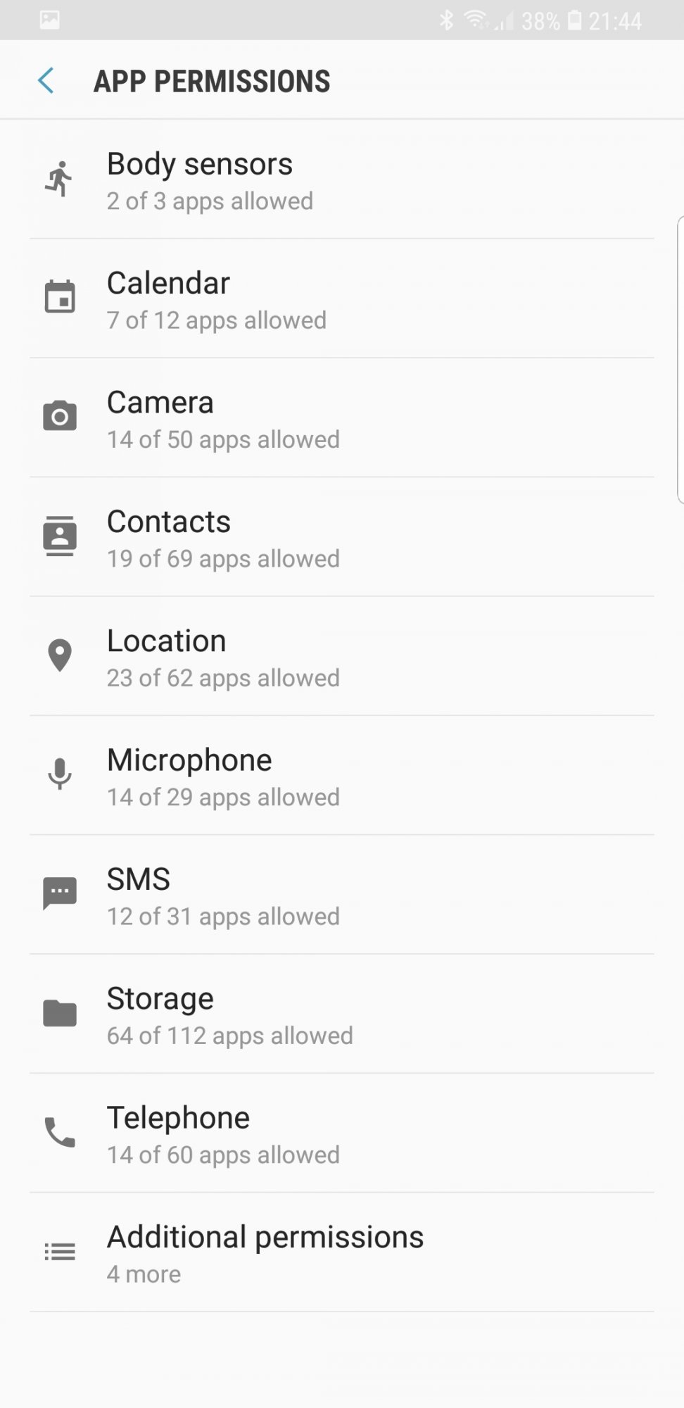

You can take a look at valid apps from within the setting page under apps, options button and app permissions. Then pick the mic permission to see what has access to the mic with handy toggle buttons to switch off that permission per app.
Check the attached screenshots. (Your settings page may look a a little different.)

Ok, I found the list of apps that have permissions. I do not get why some of them have those permissions. But i will go through them to see what might be occurring. Some fo them i get. Voice recorder, for example, but that should only access the mic when i activate it. Now that i have a list of apps, how do i find out which one is triggering the logged entry of a mic recording?
Upvote 0
I think i have figured out what is going on. Apparently Wiretap detection does not clearly differentiate between a call being recorded and a mic recording. I went through the permissions and disable use of the mic by apps that do not need it, in my opinion. Apps like S Note, for example.
I started looking at the time the recording are reported and compared them to my phone log. Some of the calls i make are reported as "possible hidden calls." some of them when i get a call are reported as "A mic recording was detected." Some of them are reported as a "Call from 12345678910 was being recorded." It appears that all of these coincide with a call that i was on. I did not know that initially, because some were reported as calls being reported and some were reported as a mic recording. Technically all are mic recordings. Now i know to look at my call log whenever a new log entry is entered to see if it coincides. I guess i should not be concered unless i get a notice when i am not on the phone.
