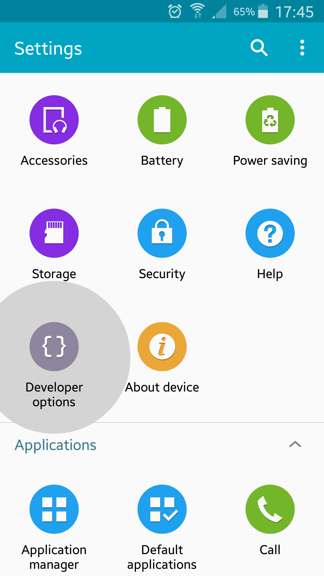

I'd now like to get rid of the developer mode and turn off usb-debugging. I'm just not sure what will happen if I turn off de-bugging, and I also have no idea how to get rid of the develeper options tab in my settings. Do you know the easiest way for me to do this? Also, once had un-rooted, I uninstalled SuperSU and I also used root checker to make sure and it said my device is not rooted.. which is perfect.
This is what I'd like to get rid of..

I would not worry about USB de-bugging or Developer options, they can prove very useful.

I'm worried about the developer options cause I'm scared I'll click something by accident or It'll change things on my phone?
If the Developer options did not disappear when you flashed a stock firmware then I know of no way of reversing it short of possibly a Factory Data Reset.

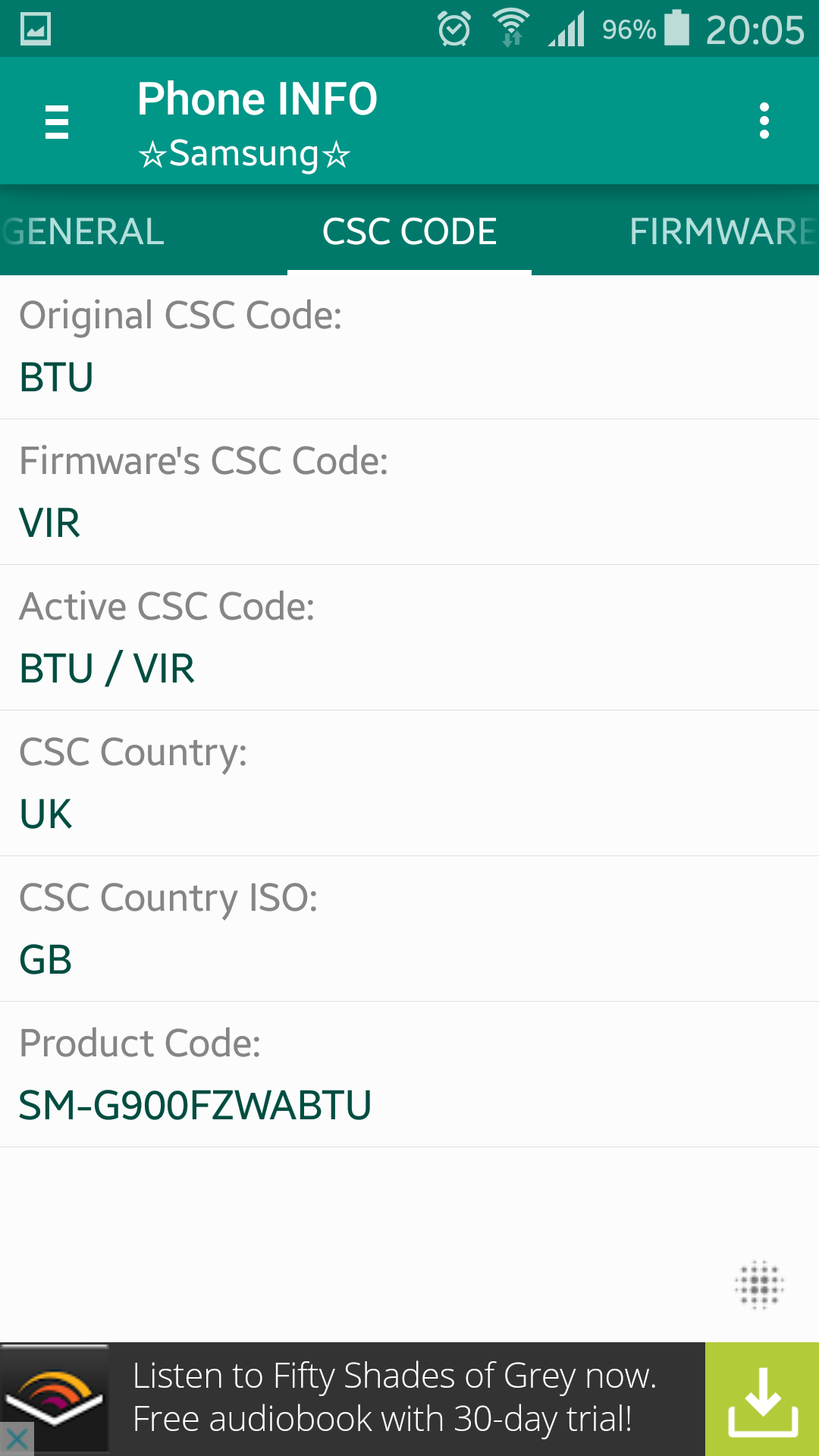

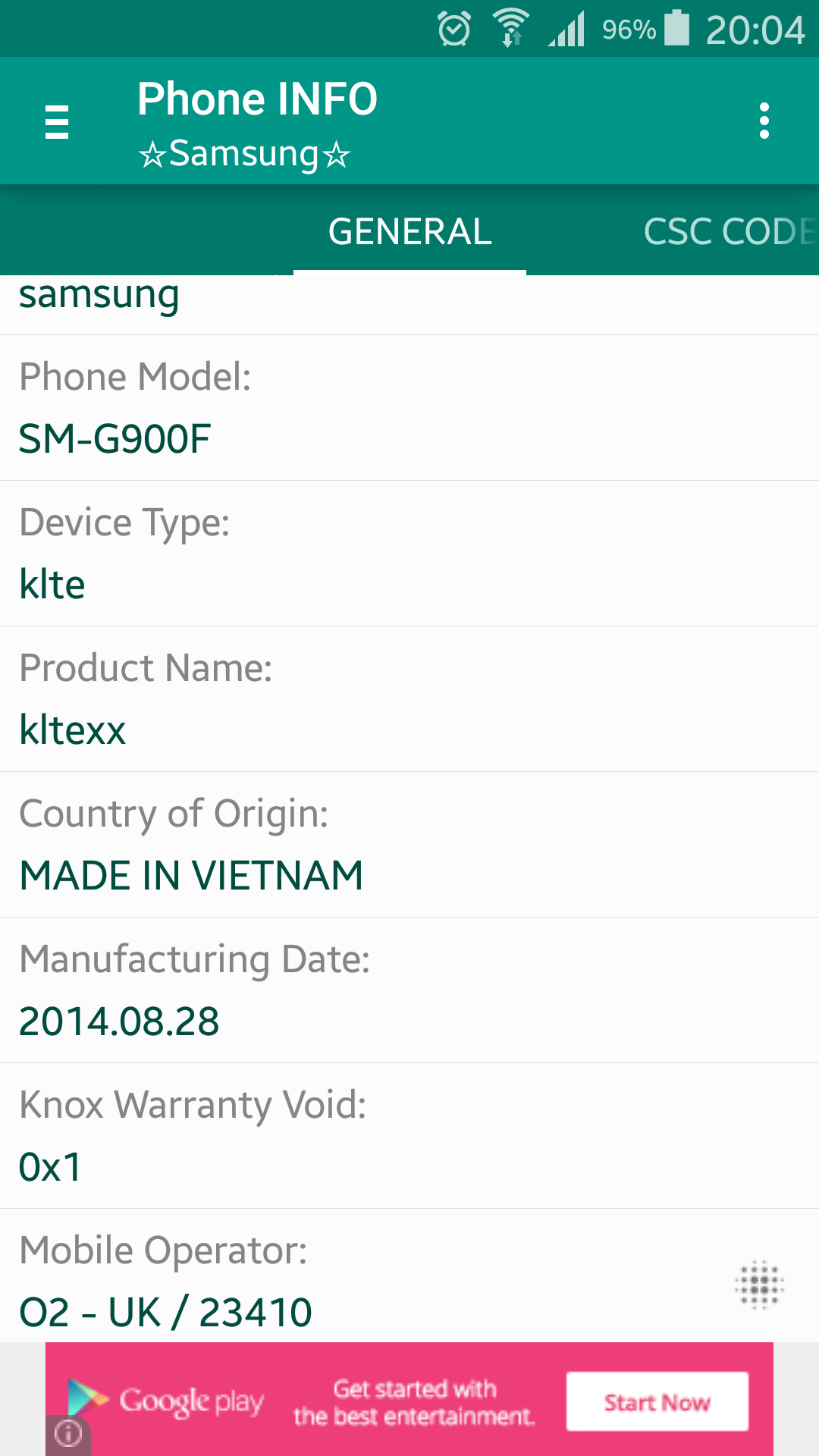

Install, Phone INFO ★Samsung★, free from the Play Store. Under the heading, "CSC code", does it say, "Original CSC code", is, "BTU"? If so, stay on the firmware you are on.
I'm so sorry, I know people like me must be your absolute nightmare! I promise I'll never do something like this again lol. I'll do that now and get back to you. Thank you so much for your help and patience :(
I've screen grabbed both the first tabs you'll understand them more than me.
