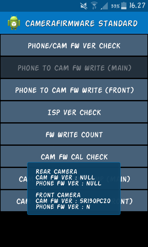

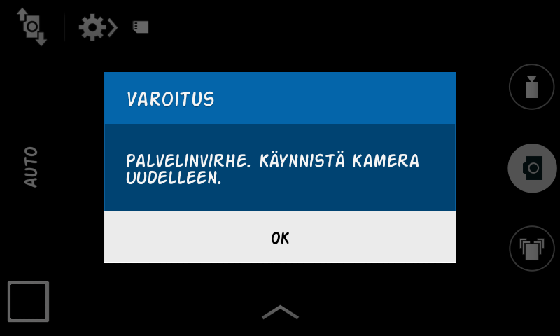

I have same a similar prob with my Galaxy Ace 4: My selfie camera is working but my main is'nt: When I try to open it it says: Warning! Server error. Restart your camera. I alreagy did everything suggested: Update your device, safe mode, turning device off and on, putting phone back to factory settings, emptyinf cameras data, forced to stop the camera , even got it for fixing but they said thet couldn't find any prob. Also here's a few acreencaps: (My phone version is btw. 4.4.4) So i hope u can help
