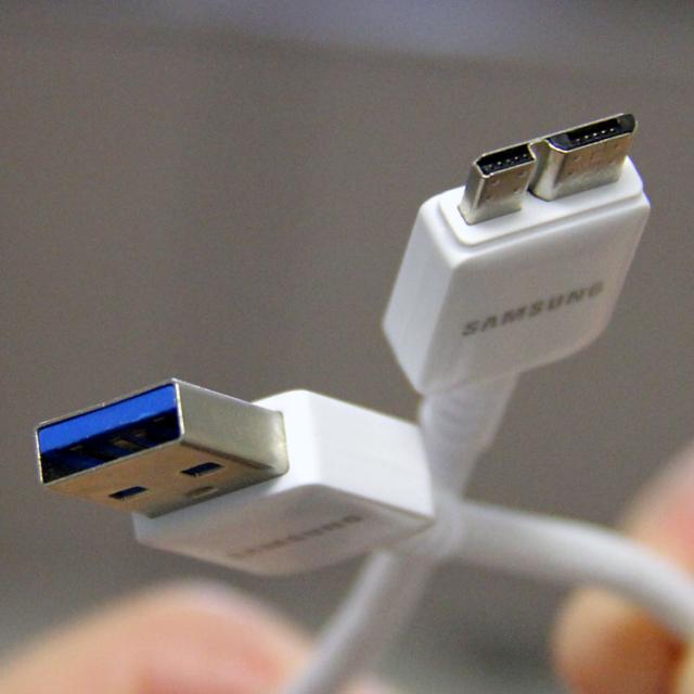

Well, I looked into the difference between USB 2 and USB 3 cables "just in case". As it turns out, the cable that ships with the S5 is a hybrid cable. It has a micro-USB3 connector on one end, and a USB 2 connector on the other end. I'll bet a lot of owners don't know that. A USB 3 port actually has FIVE conductors in it. USB 2.0 and older versions have FOUR.
Now, the confusing thing is that you can plug a 2 cable into a 3 port, or a 3 cable into a 2 port, and either way it will work. BUT........ you will not get the added speed provided by the USB 3 specification. To get that, you need the 5 pin { 9 pin }connector on the USB 3 port, and cable. :)

Wow... I had no clue... that's really jacked up!!!! I just checked mine and it's as you say, 4 pin... I would have never known
Wait a minute... mine has the 4 pins like the normal usb, but then also has 5 more pins in the back. so that's 9 pins all together mine has on my stock USB cable that came with the phone???

That's not an S5 cable, but appears to be another hybrid of some sort. Where did you get it? The mini USB 3.0 end of the stock S5 cable is actually "two connectors" mounted beside each other.
EDIT >> My apologies for the above statement. I was misled while looking at some online photos of USB 3.0 connections. :) Please see post # 14

Yeah its the one that came in my s5 box... looks just like your pic... look deep in the back, see if there is 5 more pins in the back just past the 4 slip-over pins

I need to apologize here, because I was misled by some pictures online. I'm sorry.
I see you are completely right! I am opening the USB3 stuff that I ordered, and at first I saw (through the unopened bag) what appeared to be only 4 connections in the larger end of the cables. Thinking I got ripped off, I then opened the box for an "extension" USB 3.0 cable I bought so as to make hooking up to this new PCIe card easier than climbing behind my tower case on the floor. It has no bag, so I got a really GOOD look into it, and discovered those added 5 pins at the deep end of the port. I then noticed them in the cables I bought. So I came here immediately because I knew I was wrong. Again, sorry for my mistake.
So........that shoots down my theory of why some folks might have not seen much improvement plugging their S5 into a USB 3.0 port. The supplied cable is indeed a USB 3.0 cable.
