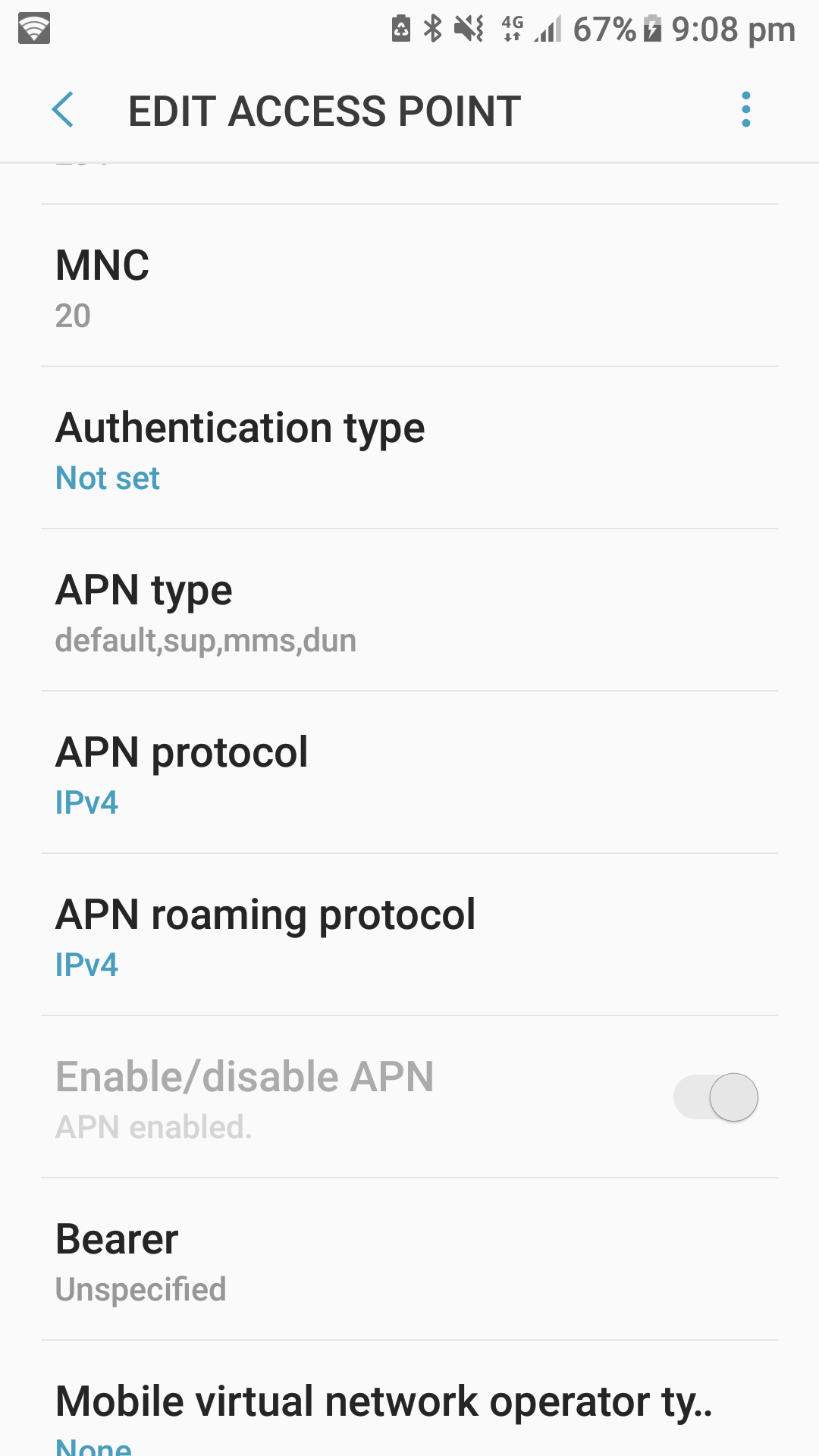

Create new apn
Name 3
Pan 3
Scroll down to apn type type
default,sup,mms,dun
Save it an boom unlimited tethering i been using it for ages no problems as soon as my 30gb tethering allowance is used i just change to this apn i created an keep tethering...
More importantly, can you tell us how you managed to "hack" your phone so that Three dont pickup the tethering?
Can you tell us the settings you did/managed so as to enjoy this tethering? A workaround will help. Also the make and model of your handset/version that you managed with !
Thanks
Create new apn
Put this in apn type default,sup,mms,dun
Click save an boom free tethering I use my 30gb allowance then switch to this apn an keep tethering
